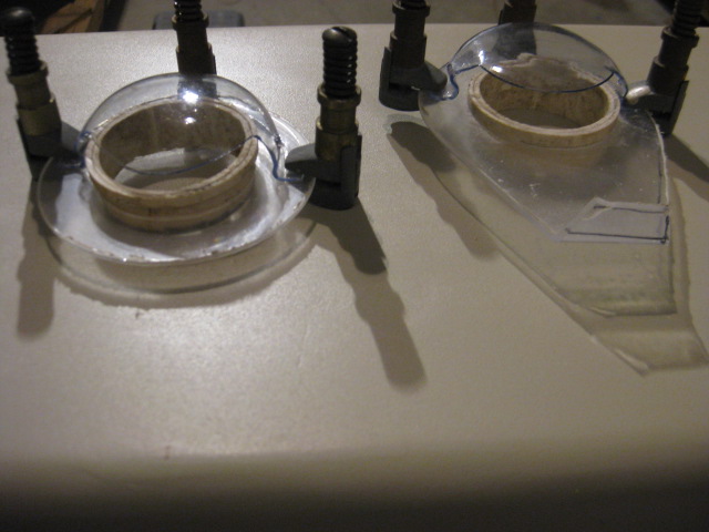

I'm working on something that may help .....
For background, my RV-10 friend said that the back seat heat blows up right behind his right shoulder while the left is cold.
I'm adapting a snap-vent from aircraft Spruce so the heat can be directed.
Here's where I'm at:
[img]cid:part1.00080509.09030107(at)cfl.rr.com[/img]
One prototype with just a round disk, one with a 'handle'.

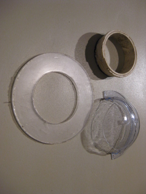

and
[img]cid:part2.09080901.01010807(at)cfl.rr.com[/img]
The tube is 2"PVC pipe that fits inside the "T" holes. the ring is a thin section of 2" pipe glued to the end ..... and no, it doesn't go all the way around.
The tube needs to be about 2" long to fit the back seat heat vents.
I used a 3 1/4" hole saw to cut a disk out of 1/16" plastic I had laying in my scrap bin.
A 1 7/8 hole saw cuts the hole for the PVC tube. Some sanding needs to be done to fit the PVC tube.
I'm planning on using the red silicone to glue the snap-vent to the plastic disk and on the PVC tube to keep it inside the vent hole.
The rear can be adjusted by the back seaters .... but the front will have to be set on the ground.
Similarly, plastic plugs can be inserted in the "T" holes with various size holes (think baby powder cap) to regulate the amount of air.
Actually, blocking off part of the hole with metal-tape would be easier .......
