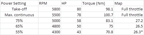

Keep in Mind, that,
Power is not always what it say on the box the engine was delivered in.
Many engines is tested without air filter, alternator, exhaust system... they can be 15% down on power when installed.
Other engines, like Rotax is tested with those items on.
Jan

Hi Jan
Good point! How do you find out how the testing is done?
Sacha

Rotax is simple, it say so, and what way it is equipped to give the stated power.
Other can be of a Cry end error method, I had contact with a guy on "Continental motor" he didn't give out to much info, or they just don't know about what real power will be installed, or don't want to tell.
Or is scared from all lawyers
IF we take old Continental they was just bare engine, with short stacks, same go for Jabirus. I know a guy that visit them when tested a Jab in the test cell.
Newer Conti have some airfilter, and short stacks, I think!
Then you lose power with density alt.
Jan
