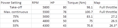

That's great info... Lowell/All, what kind of cruise characteristics (speed, rpm, fuel consumption) do you get out of it?
I am actually looking for a prop for a Kitfox IV - 80hp. Thinking Warp or Ivoprop or a wooden one by a local maker.  I'd also consider a second hand one if anyone has one they want to sell?

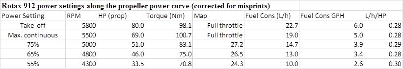

Sacha,
Most of my numbers are very preliminary. And after flying the actual test phases, it was mostly to put the required 40 hours on it and I throttled back because distance was not as important as time and I didn't want to burn more gas than was necessary. So numbers are not finalized.
I was getting about 100 mph at 5000 RPM. During the test phase in probably 85-90 degree days, climb was very close to 1000 fpm. The 1300 I mentioned was at a temp in the high 50s to low 60s. As I do the longer cross country flights fuel burn will be more apparent. I chose the 68" prop because that is what was recommended by the guys I knew that have been running the Warp prop.
One issue I did have with the Warp Prop is that one blade would change pitch one degree after running for a short while. I would re-pitch it and it would change the one degree again. I contacted Warp and this is there explanation. The aluminum collar is placed in the mold and the resin and fabric are the inserted and cured under pressure. Occasionally the resin will shrink away from the aluminum collar. He explained that is the reason for the holes drilled through the collar at 180°. The resin is supposed to run into the holes and act as a pinning mechanism. Apparently this was not working on my prop and he suggested I pin with aluminum pins.
I drilled two 3/16" holes through the collar and into the hub about 3/8" deep. and about an inch from the hub end. I cut two pins of 3/16" aluminum and glued them in the holes with a structural adhesive. I have to say here that this is what I did as I forgot to ask him for the factory recommended procedure. If anyone else is having this problem, I would suggest calling for the exact recommendations.
Lowell

Lowell,
Thanks for the detailed info!
I’m also leaning towards a 3-blade 68”.  I know this is very different from a wooden fixed pitch prop, but I’m wondering whether I should spend the extra money and get an in-flight adjustable pitch since I plan to be doing some cruising around with the plane once I get comfortable with it.  If anyone has any insight/experience there, I’d appreciate hearing it.
Sacha

PostPosted: Sat Mar 16, 2013 4:08 am    Post subject: Warpdrive ! Scotty! Reply with quote
Hi Jim, Lowell, Stan et al,
I’ve been learning a lot in this conversation, thanks for your inputs.
Today I woke up early and decided to go and read the read up the Rotax
documentation.... Here is what I found:
- Rotax service letter SL-912-016 / SL-914-014 (search for the
later on ROAN as if you search for the former it does not appear for some
reason) is entitled “Essential Information Regarding Engine behavior,
Performance and Manifold Pressure Data for Rotax 912 and 914 Series”.
Section 3.1.4 specifies that a MAP gauge *must* be fitted when using an in
flight adjustable prop. Presumably so that one does not load the engine
excessively with RPM too low.
- The Operators manual (Ed 3, Rev. 0, September 01/2012) has a
table on page 5-3 of recommended RPM/MAP settings for the 912 engines with
variable pitch propellers which I’ve reproduced here:
Power Setting
RPM
HP
Torque (Nm)
Map
Take-off
5800
80
98.1
Full throttle
Max. continuous
5500
78
100.7
Full throttle
75%
5000
58
83.1
27.2
65%
4800
50
75.0
26.5
55%
4300
43
70.8
26.3*
- * It looks like the MAP of 26.3 for 4300 RPM is wrong in the
above table. If I check the graph in Fig. 2 on page 5-2, for 4300 RPM I read
off 24.3, so I guess there’s a misprint there. The other numbers look ok and
appear to make sense.
- In my case, I don’t have space for a MAP gauge on my panel, but I
already have a Floscan fuel monitor/gauge. I’m wondering if that could be
substituted for the MAP gauge? After all, fuel burn tells me how much
energy I’m feeding into the engine, so it should be very closely correlated
to power developed. And my fuel return line goes back to the gascolator
(downstream of the fuel flow sensor), so the fuel slow sensor should be
measuring net fuel consumption. I’m just not sure how accurate/responsive
it is to changes. Anyway, I’ve used the fuel consumption (Fig 2 on page
5-2) of the Operators manual and derived the following table (where I’ve
also corrected the misprint I mentioned above). Here, I’ve reported the

Table derived from the 912 Rotax Operators Manual (p. 5-2 & 5-3) showing
power settings, RPM, Torque, MAP and fuel consumption along the propeller
power curve (corrected for misprints)
Power Setting
RPM
HP (prop)
Torque (Nm)
Map
Fuel Cons (L/h)
Fuel Cons GPH
L/h/HP
Take-off
5800
80.0
98.1
Full throttle
22.7
6.0
0.28
Max. continuous
5500
69.0
100.7
Full throttle
19.0
5.0
0.28
75%
5000
51.0
83.1
27.2
14.7
3.9
0.29
65%
4800
46.0
75.0
26.5
13.0
3.4
0.28
55%
4300
33.5
70.8
24.3
10.0
2.6
0.30
The fuel consumption numbers appear to make sense and to be similar to
what e.g. Stan was reporting.

I’ve been learning a lot in this conversation, thanks for your inputs. Today I woke up early and decided to go and read up the Rotax documentation.... Here is what I found:
- Rotax service letter SL-912-016 / SL-914-014 (search for the later on ROAN as if you search for the former it does not appear for some reason) is entitled “Essential Information Regarding Engine behavior, Performance and Manifold Pressure Data for Rotax 912 and 914 Series”. Section 3.1.4 specifies that a MAP gauge *must* be fitted when using an in flight adjustable prop. Presumably so that one does not load the engine excessively with RPM too low.
- The Operators manual (Ed 3, Rev. 0, September 01/2012) has a table on page 5-3 of recommended RPM/MAP settings for the 912 engines with variable pitch propellers which I’ve reproduced here:
[img]cid:344354A368B44E6F8AEBBBA4CEF1BF0B(at)LowellPC[/img]
* It looks like the MAP of 26.3 for 4300 RPM is wrong in the above table. If I check the graph in Fig. 2 on page 5-2, for 4300 RPM I read off 24.3, so I guess there’s a misprint there. The other numbers look ok and appear to make sense.
- In my case, I don’t have space for a MAP gauge on my panel, but I already have a Floscan fuel monitor/gauge. I’m wondering if that could be substituted for the MAP gauge? After all, fuel burn tells me how much energy I’m feeding into the engine, so it should be very closely correlated to power developed. And my fuel return line goes back to the gascolator (downstream of the fuel flow sensor), so the fuel slow sensor should be measuring net fuel consumption. I’m just not sure how accurate/responsive it is to changes. Anyway, I’ve used the fuel consumption (Fig 2 on page 5-2) of the Operators manual and derived the following table. Here, I’ve reported the power requirement of the propeller rather than the max engine output, since the former is what is almost perfectly proportional to fuel flow, as can be verified by the fact that the last column (giving fuel consumption in L/h per HP developed) is almost constant. Data is from pages 5-2 & 5-3 of the operator manual (corrected for the misprint I mentioned above)
[img]cid:EE6165BB5790455F87609D64C89B6F4E(at)LowellPC[/img]
The fuel consumption numbers appear to make sense and to be similar to what e.g. Stan was reporting.
Sacha
