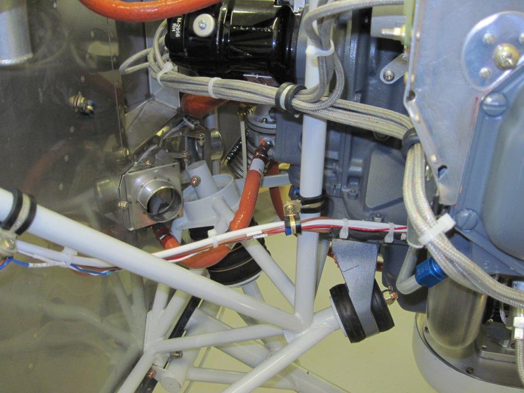

PostPosted: Tue Feb 26, 2013 7:22 pm    Post subject: Re: Fuel Lines Reply with quote
Rick,
Here is how it looks coming out of the firewall to the pump
 Filesize:  105.88 KB
 Viewed:  5933 Time(s)
Bill

PostPosted: Wed Feb 27, 2013 5:54 pm    Post subject: Fuel Lines Reply with quote
Aha, thx.  I got to Aircraft Spruce (at) CYFD yesterday and switched the fitting I had for the 45 degree one.  Glad I did by the looks of your photo.
So the fuel route is fuel pump, transducer, distribution spyder, cylinders?  Not sure thats correct?
Rick

PostPosted: Wed Feb 27, 2013 6:01 pm    Post subject: Re: Fuel Lines Reply with quote
Rick,
The routing is
engine driven fuel pump--fuel servo--FF transducer--spider--cylinders
Bill
WA0SYV

PostPosted: Wed Feb 27, 2013 6:14 pm    Post subject: Fuel Lines Reply with quote
firewall, fuel pump, servo, distributor, injectors. You can insert the transducer either between the pump and servo, or between the servo and the distributor. EI, who makes the transducer has it between the pump and the servo on their STC for certified planes, but several folks here have had success between servo and distributor, which is normal location for Continental fuel injection with fuel return line, that Bendix FI does not have.
