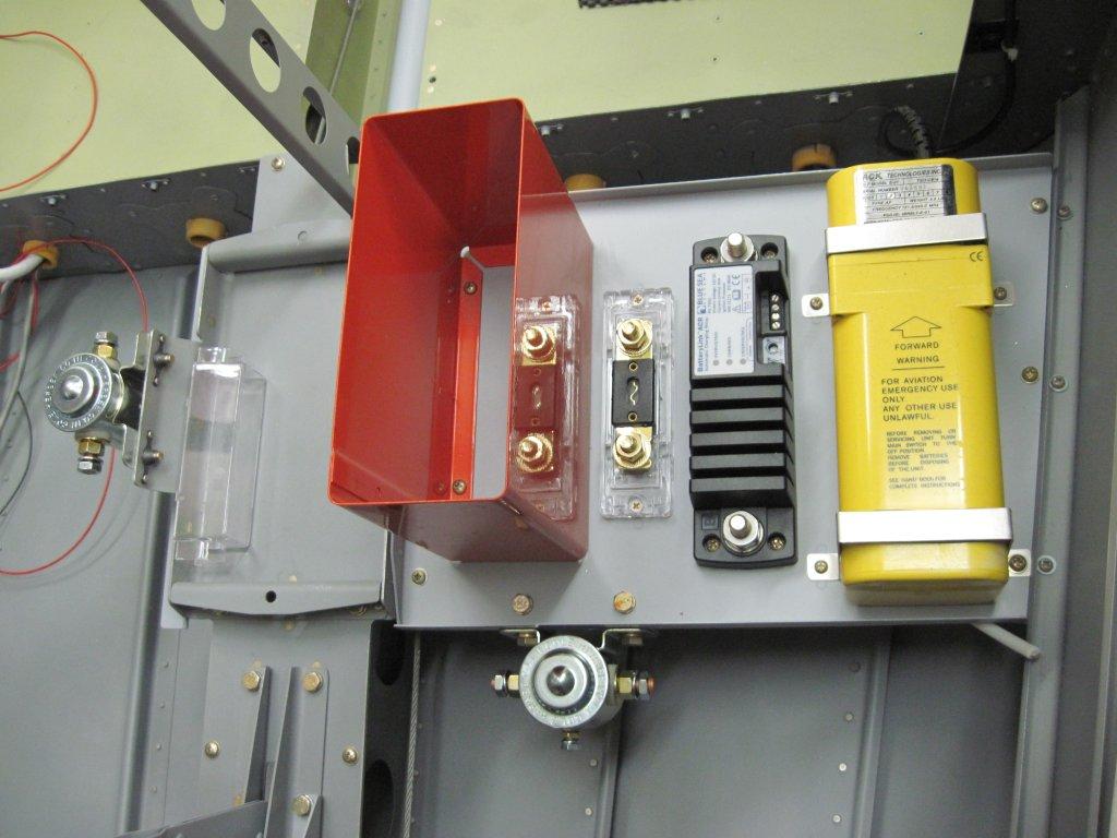

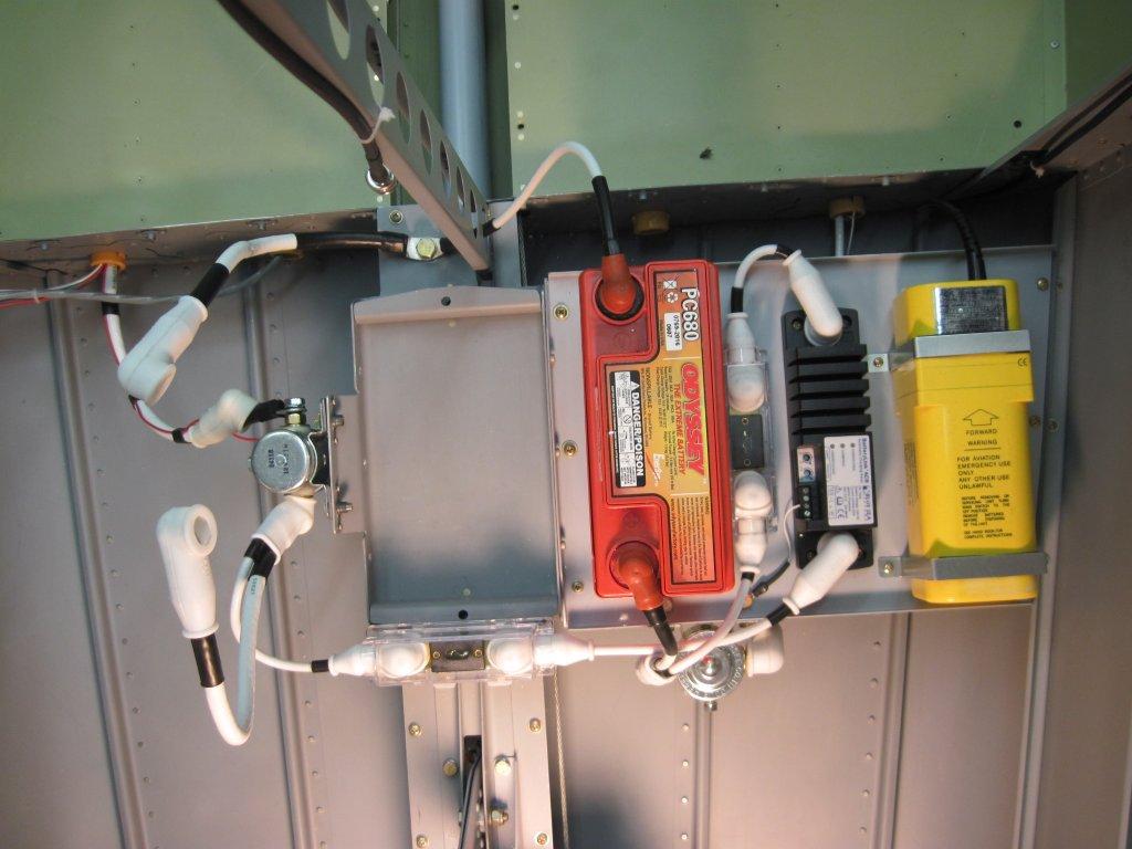

Here is our set up. The PC925 fits perfect in the existing Vans designed tray. I have no CG issues. I have the Hartzell 2 blade prop, which helps keep it forward.
 Filesize:  88.52 KB
 Viewed:  10346 Time(s)
 Filesize:  97.62 KB
 Viewed:  10289 Time(s)
Bill
WA0SYV
Aviation Partners, LLC

Nice setup Bill, do you have any photos of your tray construction and supports for the battery and accessories?

The 925L polarity is correct for the installation. Sorry, I don't have any other photos of the tray. Sad. The PC680 tray was purchased from ACS.

Bill, how did you support the additional tray both under and toward the f1047 rib?

That side of the tray has a stiffener that slides under the rib to reinforce the rib. I used 3 #8 hardware to attach to the rib. It's very solid.
