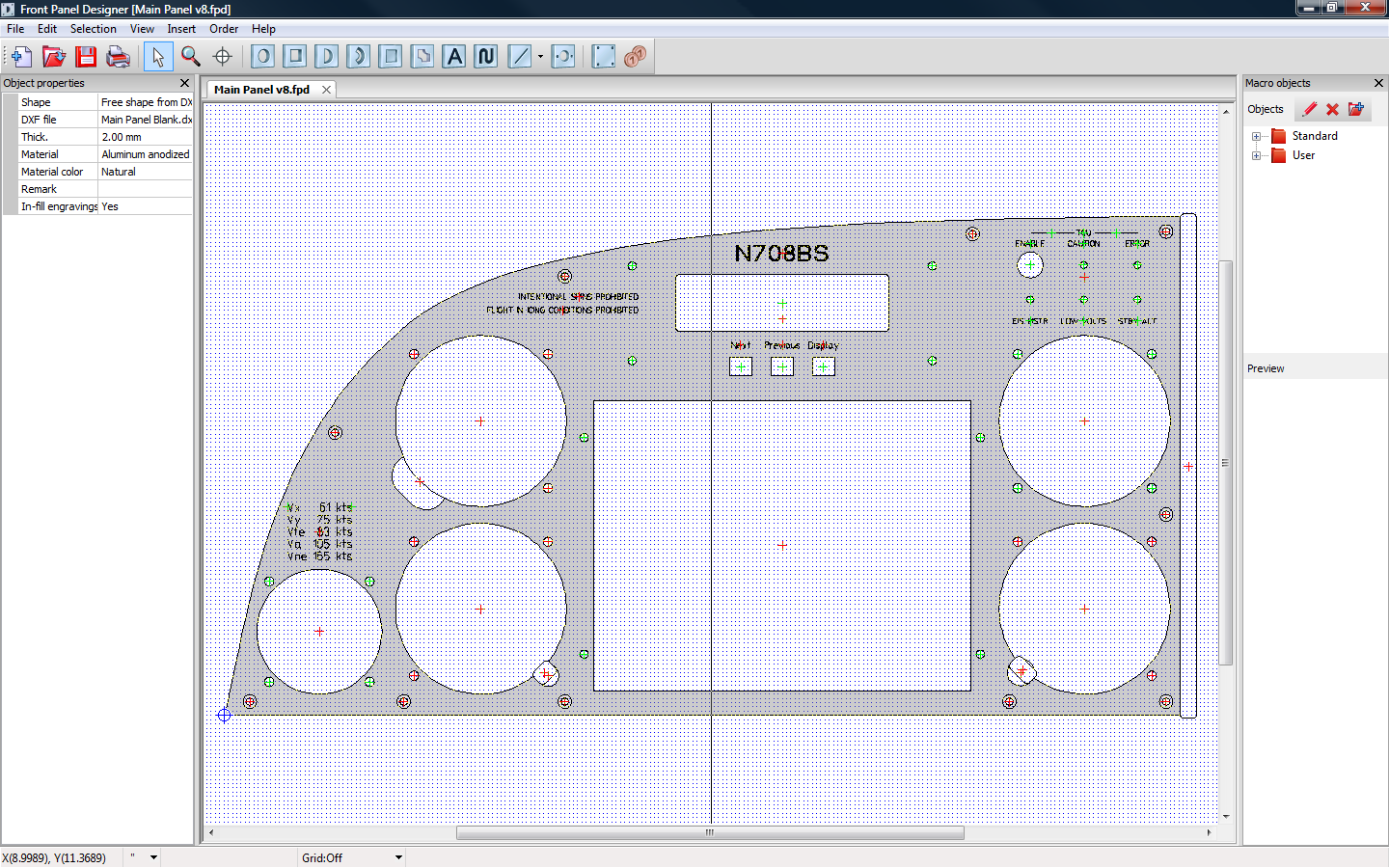

I used Front Panel Express (www.frontpanelexpress.com). They have a design program that is easy to use or will take CAD files as input. You can then price out the panel and order right from the program. My main panel was about $125 USD but a lot of that came from the engraved written on the panel. The program breaks down all the costs so you can add and remove what you need to keep the cost in line. You can also pick the material and thickness. I attached a picture of my panel in the program so you can get an idea. If you want any of my design files to use as a starting port, let me know.
Brad
