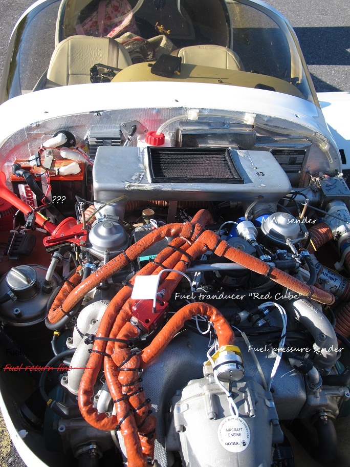

it can, if it is located AFTER a returnline
T-connection.
A fuel line after and before a transducer must be
straight about 100 mm.
I agree you, it is hard to understand how it
should work alone between the el and mec pumps (if
the return line is really open).
Look at an attachment. This set up works
perfectly - very accurate. If I read (Flight Data
Systems FC-10) I have used 47,8 liters, I will
refuel just that amount less couple of deciliters
(I have adjusted a K-factor such a way that it is
a bit on a safer side).
BTW I calibrated it during the several flights
with Kim Prout when he was he last spring.
Cheers and see you,
Raimo
OH-XRT
