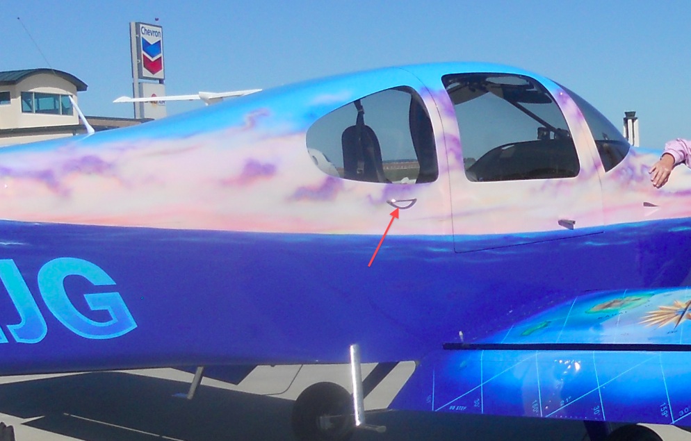

PostPosted: Tue Feb 19, 2013 5:49 am    Post subject: Re: Cabin Top Grab Handle Reply with quote
Absolutely. I put handles on both sides, right under the rear windows. The object is to let the passenger grab it before they put their foot on the step. Exiting, I find it useful for me backing off the wing.
If you go to the aviation department at Home Depot, or Lowes, you can find them labeled as drawer pulls. Get the attractive 4" one.
John

johngoodman
Joined: 18 Sep 2006
Posts: 530
Location: GA
PostPosted: Tue Feb 19, 2013 10:01 am    Post subject: Re: Cabin Top Grab Handle Reply with quote
I have yet to have anyone need a handle to climb into the -10.
Try being in your 70s and 5'4"....
You need a handle
John
