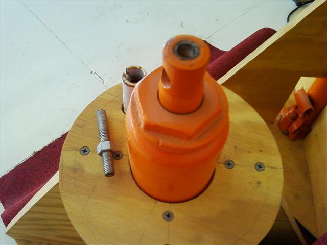

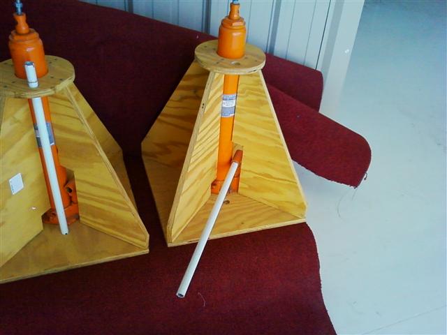

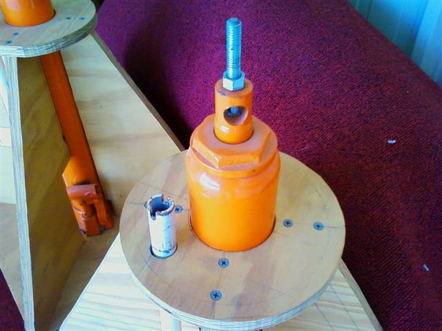

PostPosted: Thu Feb 21, 2013 4:23 pm    Post subject: Aircraft Lifting Reply with quote
I used a coupla of Harbor Freight Jacks and made some jack stands using plywood to hold them vertical. Used a short length of ready-bolt to screw into the tie down ring holes. Works well. Albert GardnerRV-10 N991RVYuma, AZ
