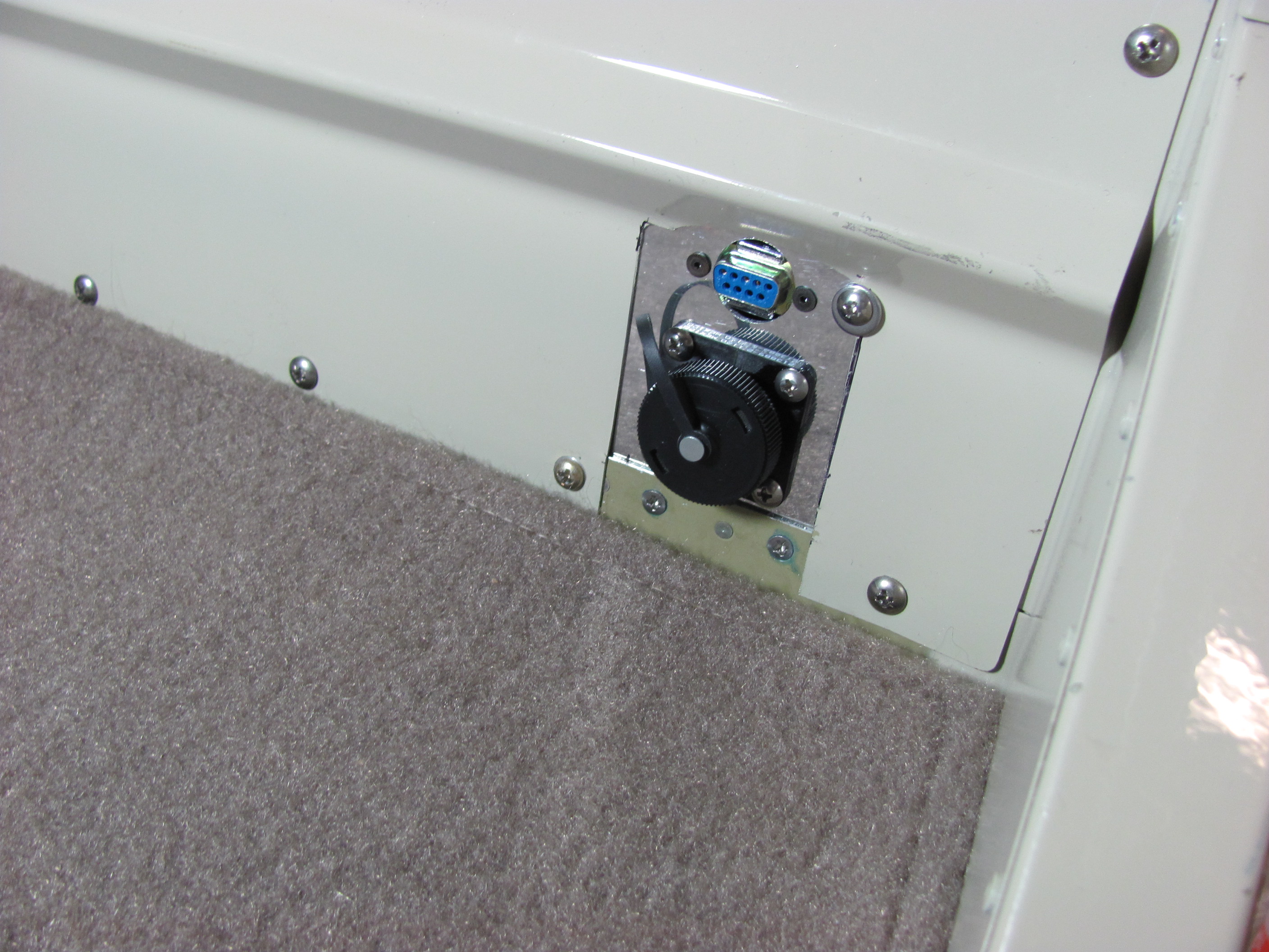

PostPosted: Tue Feb 19, 2013 9:09 am    Post subject: ground power attach Reply with quote

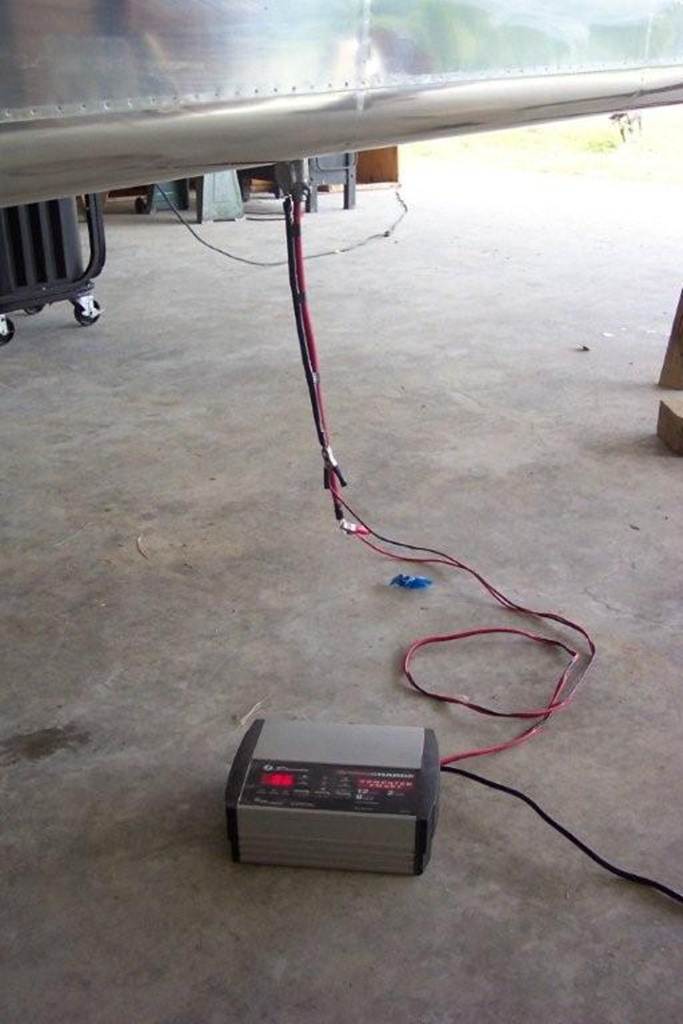

I have a AMP style connector with #10 wire going to battery and a lead set that plugs into connector in photo. It also
has #10 wire leads that can be hooked to charger or cables. I use it to charge as needed.
2 weeks ago left master on and battery was dead after 2 hours. I jumped the airplane using my connector with
leads from a car. We let it charge with the car for about 3 minutes and then jumped in and it started right up.
Worked great. I was worried with the wire size. It was designed for mainly charging. Small and compact
The DB9 connector is for ADSB programming
FWIW

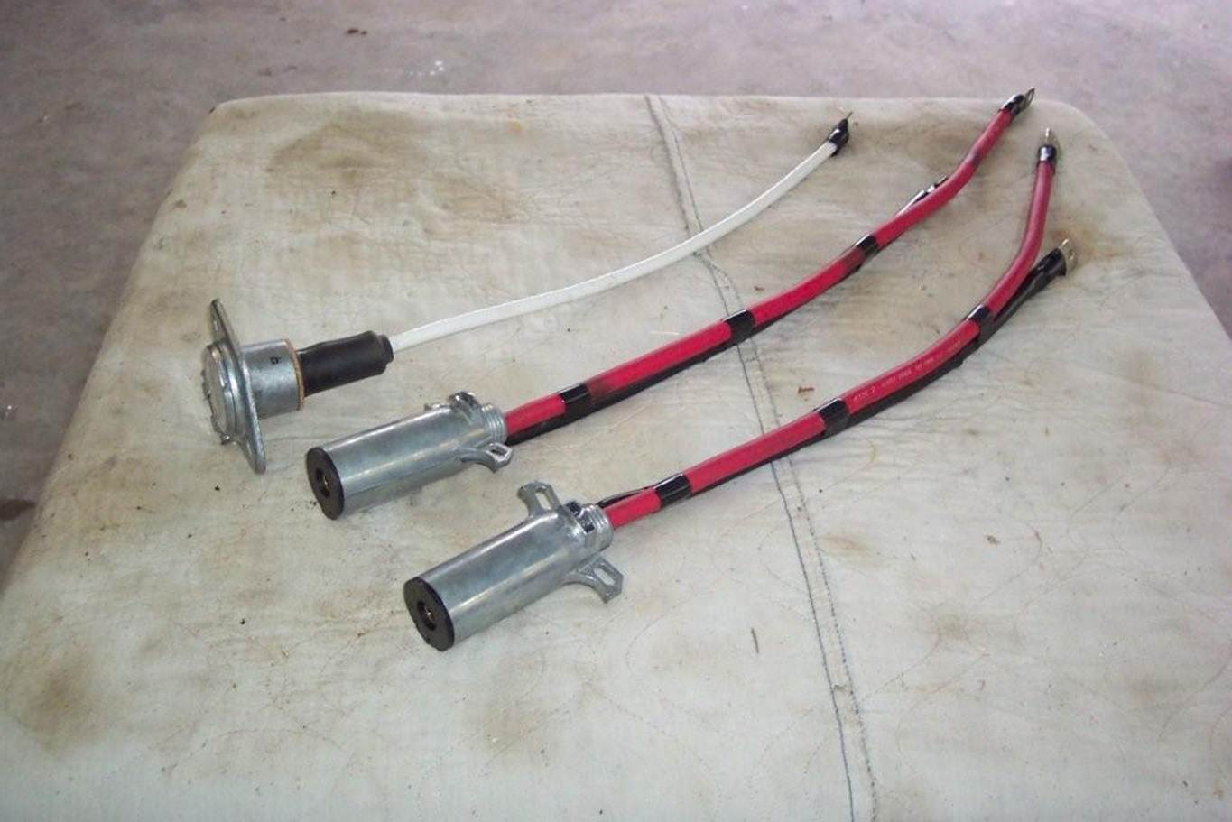

jdriggs49(at)msn.com
PostPosted: Tue Feb 19, 2013 9:38 am    Post subject: ground power attach Reply with quote
I bought the Piper receptacle from ACS and then wired the male end with welding cables that you can attach to your battery charger and or jumper cables to. Works very well for the minimal amount of money. If you want, I'll be glad to send you a picture. Email me at:  jdriggs49(at)msn.com

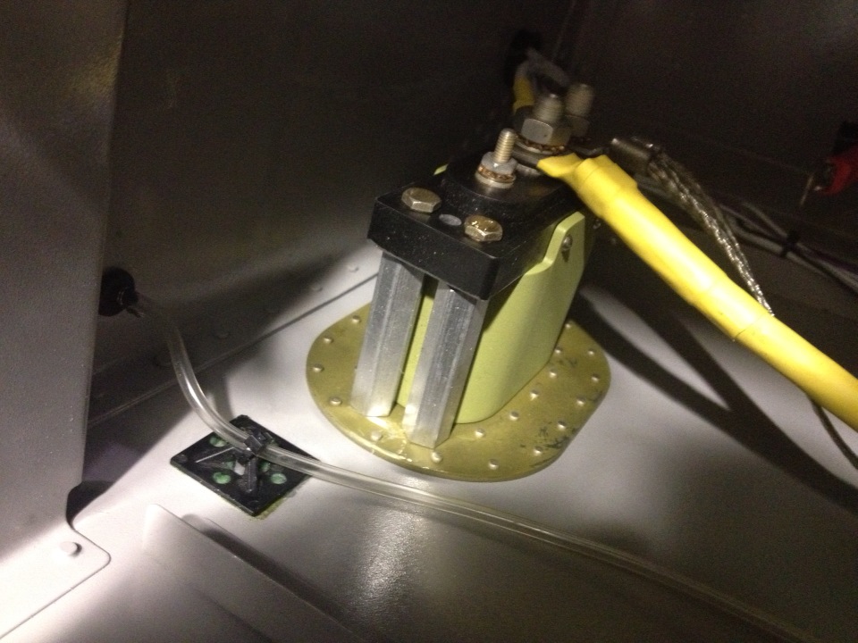

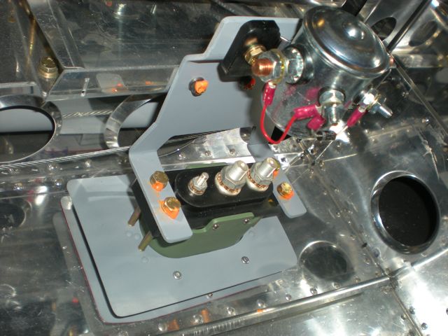

PostPosted: Tue Feb 19, 2013 10:07 am    Post subject: Re: ground power attach Reply with quote
I bought the military style from Spruce and put it on the floor next to the battery tray.
John

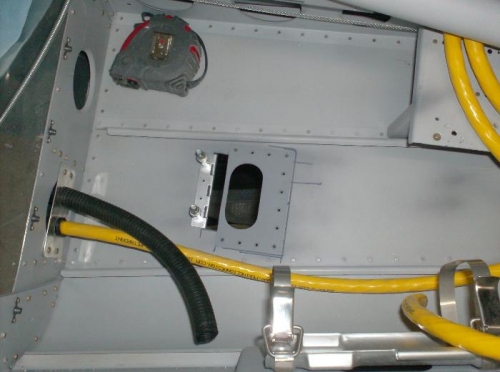

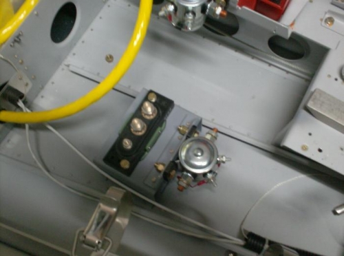

PostPosted: Tue Feb 19, 2013 12:40 pm    Post subject: Re: ground power attach Reply with quote
I also went the mil-type 3-prong connector mounted next to the battery with an access panel on the bottom of the tailcone.

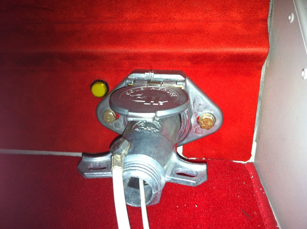

PostPosted: Tue Feb 19, 2013 1:37 pm    Post subject: Re: ground power attach Reply with quote

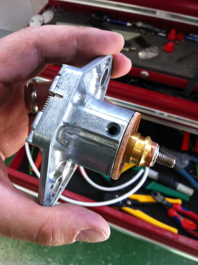

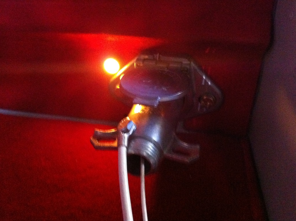

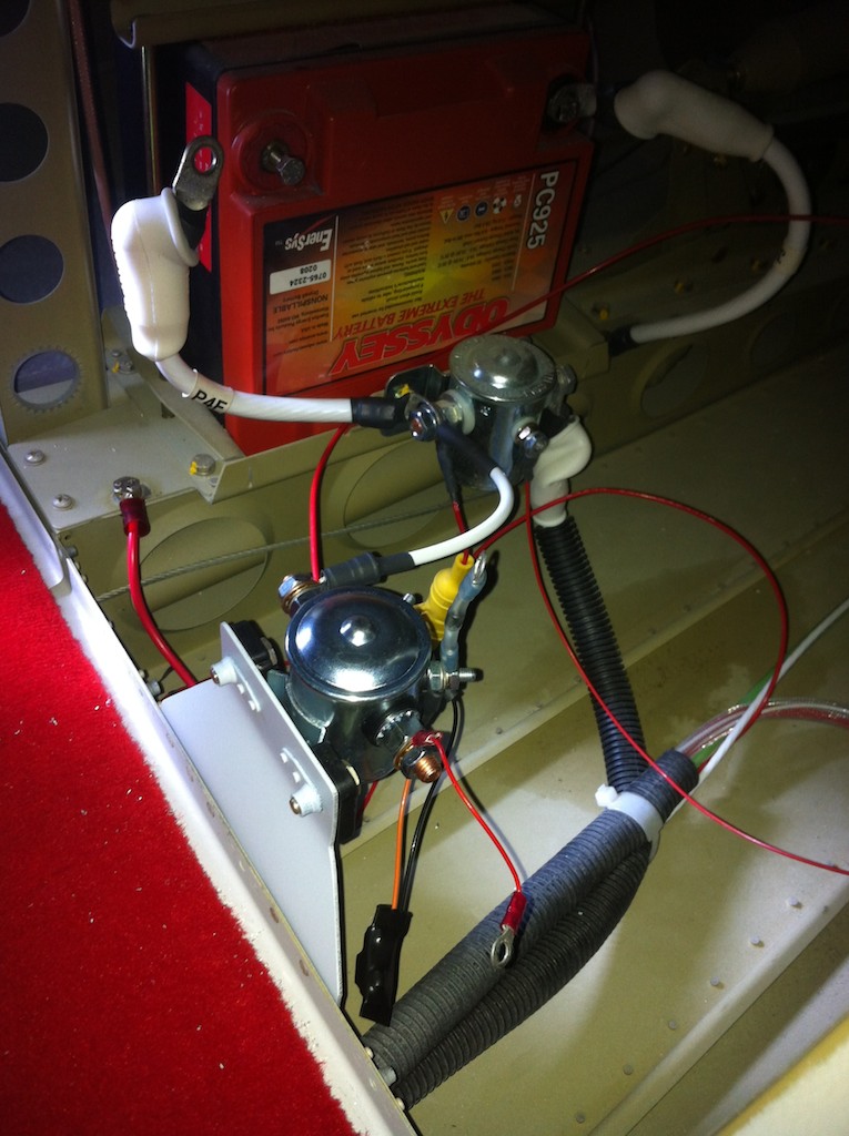

Here is my setup:
I used the setup proposed by vertical power but used a different plug.
In order to activate it I press the yellow button which lights up when active.
Here is how modified the power socket. Basically you cut off the back part and solder in a bolt to attach the #2 cable.
http://www.aeroelectric.com/articles/grndpwr.pdf
Michael

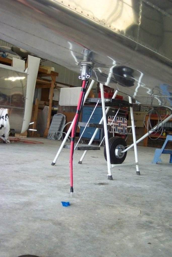

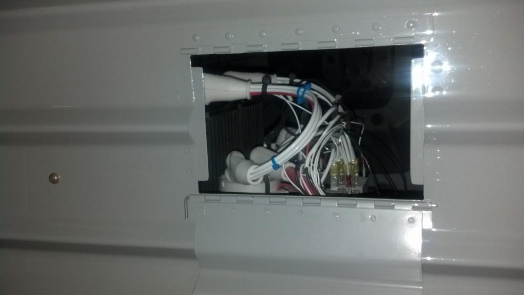

PostPosted: Tue Feb 19, 2013 2:10 pm    Post subject: ground power attach Reply with quote

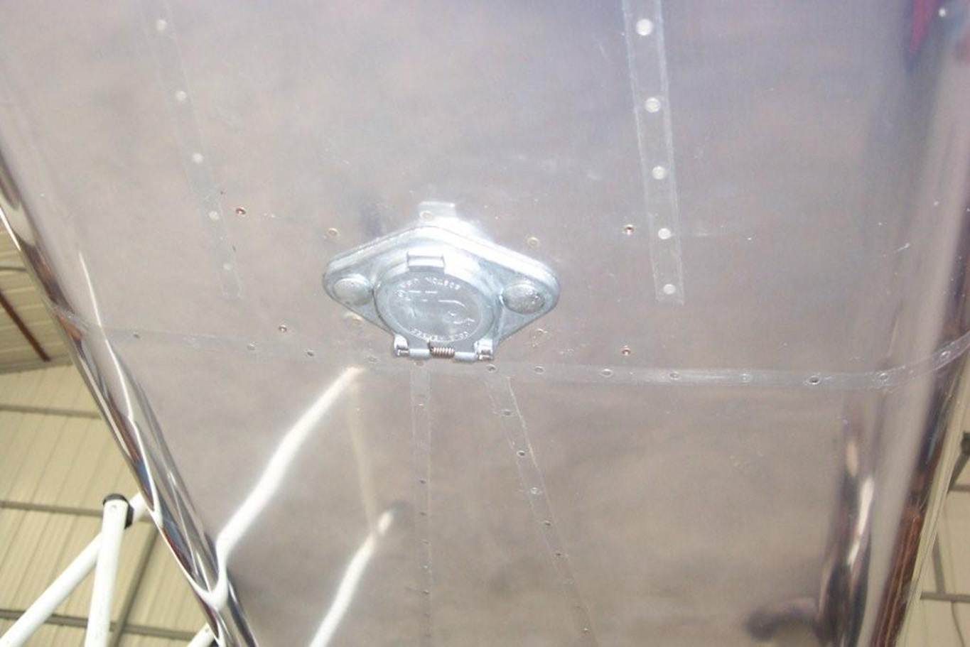

On the 8A I opted for an umbilical cord right under the belly. This is a standard Piper unit purchased through Spruce. I am embarrassed to say that I have used it many times already in my 8A's 130 TT. I chose to mount it on the belly so that I could get a jump and have someone remove it while my canopy is closed and no baggage doors or anything else open. The receptacle is not too heavy but the plugs do have some heft. I made up two sets of plugs. One I keep in the airplane and one in the hangar. We staggered the wire lengths so the leads don't touch and we kept them short of the ground for obvious reasons. We could have reduced the cable length by 2/3rds and may do so in the future. The plug is directly under the battery so there is minimal internal cabling. I have liked the set up and would do it again.
Robin

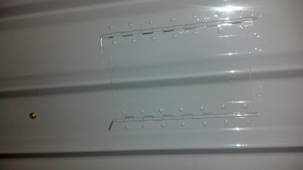

cv93436(at)windstream.net
PostPosted: Wed Feb 20, 2013 2:13 pm    Post subject: Ground Power Attach Reply with quote
Realizing it would be very inconvenient to remove the back cabin bulkhead to jump the battery, we installed a Piper-type power plug just aft of the baggage door across from the battery. We used a reinforcing plate, cut shim gaskets out of aluminum and gasket material so it lies smoothly on the outside. We sealed it with silicone. It works well and has saved several quite frustrating efforts to remove the back panel at the most inconvenient times to jump the battery.

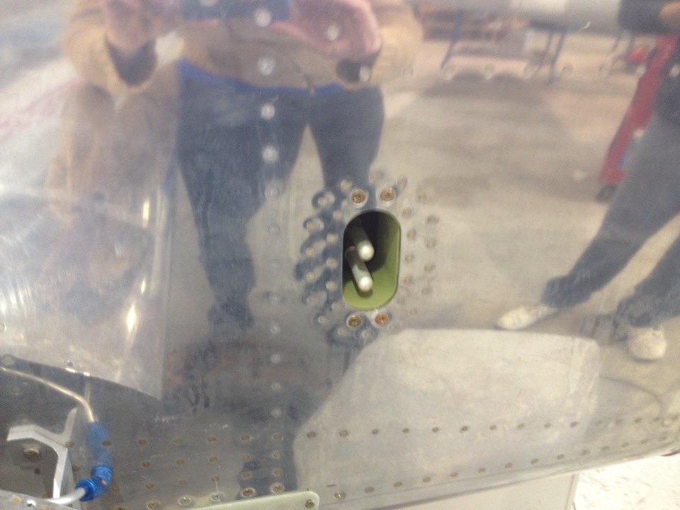

dave.saylor.aircrafters(a

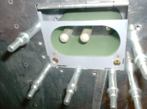

PostPosted: Wed Feb 20, 2013 3:11 pm    Post subject: ground power attach Reply with quote
Last time we installed an APU plug we made a batch of the doublers.
This is for the big AN connector. It comes ready to countersink and
attach. You just use the doubler for a template.
We're going to put this on the web site for sale but I thought I'd
mention it here first. It works really well. Comes with the heavy
duty doubler plate, hex stand-offs, and fiberglass push-on cover.
I like the APU plug forward of the left door so you can see if it's
plugged in before you taxi away.
Price is $100 plus shipping for the doubler, standoffs, and fiberglass cover.

I took the easy way to provide access to connect a battery charger. Photos attached.
Carl

I mounted a pair of banana jacks to a bracket attached to the center support behind the aft bulkhead. They protrude forward slightly, thru a pair of small holes in the bulkhead. Attached to the battery via an in-line fuse. For charging only, not jump starting.
Bob Turner
