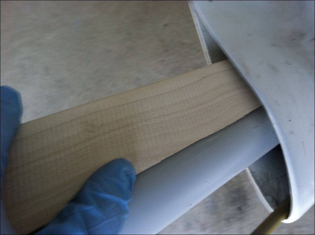

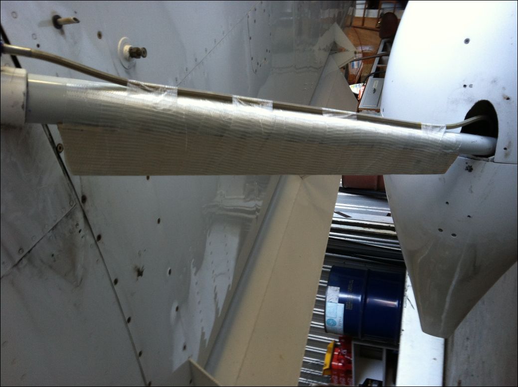

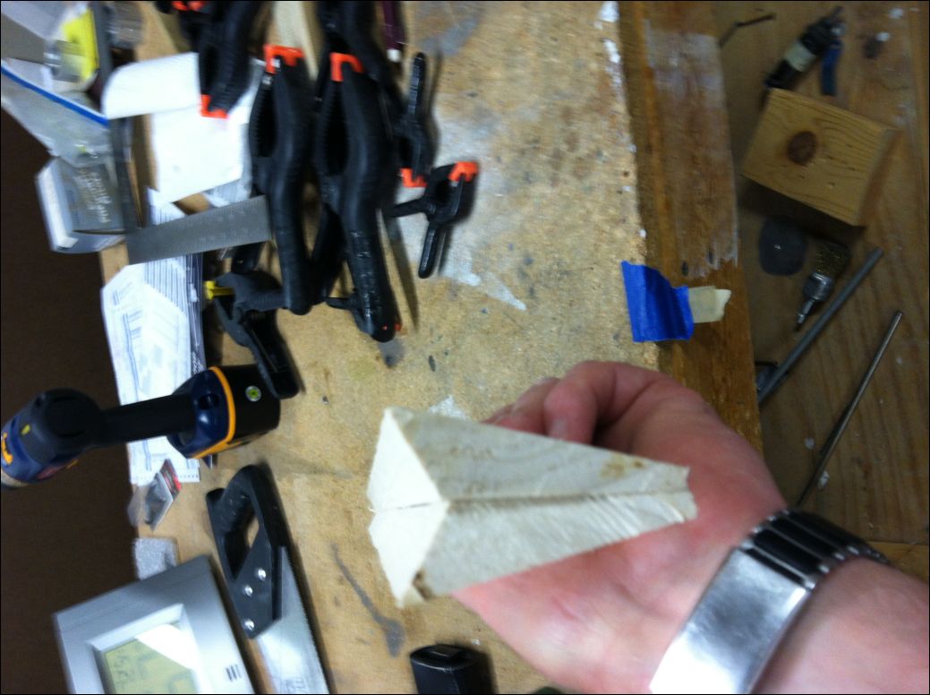

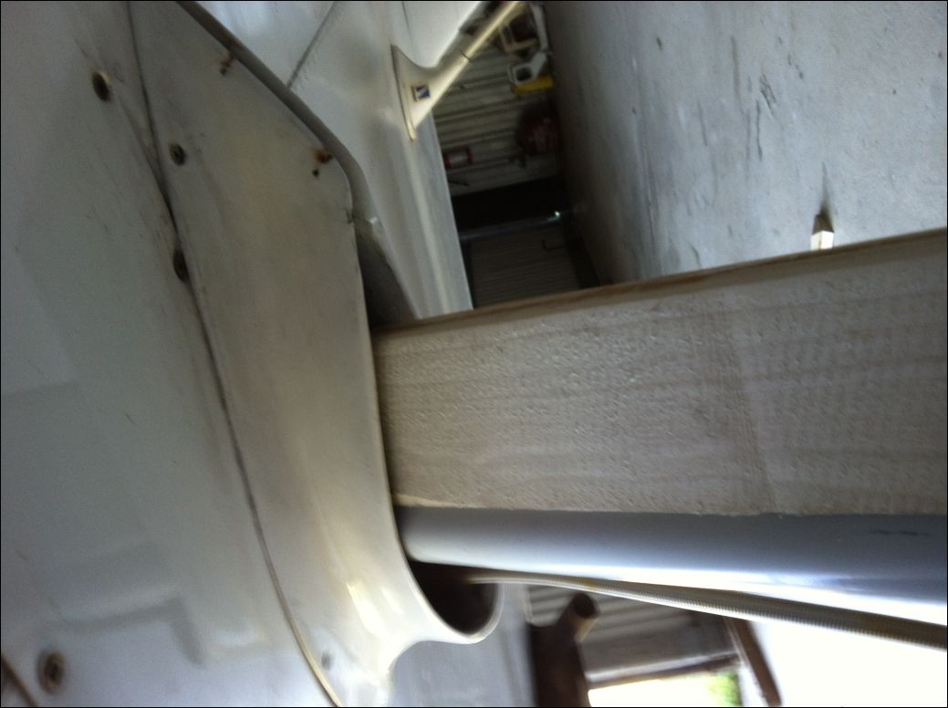

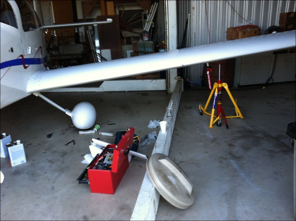

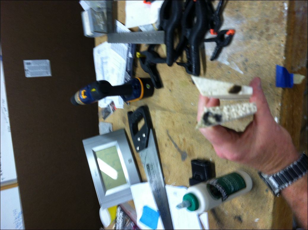

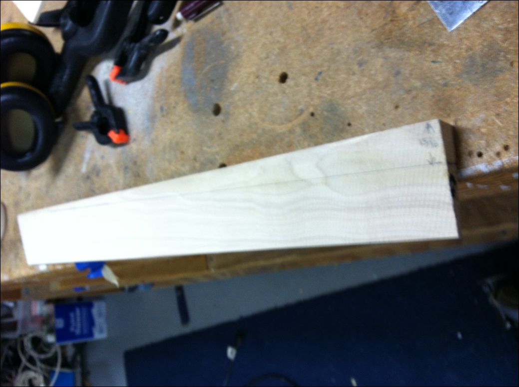

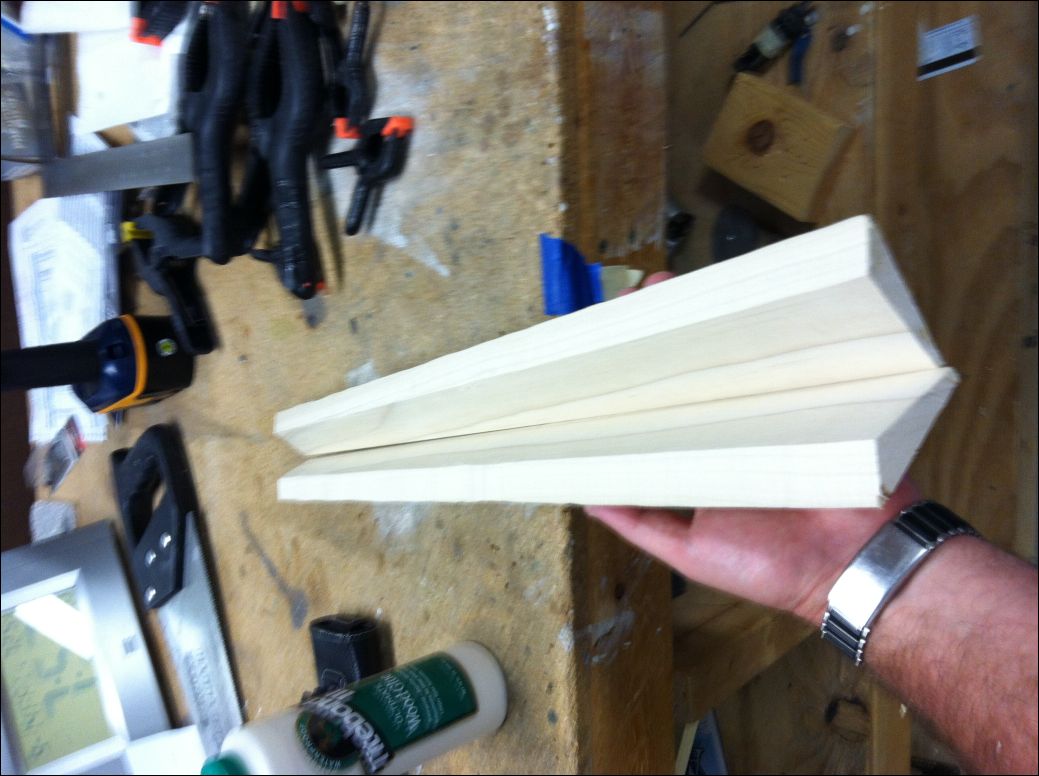

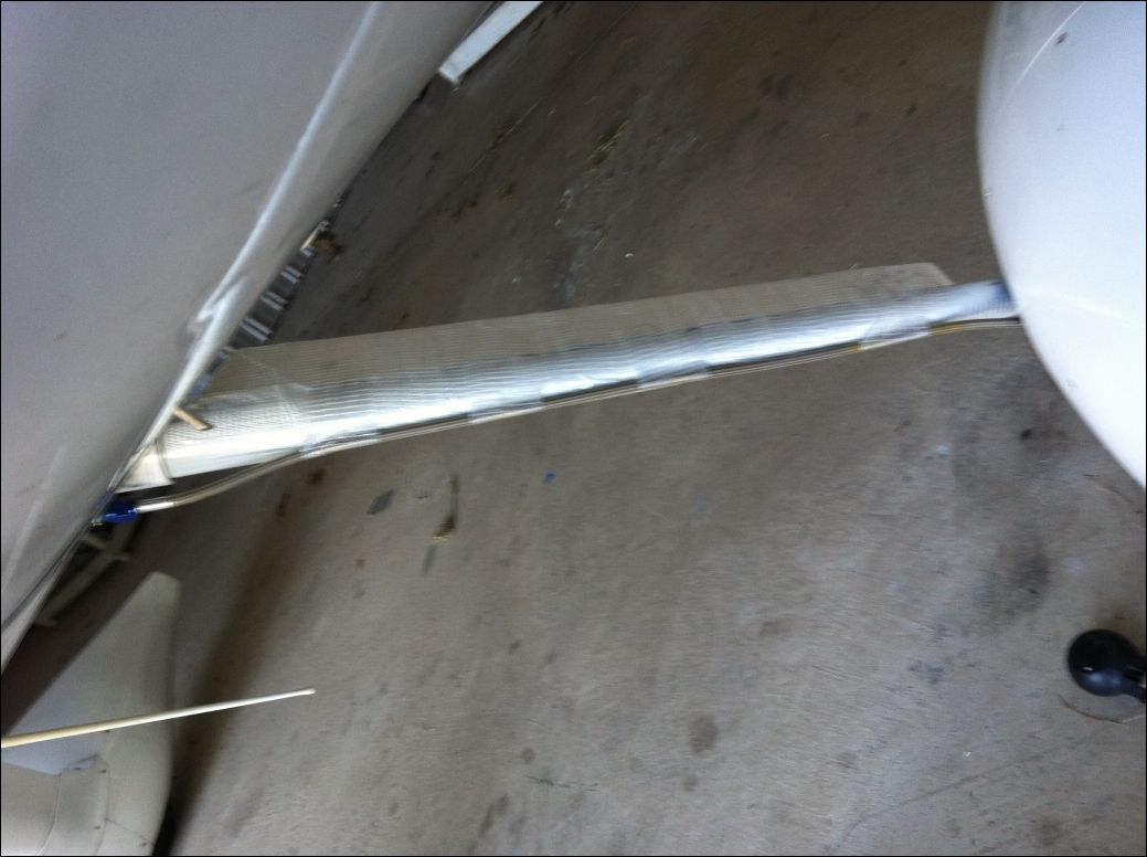

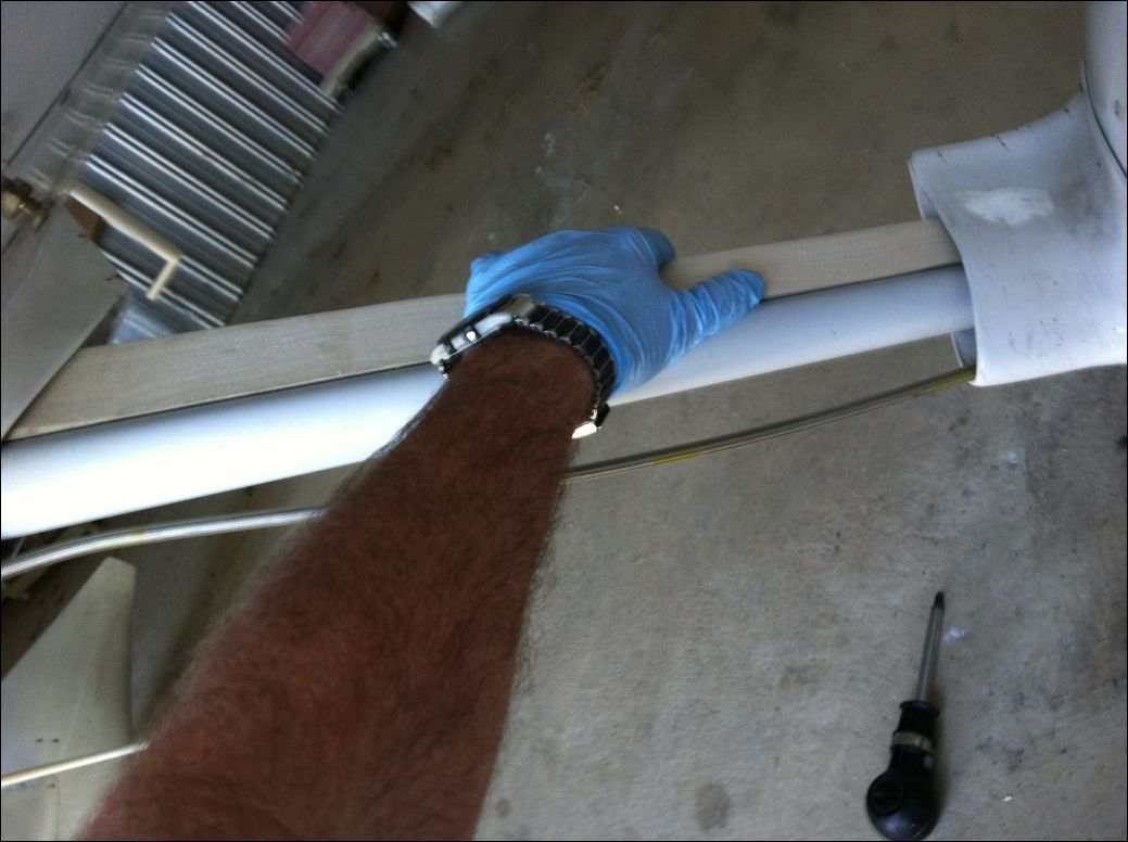

PostPosted: Mon Feb 18, 2013 6:30 am    Post subject: Gear leg stiffeners Reply with quote
Photos of shimmy damper fabrication and installation attached. I made
mine out of Fir, attached with strapping tape for now.
They made a huge improvement in landing roll out shimmy. Wheel
balancing did little to no good. Tire pressure at 39psi seems to be a
sweet spot on my plane.
Tim
Tim Lewis -- HEF (Manassas, VA)
RV-6A N47TD -- 1104 hrs - sold
RV-10 N31TD -- 350 hrs

How did you attach the fir damper to the landing gear leg?
Jim Combs (N312F Flying - And painted)
On Mon, Feb 18, 2013 at 9:29 AM, Tim Lewis <TimRVator(at)comcast.net (TimRVator(at)comcast.net)> wrote:
[quote]Photos of shimmy damper fabrication and installation attached.  I made mine out of Fir, attached with strapping tape for now.
They made a huge improvement in landing roll out shimmy.  Wheel balancing did little to no good.  Tire pressure at 39psi seems to be a sweet spot on my plane.
Tim
Bruce Johnson said the following on 2/15/2013 3:24 PM:
Does anybody have a picture handy of the wood stiffeners I have heard about?? I have got 87 hrs on 151BJ and have never had a problem until today. Full fuel, two 200lb guys and wow what a shake. I dropped my passenger and still had a shake and then landed without one. Took off again and it was just a minute shake, landed with none. Weird after all these take offs and landings for it to start now. I am going to pull the fairings off and check for other things, but while I am at it I might put the stiffeners on. Thanks in advance
Bruce Johnson
PostPosted: Mon Feb 18, 2013 5:05 pm    Post subject: Gear leg stiffeners Reply with quote
Attached is the RV-6 plans section on shimmy dampers for reference, and
a page of notes that I used in making my RV-10 dampers.
As I recall, here was my process for making a single shimmy damper:
- Start with 1"x2.5" fir, cut to the 12-13 degree angle depicted on my
drawing (two pieces, mirror image). Plan to end up with pieces 22" long.
- Mark a line on the leading edge that will result in the damper half
being 3/4" wide at the top, and about 1/2" wide at the bottom (my
drawing says 11/32", I think that's incorrect).
- With the band saw table tilted 30 degrees, cut along that line, such
that you have fabricated the leading edge of the shimmy damper half.
Repeat on the other shimmy damper half
- Cut the trailing edge to stay within the contour of the gear leg
fairing trailing edge.
- Glue the two halves together with good quality waterproof glue. Clamp
to dry.
- I taped mine to the landing gear with packing tape. I may fiberglass
it on in the future, as described in the RV-6 plans.
