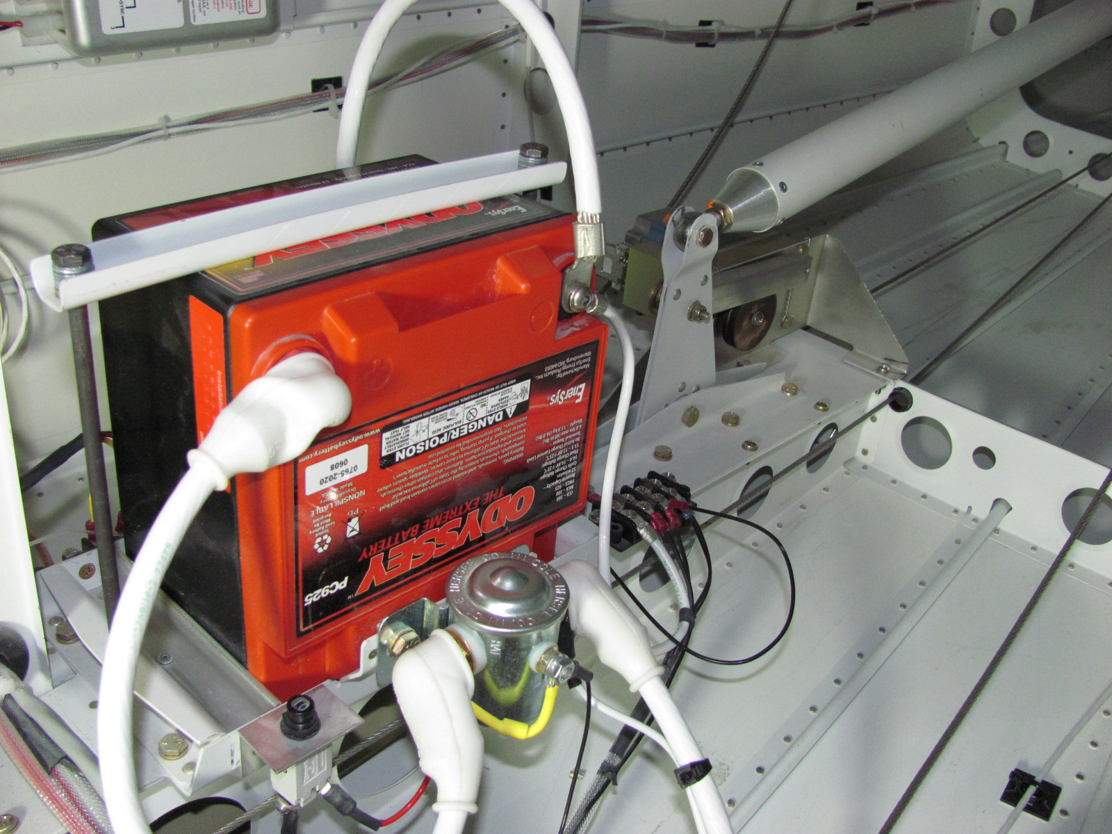

Thank you for mentioning that. It looks like the Odyssey PC925 will also fit when turned on its side. I think some builders have used it that way. Anyone have arguments for one or the other? The PC925 seems to be about the same wt, a few amp hrs more than the BC-100-1 and the RG 25XL Concorde. I'd like to have about same wt and amp hours (or more) than the Concorde which I was leaning towards. I don't feel the PC680 has enough amp hours capacity for my preferences, while it may be fine for other elect system designs.

[quote] I use the BC100-1 from B&C Specialty products.  Stand it on its side in the standard Van's try with no modification.Plenty of power.

I love my PC925. Works great on its side and still cranking.
