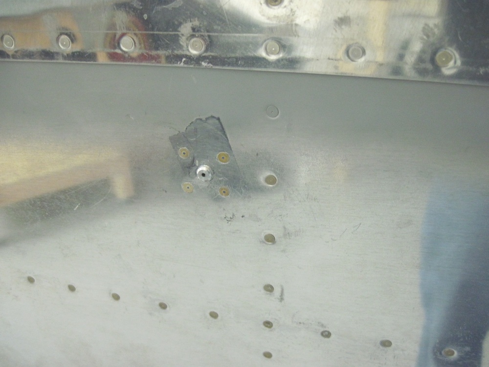

PostPosted: Mon Feb 18, 2013 4:15 am    Post subject: Re: static port Reply with quote
I used the Safeair static ports, which I purchased from Avery Tools, and have zero error on our -10. They are mounted from the inside, bonded and riveted. They have very nice threaded connections, look professional and perform well.
http://www.averytools.com/prodinfo.asp?number=4677
 Filesize:  173.52 KB
 Viewed:  5922 Time(s)
Bill
