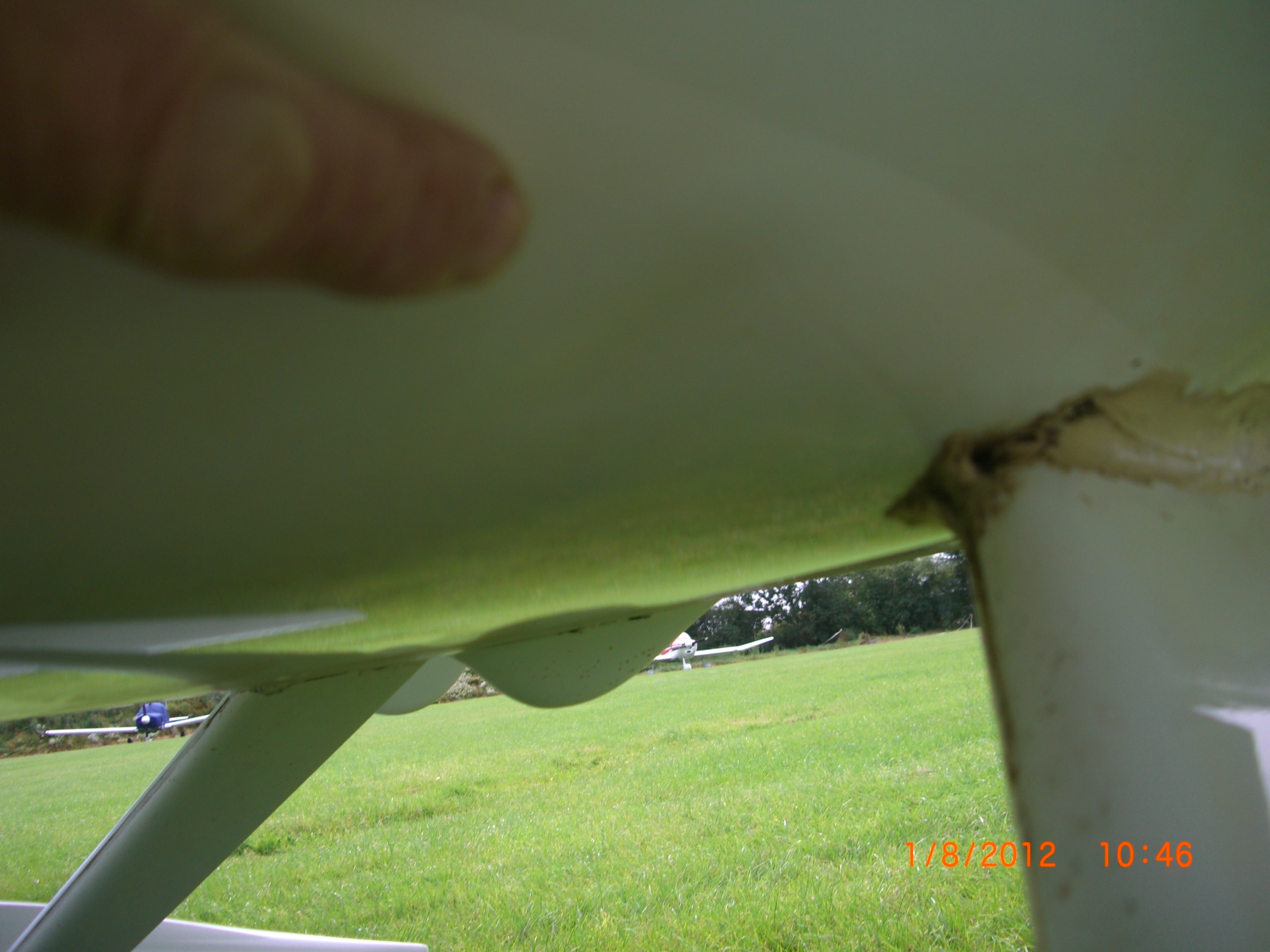

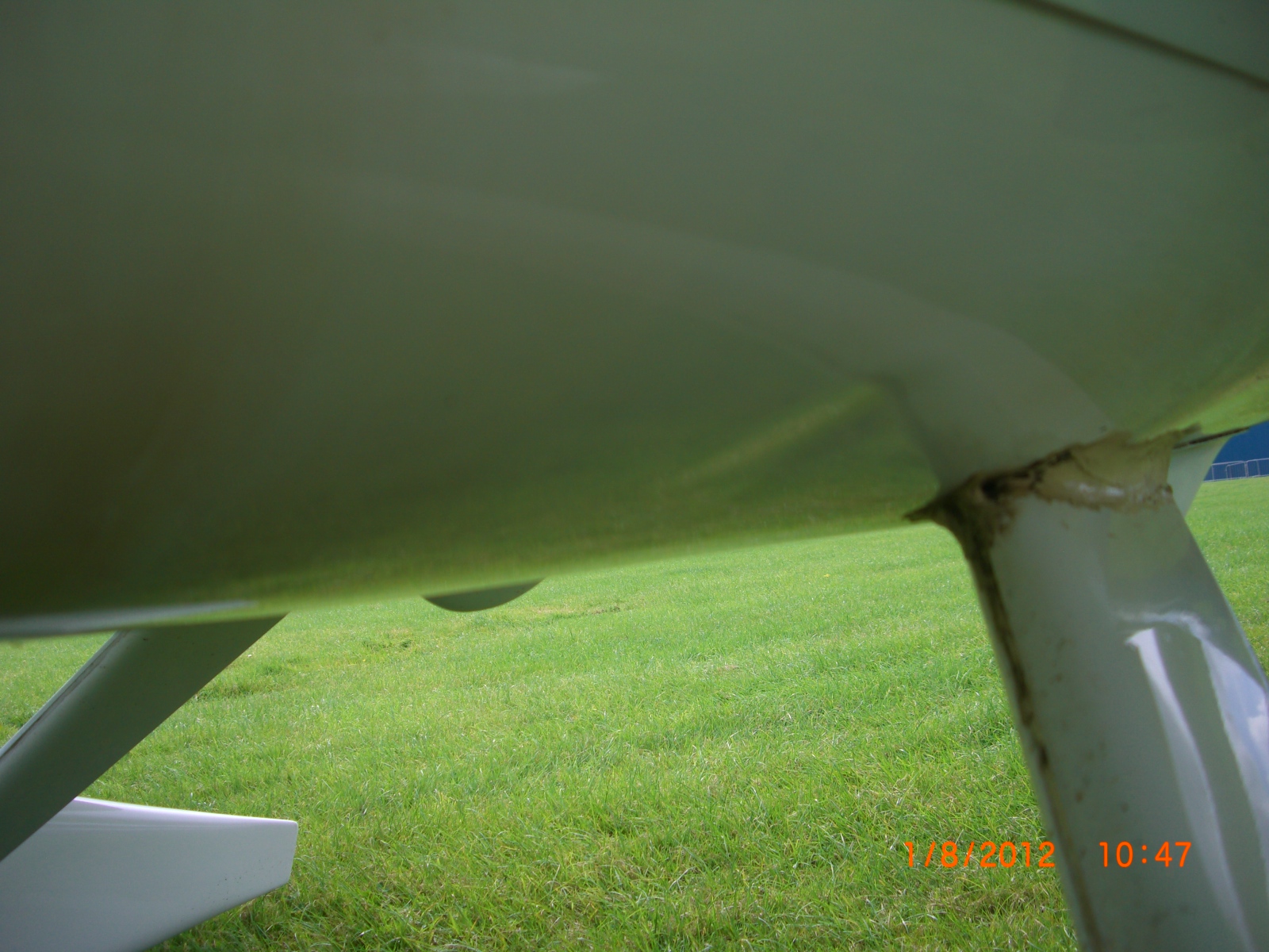

PostPosted: Mon Jul 30, 2012 4:16 pm    Post subject: Re: Heavy Landing on Tri Gear. Reply with quote
Hello Peter.
Sorry for taking so long, lost the camera/computer cable, but here are the pictures.
The hollow is about 4" in front of the main gear leg, No cracks or surface damage in the hollow. And no damage in the area all looks symmetrical.
The trouble is i can,t remember if it was there before.!!
I did have a bird strike, a Crow came up from underneath on that side, i heard a thud and thought it have been swept round and hit the tail plane on the other side,? i did not look under the aircraft at the time.
But just can,t remember if the hollow was there when i first gave the aircraft a polish.
Hope the photo,s are good enough.The sealant looks a mess in the photo but its all intact. My finger will give you some scale of size.
Alan

PostPosted: Mon Jul 30, 2012 9:43 pm    Post subject: Heavy Landing on Tri Gear. Reply with quote
Alan
Why dont you get your LAA Inspector to have a look at the ripple to be on the safe side, its really difficult to see and indeed to give any opinions from a distance is like asking your doctor to diagnose a broken leg without X Rays!.
You could also call Neil France whom I believe did the last LAA annual Inspection on your aircraft, if there was any structural issues oin the aircraft it simply would not have passed. Email me if you want a contact number?
rgds
David

pjeffers(at)talktalk.net
PostPosted: Mon Jul 30, 2012 11:59 pm    Post subject: Heavy Landing on Tri Gear. Reply with quote
Hi Alan,
Since the dent, as shown in your photo, could just have resulted from a
movement of the leg socket, I personally would want to very carefully
inspect the leg socket securing structure.
My suggestion is that you need to get a Europa experienced inspector to
check it out for you. I believe David Lloyd at Shobdon used to look after
your aircraft so in the first instance I would talk to him.
Pete

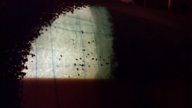

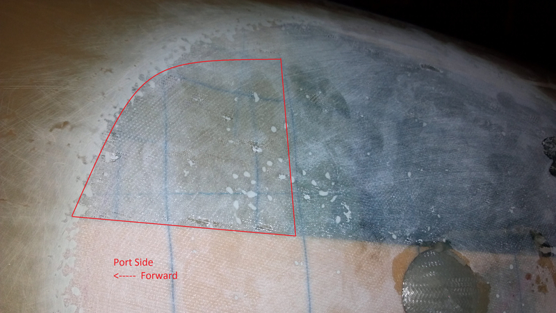

PostPosted: Mon Aug 20, 2012 7:31 am    Post subject: Re: Heavy Landing on Tri Gear. Reply with quote
After reading this post I went to my Europa, which is in the middle of a tri-gear conversion, and took some pictures of the belly in the area shown in your photos and was a little surprised. I used a light, put in the hole for the spar, and shined it down and back towards the landing gear layups. What I noticed is there is an 1/4 of an area that isn't as reinforced as the rest of the 10" circle around the LG hole.
This may be the reason for the buckle/dent in the skin. I also have not put the bottom layup on the belly yet but noticed that the skin can dent inwards with little pressure.
http://www.europaowners.org/main.php?g2_view=core.DownloadItem&g2_itemId=100701&g2_serialNumber=2
http://www.europaowners.org/main.php?g2_view=core.DownloadItem&g2_itemId=100704&g2_serialNumber=2

PostPosted: Mon Aug 20, 2012 8:48 am    Post subject: Re: Heavy Landing on Tri Gear. Reply with quote
Yeah I after seeing this I might put an extra layer of bd on the bottom.

Here it comes....
 Filesize:  1.2 MB
 Viewed:  31554 Time(s)
Alan Carter
Joined: 02 Jul 2012
Posts: 378
Location: Kent, England.
PostPosted: Thu Feb 14, 2013 1:48 pm    Post subject: Re: Heavy Landing on Tri Gear. Reply with quote
Hello Roland.
Well that,s interesting,, Having done 10000 hours instructing i had a reasonable idea of what a heavy landing was like, even then only the odd one may have slipped through where you really felt it.
My aeroplane has had two previous owner so i don,t know what sort of life it had before me, and i did not know what you would call a heavy landing in a Home built aeroplane at that time, But now having seen some Europa landings i can say i never have made a bad landing,
Don,t know if its true but SOME SAY the engine mounts will go before the undercarriage goes. Yes i love Top Gear. Clarkson for Prime Minster .
And the same as you have polished the plane all over i did not see it then, but i guess it could have been there but i don,t think so.
Since discovering it i have made many more landing without incident but the crease is still there. My plane is a Mono /Tri Conversion.
Just out of interest don,t ask me why, I find Flapless landings are much better for the plane on rough bumpy runways, need the runway lenght, and a airfield you know, well it works for me, give it a try and let me know.
Fitting clamps at the moment so the tailplane in bits.
Alan
