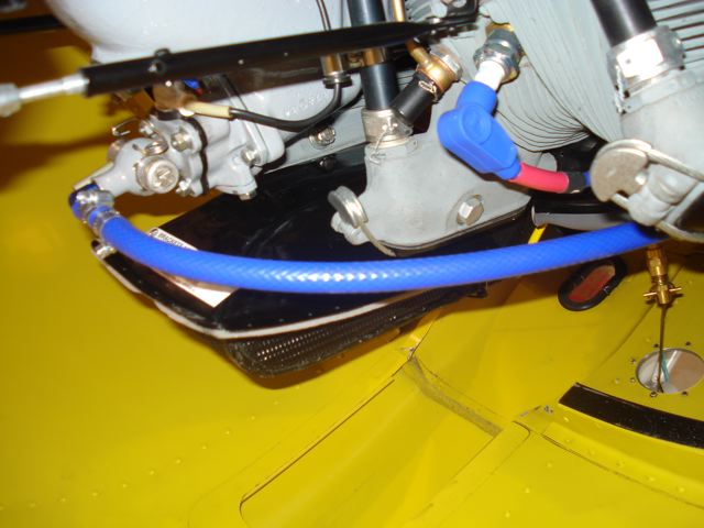

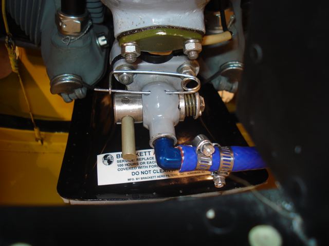

You can also put a clear PCV drain hose on the sump drain and drain it into a 5 gal. fuel can. That way any oil draining past the oil pump check valve is emptied from the sump before it overflows into the the lower most 4 cylinders. That way the minimal amount of drainage from the upper part of the cylinder can easily be cleared from the cylinders with the pull through.

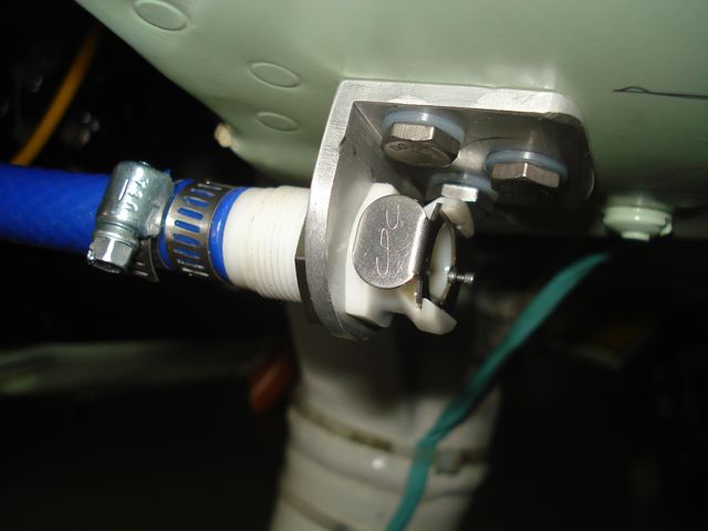

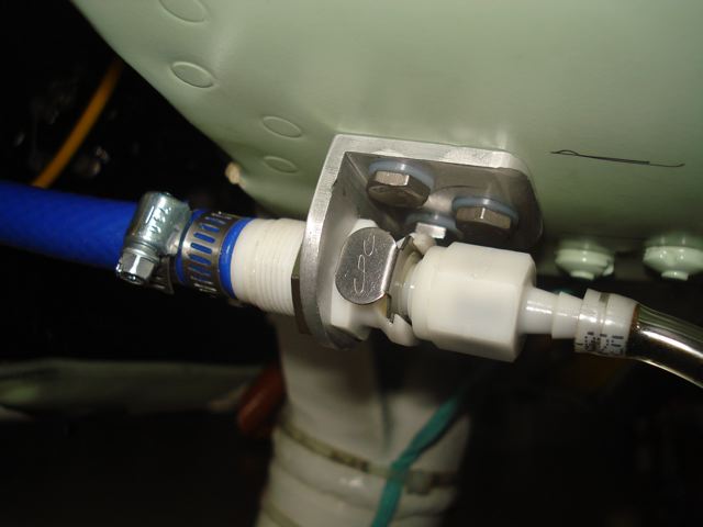

Thanks to Buddy Moman who came up with this sump drain with a quick
disconnect fuel quick disconnect valve, all one has to do when the
engine is shut down (of course) is open the sump drain, re-connect the
removable portion of the quick disconnect valve with the hose on it into
the oil drain container and the oil problem of draining into the sump
and out the exhaust stacks is basically eliminated. Keeps potential
hydraulic locks to virtually nil.
I've installed several of these and they really work. About $50 worth
of parts. Here's the quick disconnect valve.
http://www.aircraftspruce.com/catalog/appages/quickdisline.php?clickkey=26013
Doc's method does exactly the same thing and also works great.
Dennis
