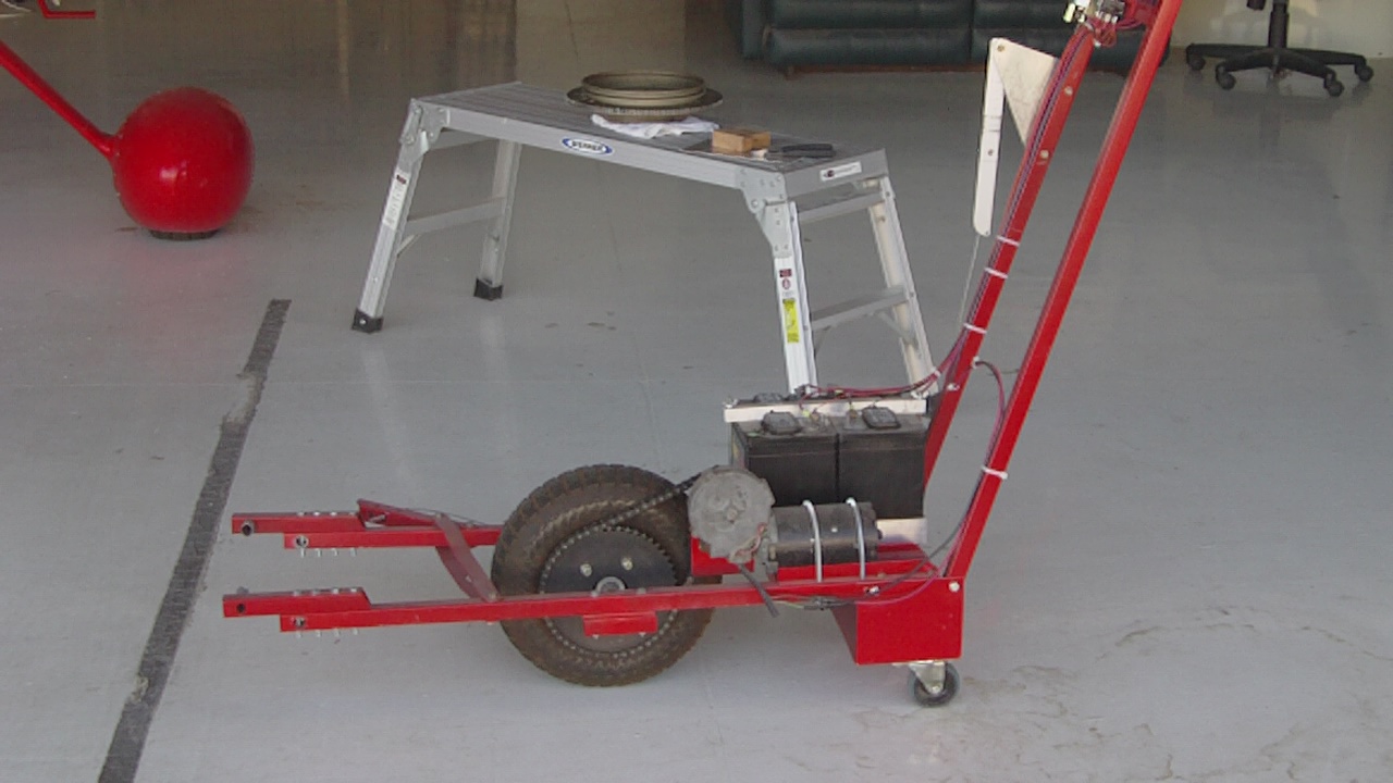

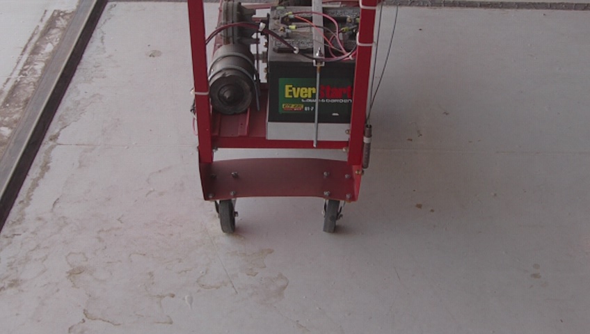

I finished my tow machine and here is a picture. I have about $150 in it-I
didn't have to buy a gear head motor, the wheel is from Harbor Freight at
$9, the 2 batteries from Wal-Mart (the motor is a 24V so I have 2 speeds)
but I kept buying the 1" square tube from Lowes and it was expensive. 2
problems: the space between the wheel pant and the tow wheel is too small so
I have to extend the arms about 3" and I need to add a light so I can hook
up in the dark. I'm thinking about a seat also so I can ride it around. I
got the idea from a Kitplanes article a few years back.
Albert Gardner
N991RV
Yuma, AZ

I've seen homebuilt tows powered by cheap battery-operated drills after
folks find it cheaper to buy a whole new drill w/battery and charger
than it is to buy a replacement battery. They remote the variable speed
switch up near the handle.
Linn

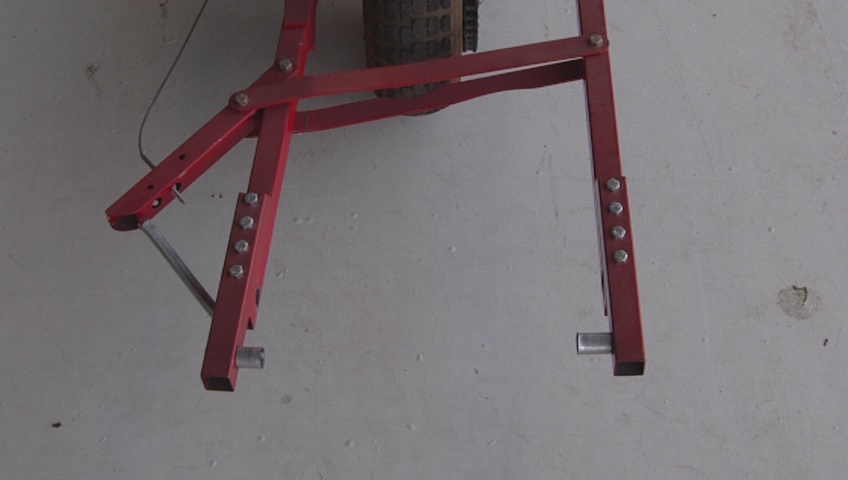

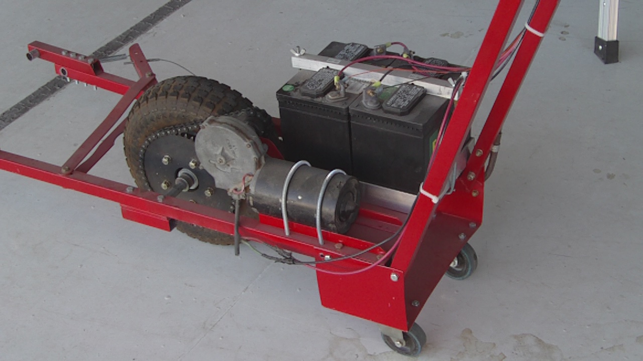

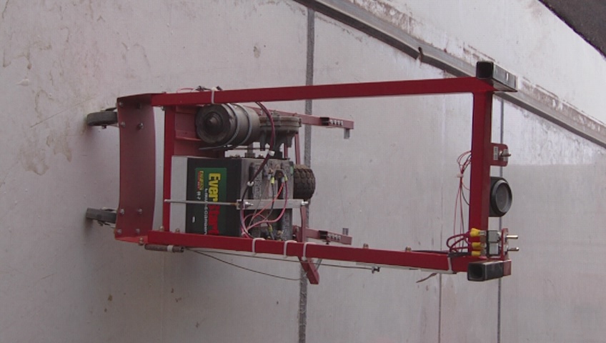

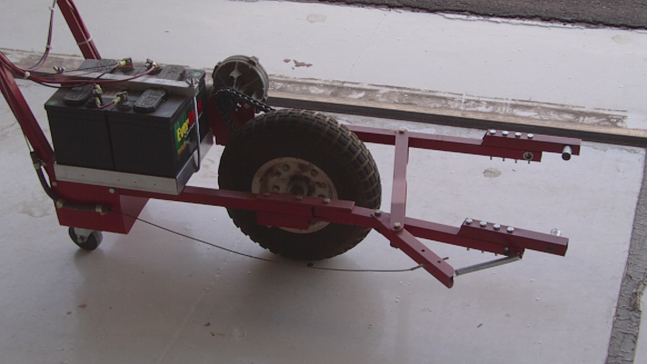

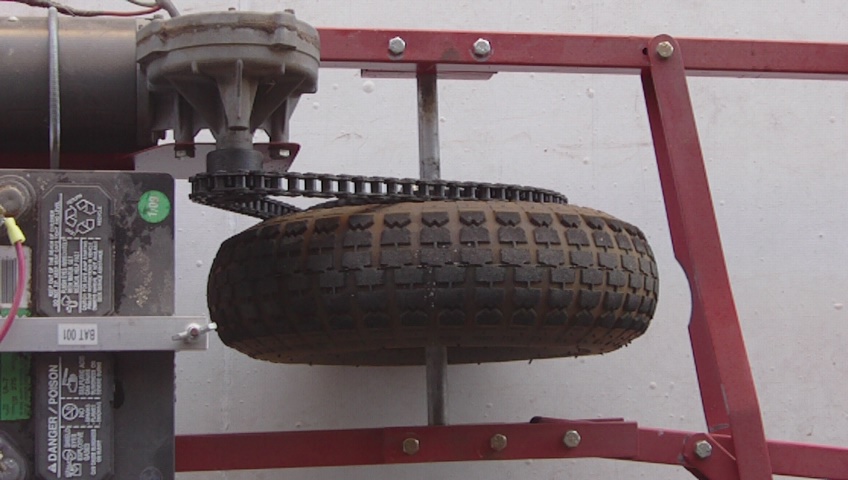

Rob, just got back last nite and saw your email. I see someone else sent
you a copy of the article but here are my pics. The motor I used was a 24
vdc from a friend so I don't know of a source for 12VDC gear head motors. I
supposed you could try the cordless drill route. I put some small 12vdc
lites up on the tips where it grabs the plane. Works very good (much better
than the pilot did) and I'm very happy. I originally had the clamping ends
too low and had to raise them so that you can push down on the handles to
increase friction on the tire. Also, I got my over-the-center clamp just a
little too close to the front wheel pant.
Albert

Thanks for the pictures. Gives me a good idea of where to start. Found some 24 v geared motors for scooters. Not sure if they will do. I like your motor configuration.
Rob Kermanj
