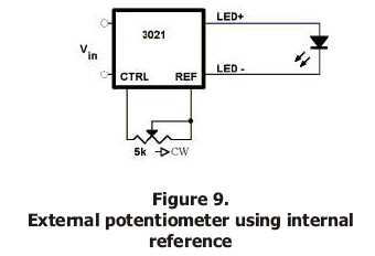

As shown on the LuxDrive data sheet, you can
'dim' the 3021 series devices by connecting
the appropriate resistor between CTRL and REF
pins.
[img]cid:.0[/img]
This adjustment sets a new operating current
that is lower than the rated current for the
device.
When I received the filters, it came with a hand written sketch for a wiring diagram. I have since downloaded a newer schematic from your website. Comparing the two, I see there is a difference in them concerning pins 2 & 3. On the original hand written one, both pins are labeled “N/C”. I assume this means “Not Connected.” (?) The newer schematic shows pin 2 as 5v ref and pin 3 as “Control Dimming.” As I am not considering dimming my Nav lights, I don’t need to connect these, correct?
You can wire a resistor (about 220 ohms I think)
between 2 and 3 on the 9-pin connector to set
your 1000 mA units to any desired lower current.
I now offer bench adjusted power supplies wherein
I attach a resistor to the bottom of the board that
produces the desired maximum current . . . this lets
me stock only one power supply (1000 mA) to service
the full range of builder needs.
In the future, I'll be re-laying the board to provide
a clearance hole to the potentiometer that comes
on the "I" devices.
