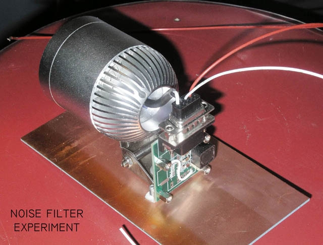

A reader sent me a pair of high intensity LED fixtures after he
discovered that they generated an unacceptable radio noise level.
http://tinyurl.com/aytljbg
I jury-rigged a filter from components I use on the BuckPuk supplies
and mounted it to the back of the fixture on short leads.
[img]cid:7.1.0.9.0.20130123131905.01e43b70(at)aeroelectric.com.0[/img]
The reduction of noise at 130 MHz is pronounced. I estimate
30 dB or better. Unfortunately, I've misplaced my set of
precision attenuators so I'm unable to make a quantitative
A vs. B comparison for effectiveness of the filter.
Fortunately, they're cheap. I've ordered some that should be
in early next week. I can put some real numbers on the
experiment then.
The goal is to head off the noise effects at the source. Wiring
to the airplane will be ordinary, off-the-spool unshielded wire.
When I'm ready to send these back to try on his airplane, I'll
try them out on my '87 GMC truck to see how they compare with the stock
headlights.
Watch this space.

Whether or not this particular configuration is
the dragon slayer remains to be seen . . . but
the dragon will be slain.

You are, of course, correct. The LEDs are very quiet.
Not zero noise . . . the electrical activity in the
light emitting junction is pretty frenetic. But
the aperture (antenna area) is very tiny so it's
hard to detect . . . much less a risk for a noise
source.
The problem is that LEDs are CURRENT operated
devices. You're probably familiar with the ubiquitous
resistor wired in series with an LED to SET the
current flowing through the device. To light an
red LED (typical voltage drop on the order of
2 volts) from a 14v bus, you have to pick a resistor
that causes the desired LED current to flow (30 mA)
with a DROP of 12 volts. This means that the series
resistor dissipates 6 TIMES as much energy as the
LED . . . but it's so small as to be insignificant.
POWER LEDs will demand much larger current values.
Consider this device
http://tinyurl.com/a2sggv4
which is rated at 10 watts. Note that it's rated
to operate at 3 amps so one would guess that
the operating voltage is about 3.3 volts (typical
for white). So, using a simple series resistor
for 14 volt systems would dissipate 30 watts . . .
NOT insignificant.
The elegant solution demands a special kind of
DC to DC converter. VARIABLE voltage input
(say 10 to 16 volts) and CONSTANT current
output (3 A). Now, we can hook perhaps 3 to
6 lamps in series (10 to 20 volt operation)
but at a constant current.
This bit of electronic magic is ALWAYS
noisy. Your computer, tv, and countless
other appliances have similar power supplies
but they're generally qualified to FCC part
15 rules for expected but limited emissions.
No so with LED lamp fixtures from Fuzzy Joe's
Motorcycle shop . . . or 24xydiy.com either.
We had some discussions here on the list about
LED position lights wherein a number of
builders using a particular DIY kit were
experiencing radio noise from the LuxDrive
power supplies recommended for the installation.
This prompted development of the filtered version
of the LuxDrive part which I've offered now
for several years
This board is the foundation for the experimental filter
I crafted for the aforementioned experiment. This jeeped
experiment may not be the ideal way to go for an on-purpose
filter but then, the then, the boards are already fabricated
and in stock.
Our very own Eric Jones offers an LED based tail light
http://tinyurl.com/b377jtv
Which has enjoyed the benefits of creative tailoring to
the task and generates no objectionable noises.
Bob . . . [quote][b]

PostPosted: Fri Jan 25, 2013 1:28 pm    Post subject: LED landing light filter experiment Reply with quote
2. What is the simplest way to detect HF noise from an LED; maybe an FM or AM radio receiver, or better yet, an aircraft nav/com receiver?
Trying to KIS.. Wink
There was a time when an airplane might have
several kinds of receivers vulnerable to radiated
and conducted signals from potential antagonists.
In order of spectrum they would have included
ADF/AM Broadcast receivers, Loran, HF communications,
Marker Beacon, VOR/LOC, VHF Comm, Glideslope
all topped off with DME, transponders and GPS.
That list is certainly diminished. Most OBAM
builders radios of interest are limited to
VOR/LOC, VHF Comm, Glideslope, Xpndr and
GPS. Each potential victim presents a unique
signature and magnitude for immunity to extraneous
signals.
The easiest way to test for vulnerability is
in flight and testing each potential victim
at the fringes of its normal performance range.
See if turning the antagonist on/off makes any
observable difference in performance.
This real-life/in-situ A-B comparison requires
no calibration of measurement. Obviously, the
hand held or bench receiver with some sort of
'sniffer' antenna can be used to see if any noise
can be detected . . . but the noise being heard
may not be so strong as to be significant.
The tests I'm performing now use a filtered and
an unfiltered LED assembly. The detector is a full
coverage communications receiver with a precision
attenuator between the receiver and the sense
antenna. The filtered lamp assembly is fired up
and a noise level measurement taken on the receiver's
strength meter. I then turn on the unfiltered
device (which is stronger) and then switch in
values of attenuation until the receiver sees
the same level of noise. The value of attenuation
tells me how GOOD the filter is. I.E. the noise
a some frequency of interest is reduced by XX
dB. 30 dB is a factor of 1000 reduction.
Now, putting real numbers on those signal strengths
is a separate experiment. The experiment cited
only speaks to filter effectiveness and says nothing
about gross numbers for the radiated noise.
Hand held, un-calibrated detectors are very handy
for detecting the presence of noise and to a
limited degree, measuring the efficacy of a noise

The lamps we're wrestling with are arrays in the
25 to 35 watt class used for position lights,
landing/taxi lights and perhaps strobes.
They DO have power supplies that WILL be noisy
if not properly filtered.
James
On 23 January 2013 23:06, Robert L. Nuckolls, III < nuckolls.bob(at)aeroelectric.com (nuckolls.bob(at)aeroelectric.com)> wrote:
At 01:54 PM 1/23/2013, you wrote:
Nice work Bob. Â Do you mind me asking... what is about these LED lights that makes them so noisy? Â In my head, LEDs are completely inert and therefore wouldn't create any interference.
 source.
 NOT insignificant.
 for several years
Â
 and in stock.
ist"
