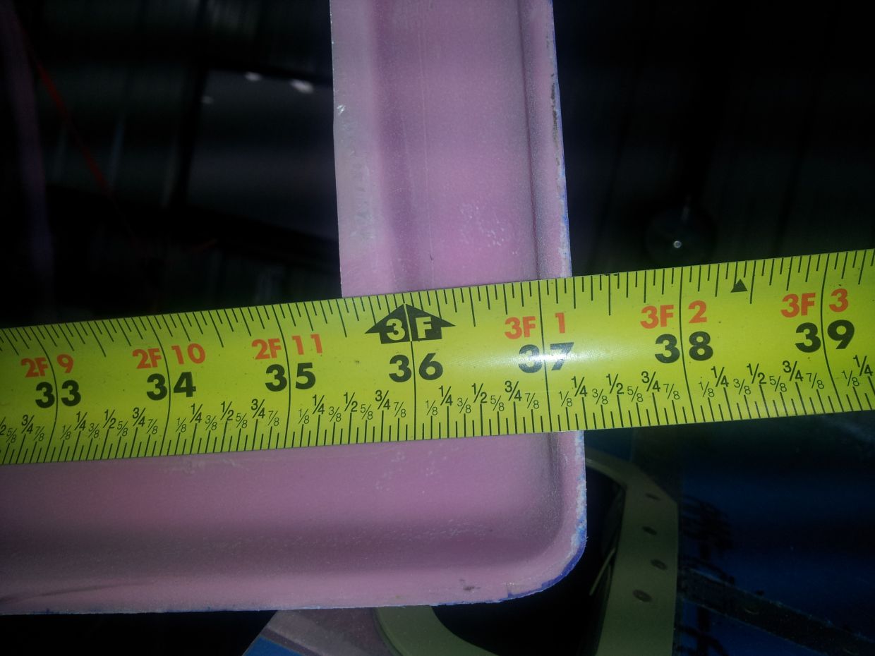

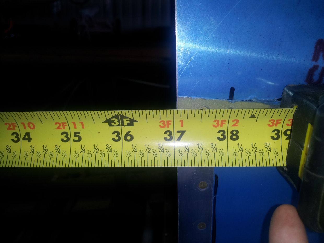

I need some advice.  I am trying to fit the cabin top, and it just wont fit into the door area.
As you can see from the attached pics, I have a 37 1/16" space to work with.  But if I sand the cabin top down that far, I am almost in the door channel.
Did anyone else have to sand down this far?  How far is to far to sand?

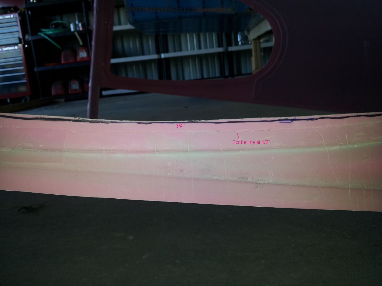

Also, did anyone else's "scribe lines" seem completely random, and at times be almost 1/2" off completely?  I have attached a picture example of that as well.
[img]cid:ii_13c5a1496743bb4a[/img][img]cid:ii_13c5a12a9a395c36[/img][img]cid:ii_13c5a128244ff057[/img]

Just keep sanding, it will eventually fit.  I would go from side to side so that each side had about the same amount of materiel left when I was done.  The scribe lines are almost meaning less.

What John said. I was real surprised how much past the scribe lines I had to go on both the top and the doors to get everything to fit. It's tedious, but keep at it a little at a time. I got real good at being able to lift the top into place solo in order to do a fit check.

You're right, you might be taking a little of the back of the door frame off. That's normal. Just make it fit. Same is true for the bottom edge. It gets pretty thin.

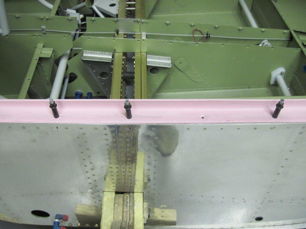

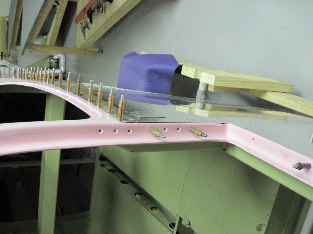

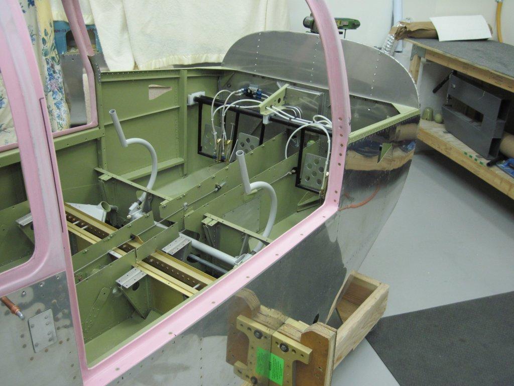

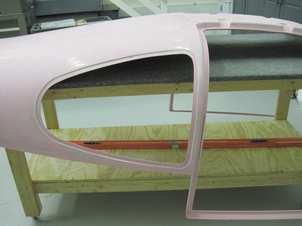

I attached some photos of mine after trimming.

I had to go past the scribe lines too. Regrettably the 'standard fit' is tight and variable due to the imprecise nature of the fibreglass moulding. Just keep sanding and trimming until it all fits. It's tight, but you eventually get there.

Same here - and I go back to the older green top.
It occurs to me that fiberglass top is actually pretty consistent from
part to part - even green to pink. They all fit the same way is rather
crudely. I'd venture to say everyone has to go past the scribe lines
(they are a good starting point) and everyone ends up with some very
thin areas. The same thin areas from what I can see in this thread.
I have 2 Kit log pages here that won't be much help but I talk a bit
about tools. The only thing I can say with confidence is either work
outside or get a filter bag for your shop vac.

I found a pneumatic die grinder with one of the blades supplied in the kit to be the best way to trim the cabin top. Thereafter I used an orbital pneumatic sander (with inbuilt vacuum bag - cost me $39) with 80 grit paper to be the best tool. A pneumatic air file was also used to get into the corners.
