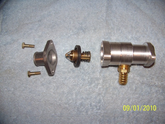

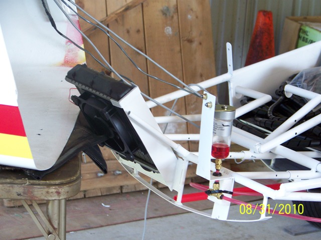

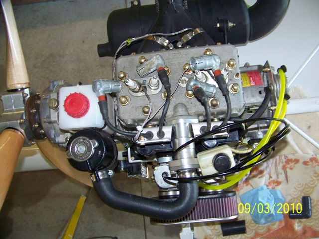

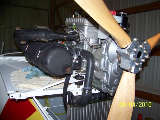

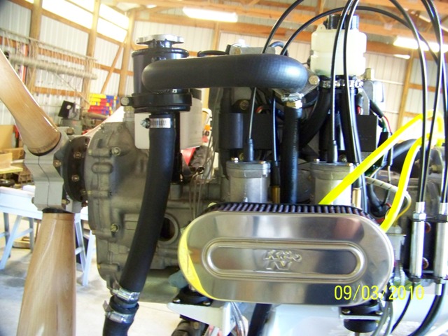

Wesley,my answer to heat with my 582 was to make an adapter to move the thermostat out about three inches. Then I could tee a heater hose in between the head and the thermostat.Installed a heater core out of a chevy s10 pickup.Used a ball cock valve to open and close water flow to heater.Return line entered back in just before the water pump on opposite side of motor.In cold weather the thermostat will open when needed to let water thru to main radiator.Takes the chill off very well.Put a small 12 volt fan on the back of heater core with just a on and off switch.Switching engines to a 912 UL now so will be making some changes but will be basicly the same setup.Pictures attached

Professional looking setup. I like it.
However, for my own personal use, the Chilli Vest is simple, quick, and doesn't pipe hot water into the cockpit area.
