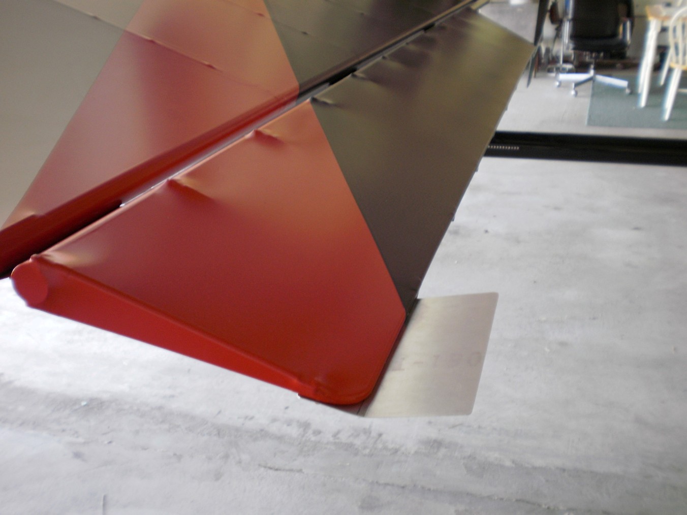

Here's the pic of my Tab. I'll paint to match in the spring

PostPosted: Fri Jan 18, 2013 11:46 am    Post subject: Aileron trim-drag question Reply with quote
Fireflies must be different than Firestars, Mine is pointed in the other direction. You probably should make sure that you need the elevator to go up or down before you fasten it in a permanent fashion.Larry

PostPosted: Fri Jan 18, 2013 12:51 pm    Post subject: Re: Aileron trim-drag question Reply with quote
Not sure what you meant by elevator up or down. This is an aileron trim tab. I determined what direction the ailerons needed to move before I made the tab to achieve the desired trim. The tab can be mounted up or down as long as the proper aileron side is chosen to do the type of mount you desire and the aileron deflects in the direction desired. In my case, I would achieve the same result with a downward pointing tab mounted on the opposite aileron. It may be a matter of what is more visually appealing to a person. The plane has already flown in the current configuration and my trim problem was solved. I just haven't got it mounted permanently yet. It's possible that a tab may work better in one configuration as compared with the other but an engineer would have to help with that. I don't know that answer.

PostPosted: Fri Jan 18, 2013 1:19 pm    Post subject: Aileron trim-drag question Reply with quote
Oops, I thought that it was an elevator. You are of course correct. ( The sun was shining on my computer screen and I couldn't see the screen clearly. You believe that?)Larry

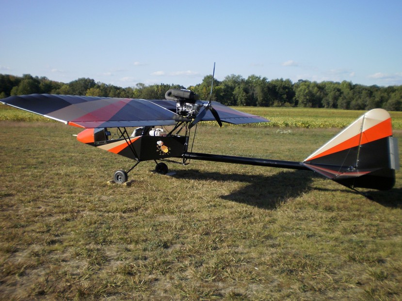

PostPosted: Sat Jan 19, 2013 7:45 am    Post subject: Re: Aileron trim-drag question Reply with quote
It's certainly possible that one or the other wing could have a twist. This was my first aircraft build. The wing halves were actually built in a bedroom of my house last winter on a set of heavy sawhorses. My basement has a 90 deg turn in the stairway so couldn't get wings built down there. I actually had to bring my drag struts through the window for install since they had to fit through a little guide tube on the inboard steel ribs. My leading edges on the wings line up perfectly and of course the trailing edges attach at the U joint. Doesn't mean that there still couldn't be a problem with incidence. I can even see how twist could be induced during the covering process with too much shrinking. I think I could fix an incidence problem using Dana's method but twist sounds like a teardown to me. The plane flies well now with the tab so I'll start the summer with that and then look into seeing if I can fix anything. The key will be if I go to a get together somewhere and somebody can give me some help looking it over.

PostPosted: Sat Jan 19, 2013 8:03 am    Post subject: Aileron trim-drag question Reply with quote

PostPosted: Sat Jan 19, 2013 9:30 am    Post subject: Aileron trim-drag question Reply with quote
What is done is done. I had a roll trim issue on my VW powered MKIIIC but decided to fix it with the optional Kolb adjustable rear attachment fitting. You move washers around till it flies the way you want it. No extra trim tab needed. I personally feel you will have less drag if the wings are aligned properly but I can't prove it.

It's certainly possible that one or the other wing could have a twist. This was my first aircraft build.  The wing halves were actually built in a bedroom of my house last winter on a set of heavy sawhorses. My basement has a 90 deg turn in the stairway so couldn't get wings built down there. I actually had to bring my drag struts through the window for install since they had to fit through a little guide tube on the inboard steel ribs. My leading edges on the wings line up perfectly and of course the trailing edges attach at the U joint.  Doesn't mean that there still couldn't be a problem with incidence. I can even see how twist could be induced during the covering process with too much shrinking. I think I could fix an incidence problem using Dana's method but twist sounds like a teardown to me. The plane flies well now with the tab so I'll start the summer with that and then look into seeing if I can fix anything.  The key will be if I go to a get together somewhere and !
