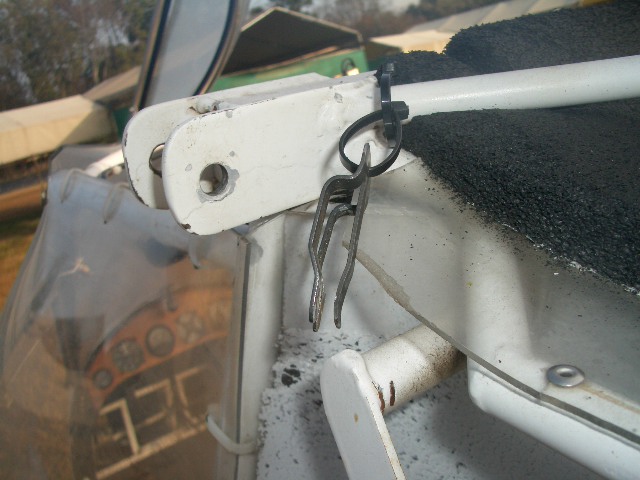

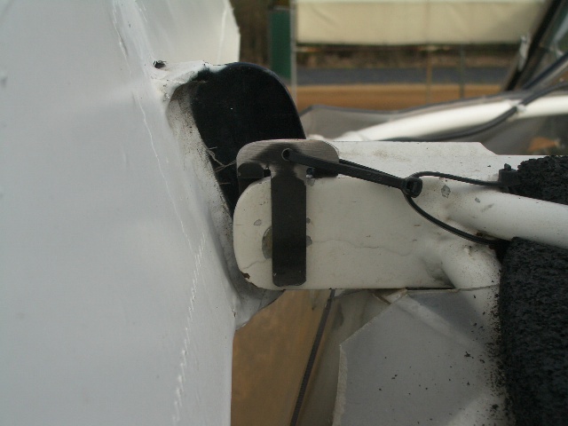

If you fold and unfold and don't like the pins to be moving out til the spring safety wire clip is up against the hole,this makes the head of the pin be the stop.G.Aman MK3C
