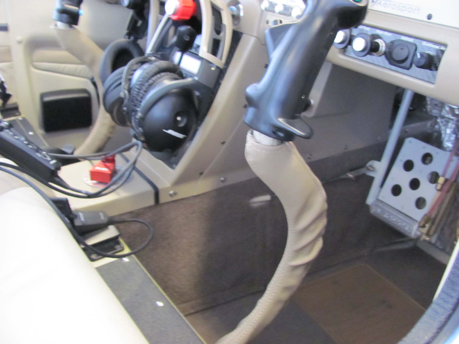

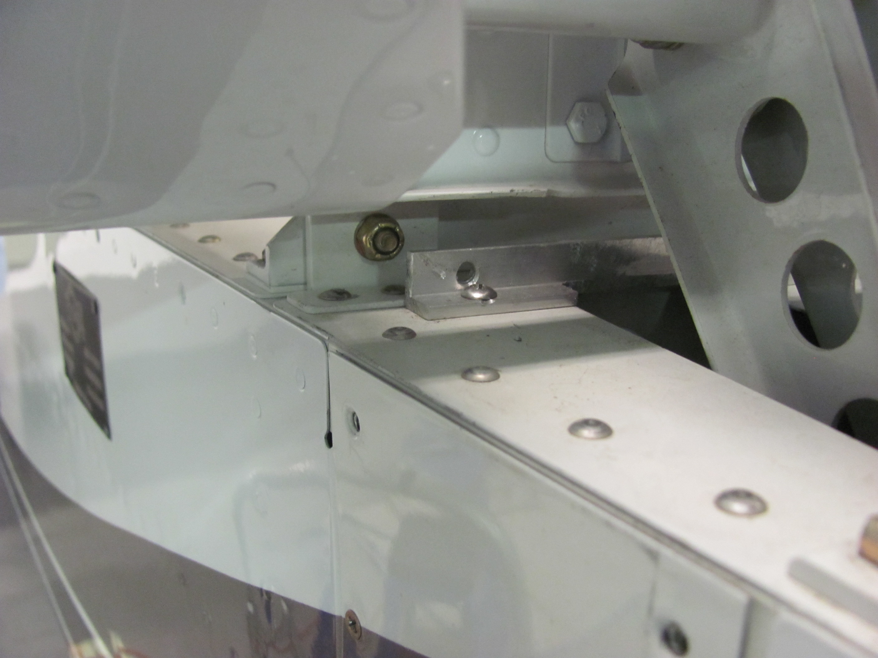

Patrick attached is a picture of the stop that I used. This idea was from
another RV-10 pilot that had the same
Problem with another brand of panel. They are very easy to install. I used
8-32 screws with locknuts and washers for the hardware only 2 required. You
will need to cut a notch in the piece of angle aluminum to allow for the
amount of deflection needed.
Contact me if you have other questions or concerns with this. Which stick
grips are you using? Also attached are
Some pictures that show where the sticks should be located when cut to fit.
I think on the grips in these pictures
There was only about 1" left
Geoff

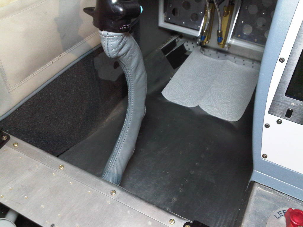

Geoff is correct. I have the Aerosport Panel also. You will end up with the stick cut down almost the entire amount. You should also cut the lower section so that it will insert into the control arm further and bring it further back. After you hook up the controls, you need to make an elevator stop which will prevent the stick from hitting the front panel on the inside corner. After that, you can adjust all of the push rods to obtain the correct amount of travel required by the spec. You need to make sure that the controls have enough clearance WITH your hands around the grip.
