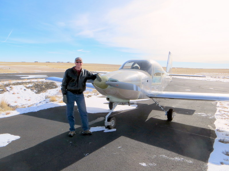

N433RV RV-10 made her maiden flight on December 29th after nearly 9 years of building.
My -10 is powered by a rebuilt Lyco IO-540, 2-blade Hartzell blended airfoil propeller, dual Light Speed electronic ignitions, dual B&C alternators and B&C starter. The panel includes Grand Rapids HXes and EIS, PS9000 Audio, Garmin 430W, SL30 and GTX330 xponder, TruTrak autopilot, Navworx UAT and a few steam gauges. It's a very nice ride.
The plane has amazing performance. KFLY is at 6800' MSL and I was at pattern altitude before reaching the end of the runway. The controls were very responsive and the plane did exactly what I asked. I found that my -10 has a heavy left wing as has been reported by others. However, that should be easily remedied by adding some aileron trim. Speaking of trim, the Final Inspection document stated that "1/3 nose up travel" recommended for first flight. However, I found that to be way too much (50 lbs of sand in the baggage compartment for W&B). Neutral trim would have been a better choice - at least for me.
My first flight was cut short due to a fuel issue after about 30 minutes. Fortunately, both pilot and plane made it safely back to the airport where I made a surprising good landing for an RV rookie. I can hardly wait to get back in the air after everything gets the once over.
Thanks to my family who put up with riveting, cutting and dust in our garage... To the folks at Van's for providing a great design, to AlexD for quality transition training, to numerous EAA Tech Counselor visits and to my builder buddies (you know who you are!) and, of course, to tips provided by many of the folks on this list........ I couldn't have made the journey without lots of help from all of you!
