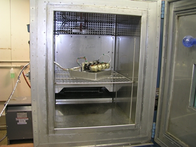

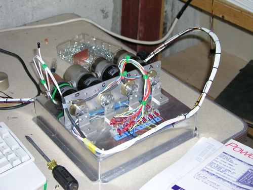

In later years on the same program, I built
a qualification test fixture for those same pitch
trim motors
[img]cid:.0[/img]

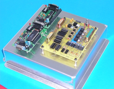

This time, a combination of both data gathering
and test control was orchestrated out of a PC using
the two dark green Weeder Technology boards seen here.
$70 each as I recall.
Yeah, that's a cake pan chassis.

becomes the problem to be solved. That light
green interface board took a day to lay out and
another day to stuff it. Then I spent about a week
instrumenting the motors and getting them into the
chamber.

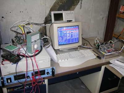

[img]cid:.1[/img]
[img]cid:.2[/img]
If that screen looks a bit like PC-DOS, you're right.
I keep a DOS laptop around just for the purpose of
quickly firing up a bevy of test tools to go-get-numbers.
That Weston transistorized "VTVM" has been in my toolbox
for 40 years . . . still works fine.
