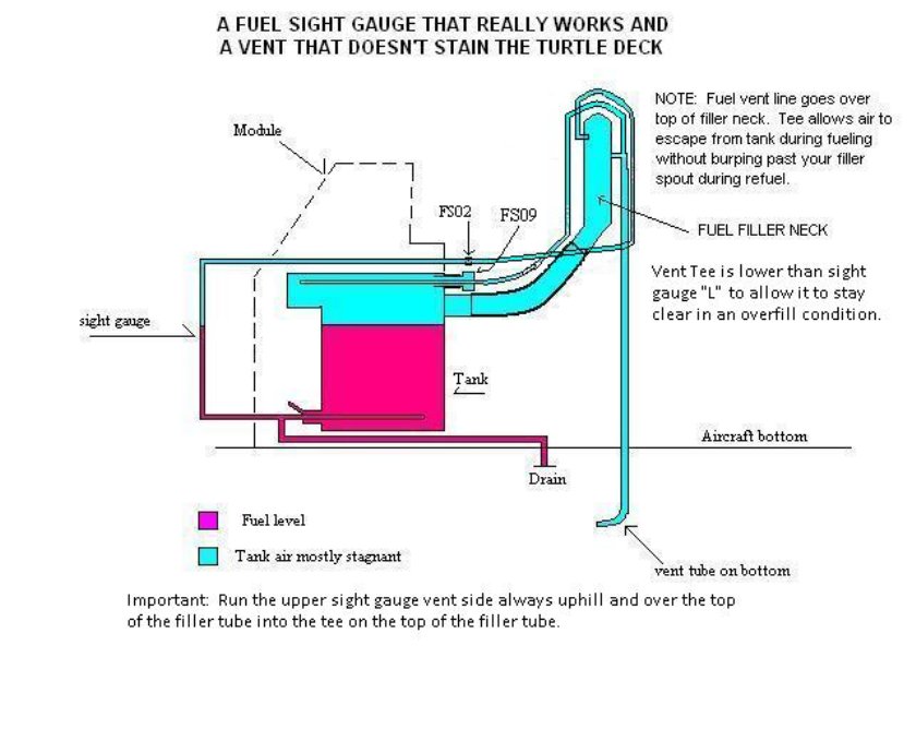

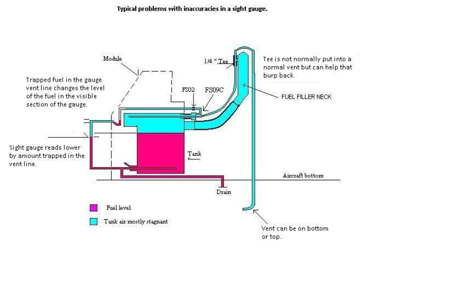

PostPosted: Fri Dec 28, 2012 11:18 am    Post subject: Fuel sight tube Reply with quote
<?xml:namespace prefix="v" /><?xml:namespace prefix="o" /><![endif]--> [img]cid:020b01cde52f$5BDF7992(at)goldfishbk2xxe[/img][img]cid:020c01cde52f$5BDF7992(at)goldfishbk2xxe[/img] Photo E-mail [url=https://skydrive.live.com/redir.aspx?cid=2161856909618aa7&page=play&resid=2161856909618AA7!300&type=5&authkey=!ADE17rtw2HovWOQ]View slideshow [/url]| [url=https://skydrive.live.com/redir.aspx?cid=2161856909618aa7&page=downloadphotos&resid=2161856909618AA7!300&type=5&authkey=!ADE17rtw2HovWOQ]Download images [/url] Will,
Your sight gauge woes are common. Attached is a visual of what the problem is. Essentially any fuel trapped in the vent side of your sight system above the fuel tank fuel level adversely affects the fuel level in the clear sight tube.
Not to insult intelligence of anyone, but the only way to keep the sight tube vent side clear is to run it uphill all the way to the vent. I personally don't like the overhead vent because the low pressure area over the top of the aircraft creates changes in the sight tube level also. To remove some of that problem, I prefer folks to put a tee in the fill neck to allow the tank and the sight tube to be the same air pressure. That said, running the sight tube vent side so that fuel can never be trapped in the line on a mono or trigear is very difficult. At times for a tail dragger, it is impossible. I have a sight gauge in my trigear that works flawlessly. But it runs above the tank, downhill from the top of the fill tube. But it still can get fuel in my vent side. I know mono owners that have very accurate sight tubes but took great care not to trap fuel in their upper line. Following Chapter 30 of the build manual, it shows a method to run the foot mounted sight tube and it works well normally at cruise speed.
Most government regulations on aircraft require some means to visually determine the amount of fuel in the fuel tanks by the pilot during preflight because electronic gauges and senders are prone to their own inaccuracies. I have a sight gauge, a fuel quantity gauge, a fuel totalizer, and a wrist watch and knowledge of my engine's fuel usage per hour. I also carry a small piece of tubing which inserts into the inside of the fuel neck on to the tee to blow out any trapped fuel that some line boy fueling my aircraft injected into my sight gauge line. Talk about the department of redundant redundancy.
