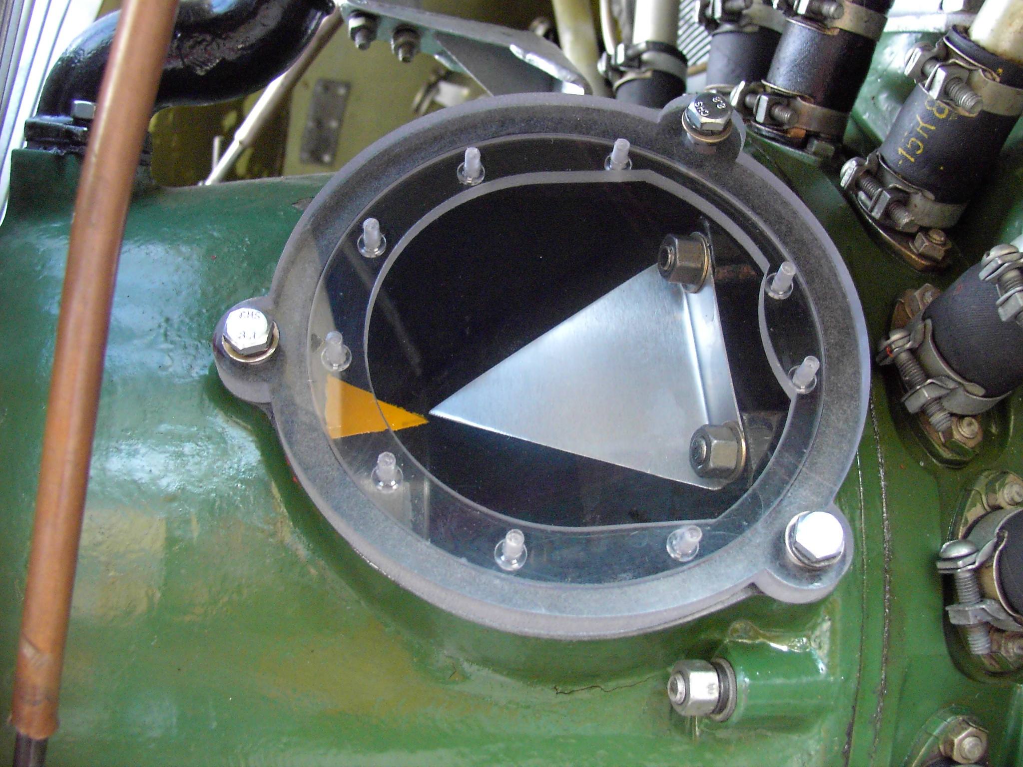

Attached is a pic of a Nose Case window for the M-14P gearcase. Built from thick CNC cut polycarbonate, this kit makes it easy to position the prop with the master rod at TDC on #1 cylinder. Doing this greatly cuts down on oil drain down through the lower cylinders and stacks. Consistent use means that an oil tank shutoff is not required. No tank shutoff eliminates the complexity and risk of failures due to such a mod.
Another benefit is being able to mark the crankcase position for #4 TDC and firing point... much more exactly and consistently than other methods. Valuable for checking magneto timing during annuals.

Great ideas Craig. However you should mention the polycarbonate cover can only be installed on M14's with the side cover plate on the nose case typically found on Series 2 engines.
