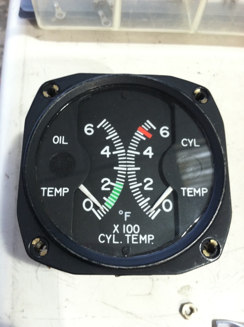

We're working on a plane with a self-powered oil/CHT temp gauge.  The oil side is inop, the CHT side seems to work fine.  The customer asked us to fix the oil temp side.  It gives no indication or needle movement at all when installed.
We removed the entire gauge, wire, and probe.  The first problem seemed to be really poor connections so I fixed that--no help.  Then I replaced the K type lead (as found) with J wire of about the same length.  Still nothing.
I know now that the length of the wire is critical, but I don't know how to find what it should be.  I see a note on the back of the gauge that says it needs to be an 8 ohm lead, but I don't know how to measure that--through the entire system, just the wire, or some combination.

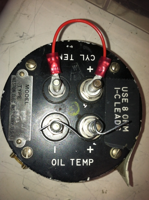

Here are some pictures of the probe and the gauge.  Can you tell me what to measure to verify that the probe is working?  I've heated it up with a heat gun and a hot water bath but I don't get any comprehensible results.  Measuring mV, the multi-meter just seems to kind of wander.  About all I can say for sure is that it changes from positive to negative voltage depending on temperature, as if zero output is somewhere around room temperature.  I have seen up to about 50 mV in hot water that was about 120F but that doesn't seem consistent and it changes rapidly.
The gauge responds as I'd expect with the jumpers shorting each meter, that is, the meters lose their "bounce" with the jumpers installed.  I quickly brushed each meter's leads with an ohm meter to see if they'd respond, and they do.  Everything points to the probe.

should be. Â I see a note on the back of the
This would be total loop resistance of the thermocouple
and it's leads as measured at the instrument terminals
(with the instrument disconnected).

What resistance do you measure on the two thermocouples?
The meter scales seem to suggest that both sides have
identical movements in them. You should be able to swap
the CHT over to the OIL temp side and see an appropriate
reading. This should confirm that the thermocouple is bad.
Yup. Get an ohmmeter reading on the questionable
probe and compare it with the CHT side. They should
both be on the order of 8 ohms.

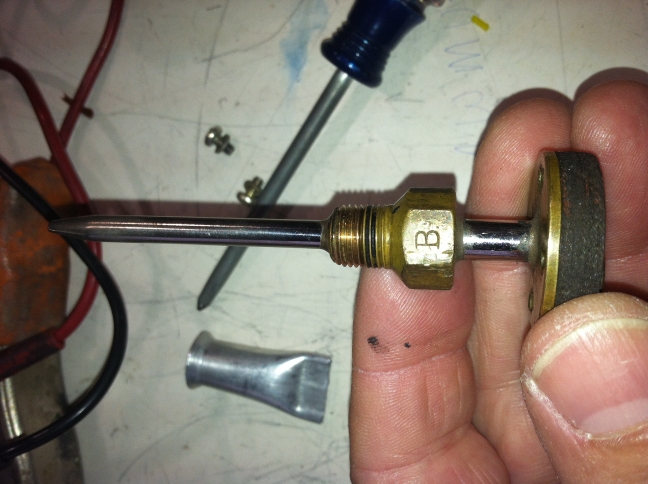

The functioning thermocouple is the type that goes under a spark plug.  It measures 6 ohms one way, 4 ohms the other way, including the lead.
The other thermocouple is "nearly open"... very high resistance, 500K one way, 300K the other way.
That was the part of the puzzle I needed.  Now I know what to replace.

What can I say...the old neurons need the rust busted off just like an iron wire now and then.  At least I didn't ask about parasitic junctions--that I remembered from your seminar, and I use that little tidbit every time we install the eight to 14 thermocouples on most of the engines we wire.

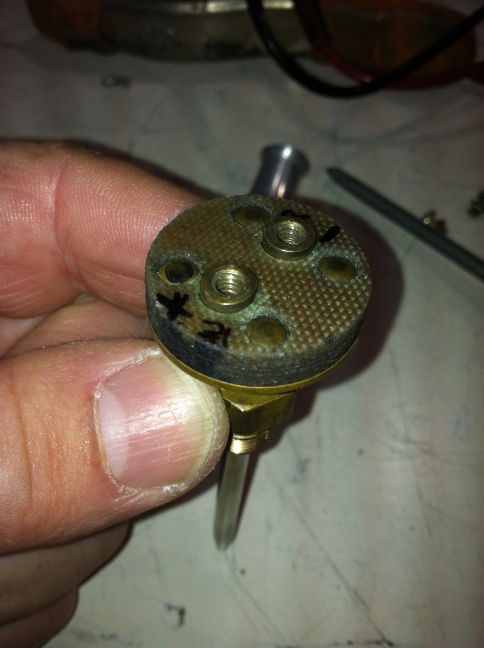

The thermocouple that failed (the one in the picture) is a probe type that threads into the oil screen housing.
Once I realized it was terminal, I took it apart.  The iron wire was badly corroded and literally fell out of the probe body onto my workbench.
It was covered with thick red rust.
The other wire was firmly attached inside at the tip of the probe.  I don't see any practical way to reattach an iron wire inside the tube of the probe so I'm open to suggestions.  I'll probably try to find something similar to replace it.
It's not surprising that the iron corroded.  It got a hot/cold cycle on each engine run, and it was by no means sealed from the atmosphere.  On every warming it drove out the air in the tube and on every cooldown it pulled in whatever was outside.  It took 65 years, but it finally gave up the ghost.

Actually Dave, that thread looks like 1/4"NPT, give me the length below the threads and I can make a whole new probe.

In fact, I note that the back of your gage is marked
for 8 ohm, I-C leads. I think you mentioned that earlier
but it got stuck in a transient short between the headphones.

The loop resistance for 20 gage stranded type J wire
is .348 ohms per foot. An 8-ohm probe lead would require
all of the 25 feet. Were your old leads that long?
The they were originally 22AWG, then the overall
length would have been about 16'
Alternatively, you could use a shorter lead set
up to require a precision low-ohms resistor. For
example, a 10' lead set of 20S I-C wire would have
a resistance on the order of 3.5 ohms . . . so you'd
want to insert an additional 4.5 ohms in series with
one lead. Yeah, this creates some parasitic
thermocouples but they are opposing pairs in close
thermal proximity.
Self powered thermocouple instruments for large
airplanes used to always require calibration resistors.
This let you use a common instrument and probes
for all 4 engines while offering a way to compensate
for different installed lengths of thermocouple wire.
