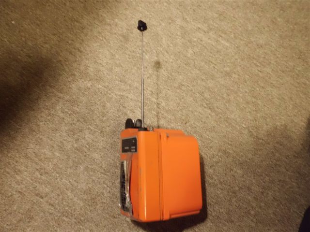

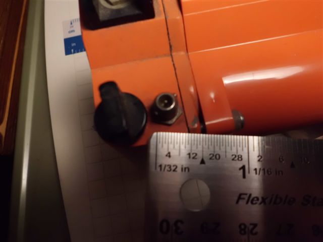

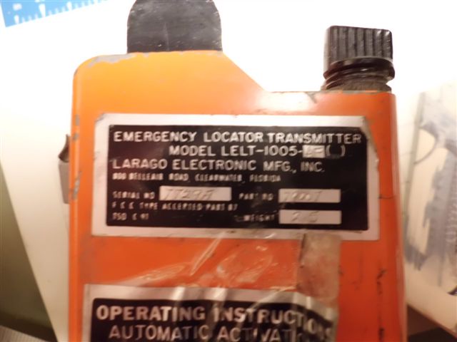

Anyone recognize this ELT, or the antenna connector used? The antenna is
missing, & the owner needs either an original 'fixed' antenna, or an
adapter to a regular BNC connector/cable for an external antenna. He has
the telescoping accessory antenna, but his IA won't sign off the plane
with only that antenna.
Charlie

Charlie, I had this conversation about antennae for ELT's with the Wichita FSDO last summer. The antenna is part of the TSO for the unit. You cannot use any other antenna other than that which the manufacturer supplied with it. Not legally, anyway.

<< My understanding is that the ELT and its accessories are granted approval to the TSO as a unit. You cannot legally change anything, not even the mounting screws supplied by the mfr. >>
There is a very small loophole. If the manufacturer's manual gives you an option or specification, you can legally use it. For example, the ACK E-04 manual talks about a ground plane in composite aircraft. They specify 6 pieces of copper tape at least 12" long spaced equidistant around the base. These tapes could be 1/32" wide or 1" wide or wider and still meet the letter of the regulation. Five or seven pieces would not, however. But if I used a solid sheet of metal doubt if anyone would complain.

I'll bet that you can't find a factory built single engine a/c that has quarterwave antenna installations (other than xponder or gps freqs) that meets TSO for installation.
No one can ID the connector??
