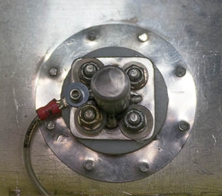

Consider this alternative. Since this is a slow speed
airplane with relatively low duty cycle, perhaps something
simpler and less robust would be attractive.
Mount 7/16 x 1/2" stainless bolt on a phenolic/fiberglas
skin doubler over a clearance hole for bolt head. Drill
and tap both threaded end and head of bolt for 10-32 screw.
Tread antenna-length piece of 3/16" steel rod about 1/2"
of 10-32 thread. Mount bolt on doubler head facing up.
Thread antenna into bolt and secure with lock-nut. Attach
feed line directly to nut-side of bolt with 10-32 screw
and PIDG terminal. Use PIDG terminal to ground the shield
to one of the doubler attach screws.
Low parts count. Low number of mated joints in the RF
current paths.
Antenna can be easily dismounted and stowed.

Bob, your solution isn't fully clear to me. Is the 3/16" rod silver
soldered into the 10-32 screw? To disconnect, one would unscrew the
10-32 screw? If the antenna is bent back, that may be a little tricky, no?

No, I'd leave the nut loose for a couple of reasons.
First, it would let you orient a bend and tighten the nut
later (this could be a finger nut made from a piece
of flat sheet with a drilled and tapped hole in the
middle but with enough O.D. to let you hand tighten.
Yeah, it would have a slight 'lengthening' effect
on the antenna which would be shortened accordingly
using SWR meter
(2) heating the rod to silver solder temps in
the thread area places the heat treat of the
material in doubt right at the threads (manufactured
stress riser).

Bob, many thanks for explaining it in detail. With your suggestions in
mind, I picked up some parts I had laying around and put this together:
https://www.dropbox.com/sh/rylqm9cect5ndut/XyaFh-jLE2
I'll have to find someone with an SWR meter and cut it to the proper
length. Then we'll see if it actually does what it's supposed to do. But
it's solid, and removed in seconds.

Holger, that looks fine. If everyone were as able to deal with a small
machining project like that as you are, there wouldn't be so many
lashed-up antennas out there. An SWR check will be useful but don't be

Bob, many thanks for explaining it in detail. With your suggestions in mind, I picked up some parts I had laying around and put this together: https://www.dropbox.com/sh/rylqm9cect5ndut/XyaFh-jLE2
I'll have to find someone with an SWR meter and cut it to the proper length. Then we'll see if it actually does what it's supposed to do. But it's solid, and removed in seconds.
Nice work! I'd like to add your photos to the archives on
aeroelectric.com.
Help me out a bit . . .
[img]cid:.0[/img]
It appears that your coax center conductor
is attached to the 4-bolt flange (pop rivet?)]
which in turn is insulated from the mounting
bolts with a combination of insulating bushings
and washers. Where does the coax shield find
connection to the groundplane/skin?
It's not clear how the antenna element is retained
on the aircraft/
As D.L. suggested, SWR isn't a terribly critical concern.
If you cut it for an overall length from skin to tip
of 22", you're going to be close enough for government
work.
It would be interesting to see a plot of your measured
SWR over the range of interest at say 1 Mhz steps. If
you've got better things to do on your airplane, don't
let this academic exploration get too high on the list
of priorities.
 Filesize:  64.36 KB
 Viewed:  7132 Time(s)
holger-d(at)shadowbrush.c
PostPosted: Sun Dec 16, 2012 10:24 am    Post subject: Removable comm antenna Reply with quote
on the aircraft/
D.L., Bob, thanks again! I'll go with 22 inches until I find someone
with a SWR meter. If this person and I can get the data for the plot, I
will send it to you, Bob.
That's correct, the coax center is attached to that rectangular flange
with a PIDG terminal. There is a threaded hole in the flange for it. The
flange is welded to a SS tube that receives the antenna rod. As you
said, the flange and tube is insulated against ground. I measured for
conductivity. There is a spring in the tube, just to make sure there's
good contact.
The coax shield is connected to ground a few inches away. I left that
unchanged from the previous whisker antenna installation.
That riveted skin doubler is the result of my damaging the original
antenna on the ground. Not going to happen anymore. But the main thing
is, I can now sew a full cover to keep it dry outside, and won't have to
put it on a trailer when a bit of wet weather is moving in. Means more
flying for me! Smile)
