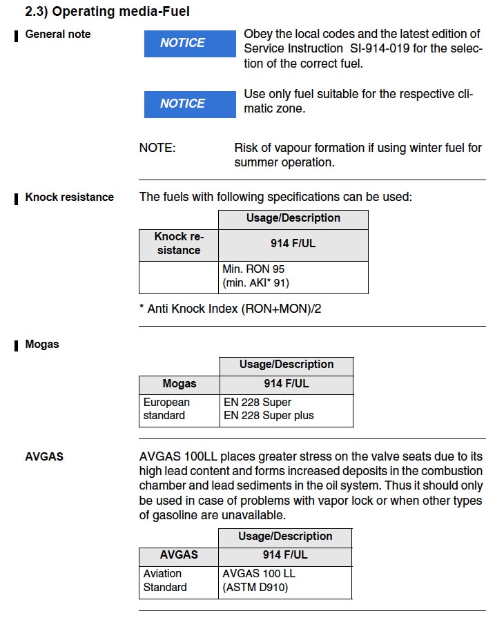

With regards to the Fuel Mogas, thinking of trying Mogas Super (UK) spec.

You got it! And Super or Super Plus Mogas. From the Rotax 914 Operators Manual:
[img]cid:E0E3238A-DF17-46D6-885C-45BC17E0068D[/img]

PostPosted: Fri Dec 14, 2012 3:08 am    Post subject: Rotax 914 Right Mag rough Reply with quote
Alan
Roger has a good point about fuel. Also if you are using garage fuel it will not keep very long so use immediately, I suggest you use 91UL if you can get it as this is Avgas without the lead and will keep much longer.
- The Matronics RotaxEngines-List Email Forum -

PostPosted: Fri Dec 14, 2012 4:35 am    Post subject: Re: Rotax 914 Right Mag rough Reply with quote
Hi All.
Phoned Con Air today the Soft Start Module with the 4 pin connectors is for early engines around the year 2000 like mine, it cost about £140 but you have to be wired in the cockpit to be able to start on one mag.
You can also purchase a Rotax kit that consists of 2 modules it retards both ignitions and requires NO cockpit wiring of mags switches, but this kits about £550 probably plus Vat ?? but Will only work with the later 6 pin connections on the later engines.
For me, Change Fuel to Super Plus, if no good, then wire for 1 mag start,.
if no good, fit Soft Start Module. or wait till summer before i fly.
As you can see i would rather berry my head in the sand and hope it would go away.
My last job was replacing the battery in the GPS and also wiring the main battery for external charging. I have just looked at the wheel struts why is there no little pad to put a jack under.?

Going back to Fuel, A friend mail me with this.
In the UK Super-Plus unleaded is generally refined to meet a standard BS 7800, not EN228. The only Mogas fuel currently approved by CAA and LAA is that refined to EN228, and without ethanol. The reason that the Super-Plus unleaded fuels are not approved is that the vapour pressure of the blend is very high compared with EN228 Mogas or Avgas. This could lead to an increased risk of vapour locking in flight.
I think there is no ethanol in Super Plus , but don,t know much about vapour locking, would have thought only in summer temps, but does anybody use Super Plus fuel, or can give some input on this subject as the fuel is approved by Rotax.
Alan
