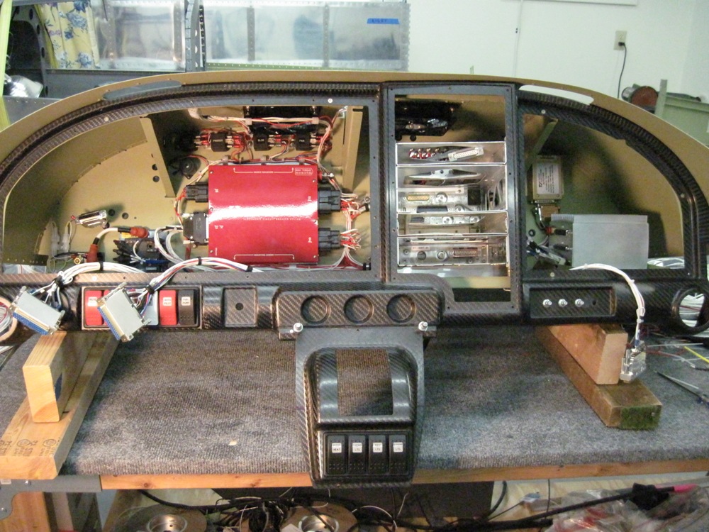

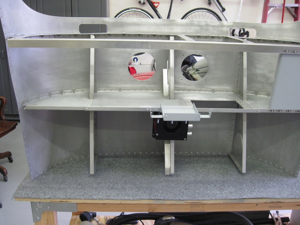

I installed the non-sym standard panel. Here is a photo looking up and showing the attachment of the new substructure from Aerosport. If you haven't already, download the installation instructions. The standard Vans panel is completely replaced when you install the Aerosport panel.

The support panel screws up tight to the back of the CF panel. The support panel has to sit about 1/8" low to allow room for the CF inside the upper cowl deck. I can get you some photos tomorrow when I go to hangar.
