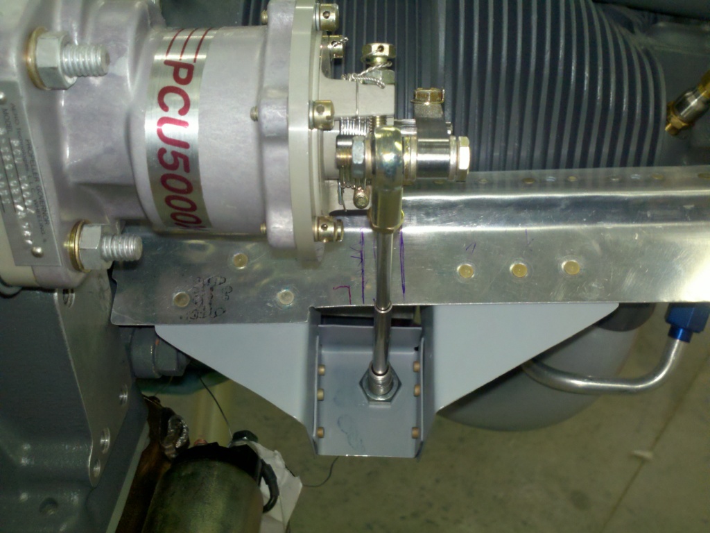

For those of you with the PCU5000-X and the YIO-540-D4A5, who routed cables per the vans FF instructions, what counter lever rotation and what clocking angle did you specify (if you got it right)?

PostPosted: Mon Dec 10, 2012 6:51 pm    Post subject: PCU5000-X Reply with quote
I found a photo taken during baffle fabrication (I made mine as I’m using a plenum). Don’t know how much different, if any this will be if you use the Van’s baffle kit. Please look beyond the temporary hardware in the photo.
The listed Van’s mixture and governor cables were the correct length (I am not using a quadrant), but the Van’s recommended throttle cable was too short. I got the 50.5” throttle cable that Van’s list for the RV-7 and it worked fine.

I noticed that nut in the pic and had to go back and reread.
