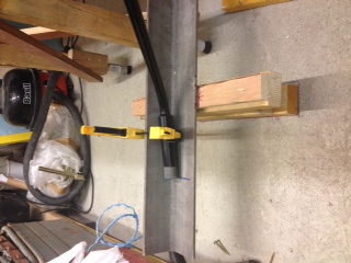

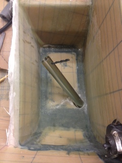

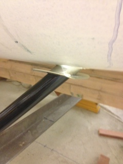

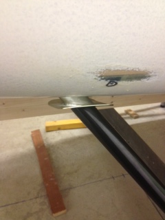

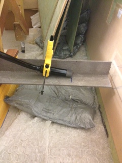

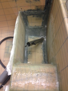

Hello
Today I have been busy trial fitting my gear sockets. but I have got a problem and wondered if anyone has experience this during building and how they have overcome it?
After taking my time setting everything up as per the build manual I inserted the gear legs and sockets into the holes clamping the axle's in position against angled bar with the axle center line on fuselage station 70 and the axle end 36.75'' from the fuselage center line. With all this set up the socket flanges are approx 13 - 15 mm of the fuselage.
I tried altering the fuselage underside to ground height but this made very little difference to the distance between socket flanges and the fuselage. I managed to get the gap down to approx 5-8mm by reducing the fuselage underside to ground height to 395mm, this is very different to the 413mm quoted in the build manual.
I have attached some photos showing the gap between sockets and fuselage and also the position of the socket tubes within the baggage bays when inserted.
Any comments or solutions to my problem would be much appreciated.
Many thanks for taking the time in trying to help me find a solution to the problems I'm experiencing.

PostPosted: Sat Nov 24, 2012 5:48 pm    Post subject: tri gear socket installation Reply with quote
How long are your sockets from the bolt hole, to bottom of the tube, at the
rear of the socket eg near the tail
Mine measure at 245mm (9.5 inches), perhaps yours are longer than they
should be.
My gap when installed was about 4mm.
craig

PostPosted: Sun Nov 25, 2012 12:57 am    Post subject: tri gear socket installation Reply with quote
Hi Donald,
1/2'' to 5/8'' gaps betwen the socket flange and the outer skin is not unusual, I could never work out where the variation came from ?
Most important is the ST 70 dimension.
Then ensure the track is true with the legs clamped to an angle straight edge.Take measurements from tailplane torque tube ends to check this.
Then ensure the horizontal datum of the angle aligns with the aircrafts horizontal datum [ tailplane torque tube / wing spar bushes ].
Then check the lateral position from the aircrafts centre line [ also check the positive camber of the axle shafts and adjust [ worsen] the side to side positioning to get the camber of the shafts nearer to each other.
Forget about closing up the gap between the socket flanges and the fuselage skin.
If you can close up the gap [ dropping the fuselage ] without buggering up any of the other parameters, well and good, otherwise go for it and use a thick Redux pad in the gap. I have slipped in some plywood shims to bulk out the gap if it as large as you describe [ Redux is expensive, slivers of wood will be free !]
Other things I do different, the lay up of the socket to Rib 1, don't smear Redux on the socket and do the lay up with Ampreg, do a HOT Redux lay up in 1 ply of Bid, 2'' onto each side of the Rib around the socket, peel ply and let cure. Then do the lay ups as per Manual.
Do a hot Redux lay up on the outer face of the socket flange, peel ply etc, before doing the 2 Bid lay up on to the skin. Do the hot Redux lay ups onto plastic sheet, wet out well, then slap it on like an elastoplast !
Ampreg doesn't stick too well to steel, and I don't like messing with two different epoxy systems going wet on wet ?
Cheers,
Nev.

Donald,
The build manual says:-
"If necessary, to ensure that the plate of the gear leg socket is against the side of the fuselage,move the
axles as required relative to the fuselage centreline keeping the axle centres on FS70".
By moving the legs in 1/2 an inch or so equaly on each side , you will close up the gap to a wedge shape, the manual also sugests the socket flanges can be adjusted to fit the profile better.
My fit was close enougth for an acceptable redux filling, after adjusting the fuselage holes slightly, but it does appears that your legs need to come together slightly .
There will be differences in exact positioning of the sockets due variations to the elogation required of the hole.
Two extra check measurement that I found usefull were from a second angle iron ran through the cockpit, sat on the door sills,pushed hard against the seat back, and dropped a plumbline from the inboard end to find a measurement from the spar face reference points :-
Not e : F S 70 is 2.25" aft of the forward face of the port spar     1.00 aft of the forward face of the Starboard spar. Mark up the fuselage to get a measurement to transfer from your second angle iron / plumb line, stick a spirit level on the angle Iron to check it is all parallel when setting up , and stand back an look at the job, making sure it is all square... Also, make sure your build cradle is squared off on all corners, and can not move. I set up a false floor with 3 layers of 3/4 ply,screwed down onto a pallet, with a timber beam accross to screw down and clamp on, you will end up spending days setting your measurements unless everything is fastened down solid. Finaly, you can do a dry run by lifting the sockets and legs to a flush position ,an using the first wedge shaped ply brace, hold the assembly in possition , then look at the axle to see how far in it is sitting . You are trying to acheive aligned axles on FS 70, within the factory height specified (prop clearance)  1/2 " or so different track width will make no significant difference, and is the factory recomended solution per the manual. Regards Kevin
