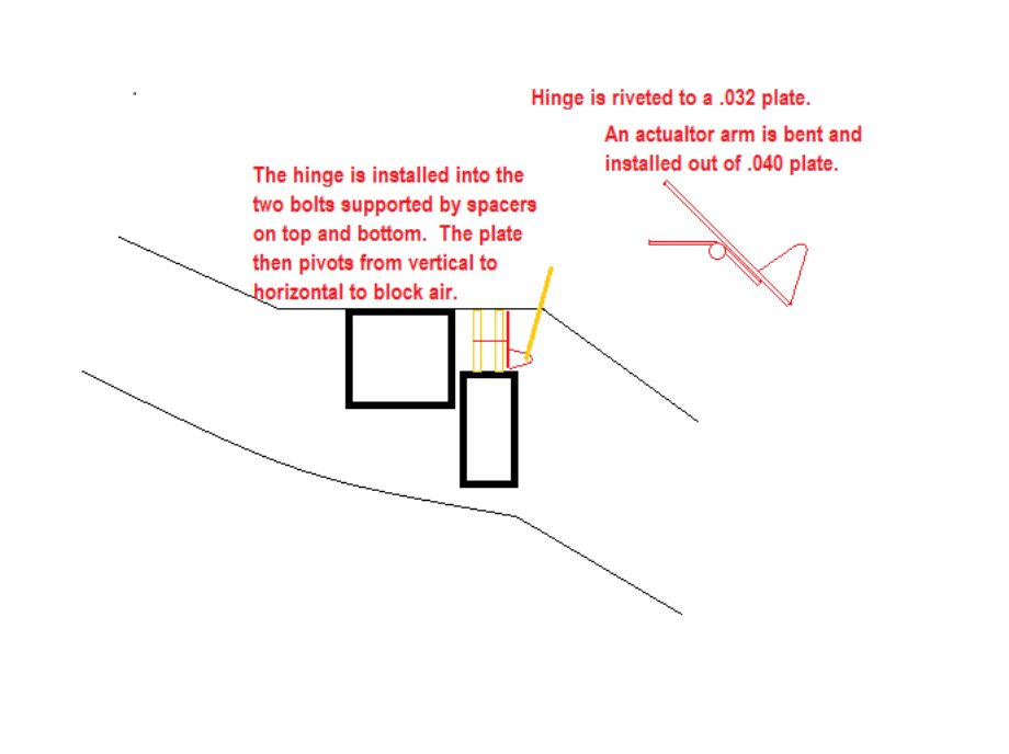

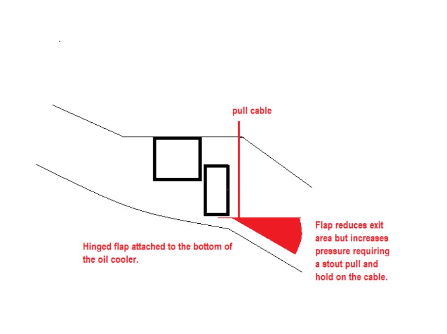

<?xml:namespace prefix="v" /><?xml:namespace prefix="o" /><![endif]--> [img]cid:011d01cdcb56$29C40C55(at)adminPC[/img][img]cid:011e01cdcb56$29C40C55(at)adminPC[/img] Photo E-mail [url=https://skydrive.live.com/redir.aspx?cid=2161856909618aa7&page=play&resid=2161856909618AA7!290&type=5&authkey=!APxkChnz5qtFle0]View slideshow [/url]| [url=https://skydrive.live.com/redir.aspx?cid=2161856909618aa7&page=downloadphotos&resid=2161856909618AA7!290&type=5&authkey=!APxkChnz5qtFle0]Download images [/url] According to Rotax there is not a technical minimum cylinder temp but I agree that we know that a warmer cylinder will be more efficient and the crankcase and gearbox will not harbor water in the case.
The oil thermostat is one way to get up the oil temp. I have tried to make a simple rear flap to close up the back but you would not believe the pressure coming out of the rear of those radiators and the duct suction pulling on the other side of the flap. A moveable cowl flap will work, but then we're talking repaint of the cowl. So how do we get the glycol temp up? Tape over 1/3 of the glycol cooler is a start. Next is making a removable metal air dam in front of the glycol cooler, but that is not adjustable. So what is needed is an adjustable flap that can be set from the cockpit for those warmer winter days, spring and fall operations or high altitude cruise operations.
Those adjustable slotted cooler shutters are a solution. Unless you need every bit of cooling air in the summer like I do here in Florida.
Mark Ferkin of High wing LLC (Kitfox guy of fame) makes a shutter for the Rotax coolers. It doesn't work well for our setup but the concept works.
Van's aircraft has the slotted flap as addressed above and used on other Northern Europa's but it does block the air needed for summer options.
For oil cooling, I have installed the oil thermostat and it is very convenient and automatic so I'm waiting for it to fail...
I really have only one idea for a moveable Europa style XS coolers with a two inch drop of the oil cooler. If you have one of my cockpit heaters be sure to leave a cutout for the heater or the cockpit heat gets shut off. See below:
Bud Yerly
[url=https://skydrive.live.com/redir.aspx?cid=2161856909618aa7&page=play&resid=2161856909618AA7!291&parid=2161856909618AA7!290&type=1&authkey=!APxkChnz5qtFle0][img]cid:011f01cdcb56$29C40C55(at)adminPC[/img][/url]
Just a simple hinge setup with a flapper door to block the air coming out of the glycol cooler and pivoted near the center to reduce pull and hold forces. An oil cooler thermostat takes care of the oil temps.
[url=https://skydrive.live.com/redir.aspx?cid=2161856909618aa7&page=play&resid=2161856909618AA7!292&parid=2161856909618AA7!290&type=1&authkey=!APxkChnz5qtFle0][img]cid:012001cdcb56$29C40C55(at)adminPC[/img][/url]
I really thought this would work but the force to hold the flap shut against the air outflow from the coolers (and draw of the cowl ramp) is considerable for a hinged flap at the leading edge.

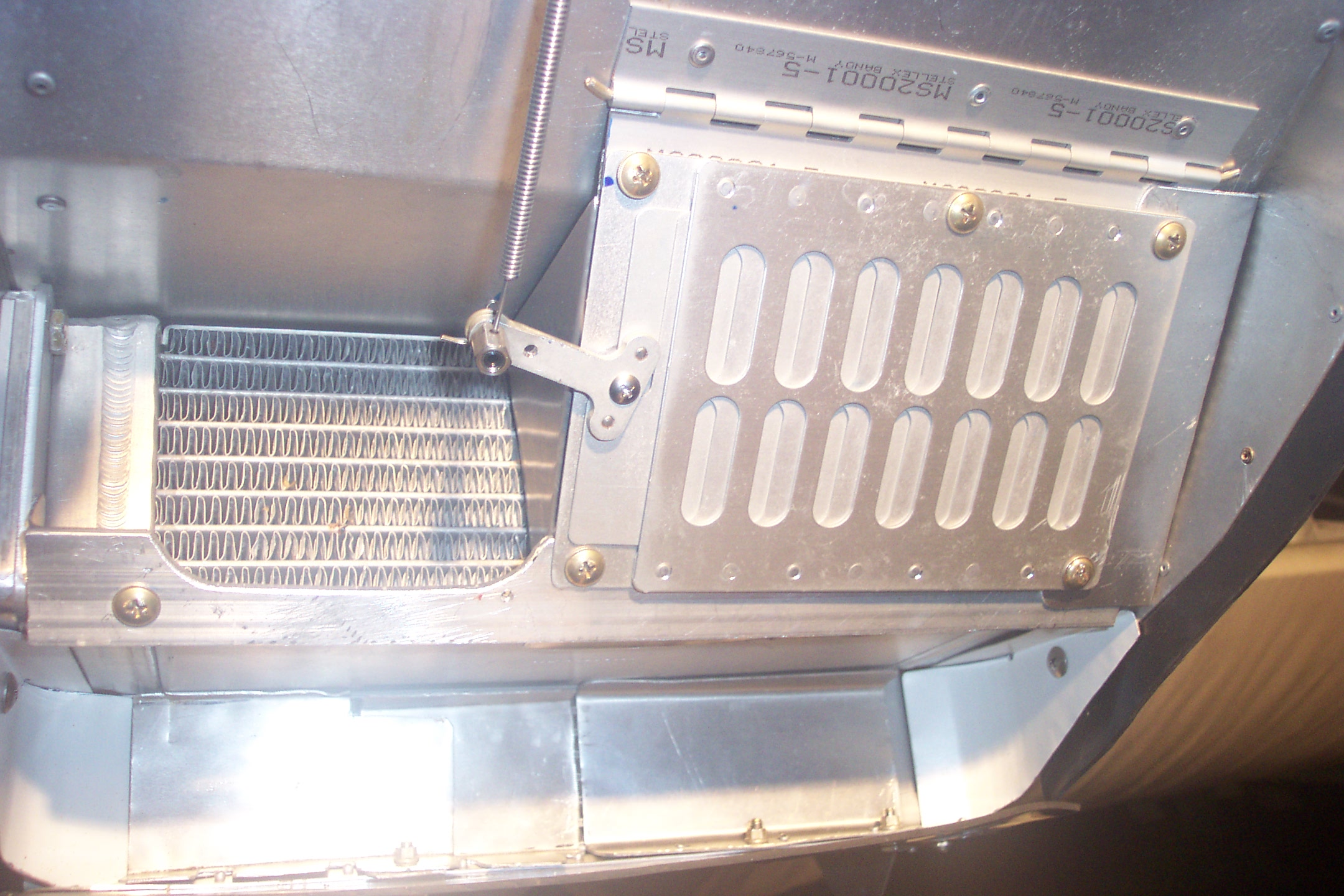

Hi Bud I send to you a drawing of my Coolers flap.
Michel AUVRAY

<?xml:namespace prefix="v" /><?xml:namespace prefix="o" /><![endif]--> Good for blocking the air bypassing, but we need a flap to actually stop the air going to or from the cooler to warm up the oil.
Bud
