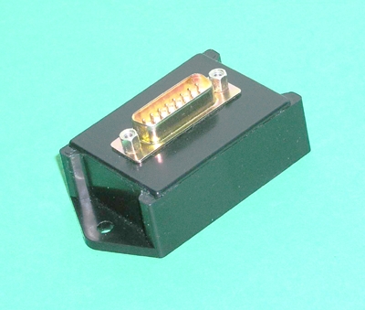

Just finished some testing of an almost-ready-for-
prime-time board assembly. Thermal performance for
the power transistors that control lamps says we
can use this board for 100w tungsten landing/taxi
lamps too.
The thing fits into our standard 15-pin enclosure
[img]cid:.0[/img]
I've got it running on the bench right now flashing
55w halogen lamps. They look pretty good in the triple-
flash mode too. So it will be up to the user. LED or
Tungsten, single or triple flash wig-wag.
I'm working on the installation documents and hope to
publish to the catalog yet today. I'll also be publishing
the software, ecb layout and bills of materials under
the open source philosophy.
The software allows control of landing/taxi lights from
a single, two-pole, progressive transfer switch.
Down = OFF
Mid = Taxi
Up (after 1 second) = Taxi + Landing
Moving directly from OFF to full up
will get you Wig Wag operations.
A jumper in the plug will choose either single
or triple-flash operation.
Down = OFF
Mid = Taxi
