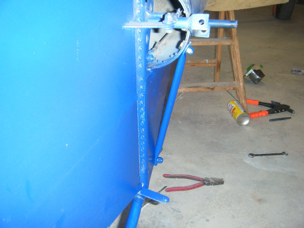

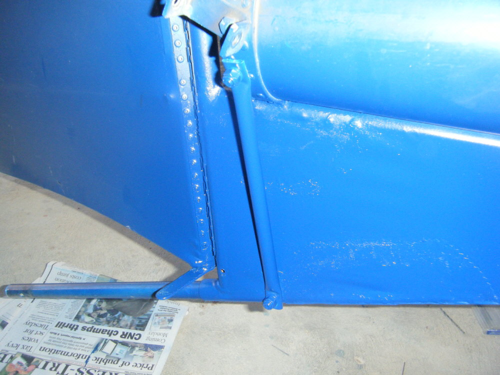

Hi Nick C/Kolbers:
Are you inquiring about tail post braces? or support for the tail wheel?
For me, bracing the tail post was a necessity, unless I wanted to continue
to make temporary fixes when it broke. It had broken 3 or 4 times over the
years.
In addition to bracing the tail post, we welded up a 4130 lower vertical
stabilizer with a 4130 saddle to attach it to the bottom of the tail boom.
Never had a problem in this department. However, I broke the lower vertical
stabilizer aluminum leading edge tube on the Factory MKIII many years ago at
Oshkosh.
Most folks think the tail wires are "tail braces". Tail wires are spacers.
They keep the horizontal stabilizer and vertical stabilizer in position
only. The only bracing on the tail post is the two welds on the rear tail
boom ring that attach it to the bottom tube socket of the upper vertical
stabilizer and the top tube socket of the lower vertical stabilizer.
The two braces from the ring to the bottom of the tail post lock the tail
post to the tail boom ring. I have flown a lot of hours since we made this
mod some years ago. No more cracked tail posts.
Let me know if I need to clarify anything.

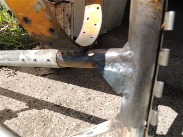

Dennis Thate
Joined: 18 Nov 2010
Posts: 362
PostPosted: Tue Dec 04, 2012 10:46 pm    Post subject: Re: Tail reinforcement... revisited Reply with quote
Rebuild the lower tail fin with a heavier steel gusset and thicker wall tubing. Which will support a full swivel locking tail wheel.

PostPosted: Wed Dec 05, 2012 6:13 am    Post subject: Tail reinforcement... revisited Reply with quote
Dennis T/Kolbers:
The above is ok for a temporary fix. Eventually, the tail post will break
again. With larger and heavier repairs on my MKIII, we continued to
experience failures until my friend Dan Horton came up with the idea of two
external struts which create triangles that laterally brace the tail post.
Looks like lateral stress from ground handling is the culprit breaking our
tail posts.
Struts can be fabricated using 4130 or aluminum strap or tubing, and
attached with 3/16 bolts. No need for welding which creates a need for
paint and fabric repair.
Has anyone had a tail post failure after installing external struts?
