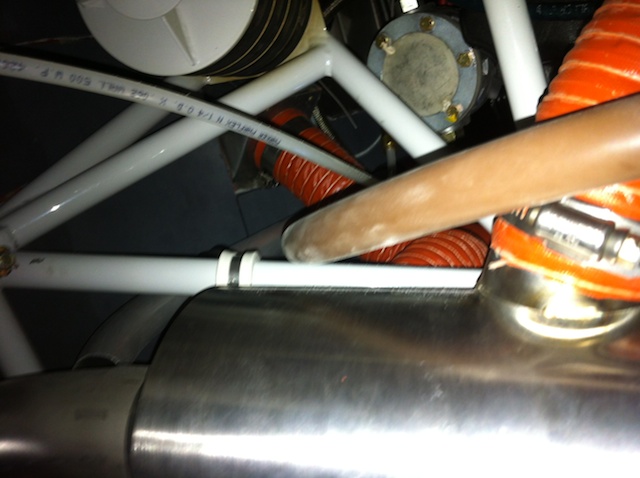

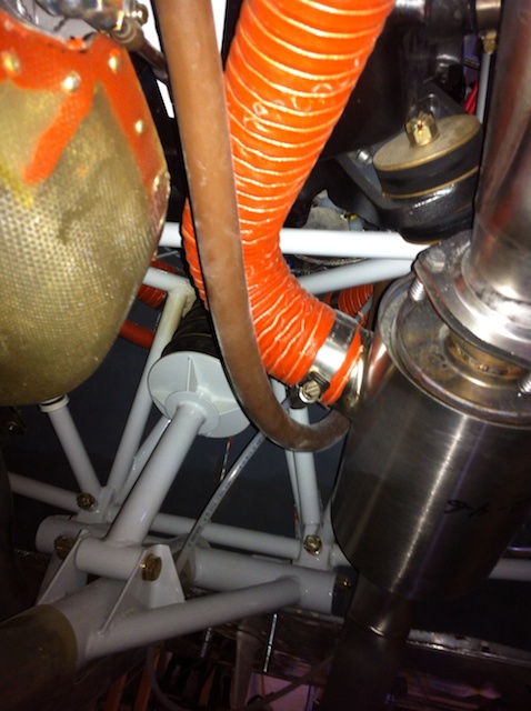

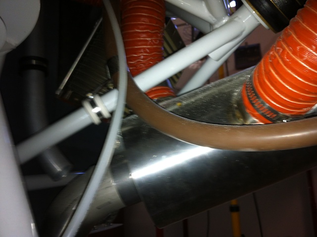

Hi there I installed the original fuel line as they came but I am wondering if the line is too close to the muffler. Feedback is welcome.
Michael

Clamp and secure it at least 1/2" away. The outside of heat muff runs much cooler than exhaust pipe plus there is alot of cooling air.
Wayne G.
