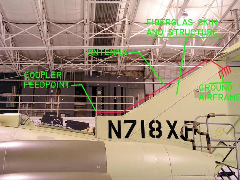

PostPosted: Wed Nov 21, 2012 11:21 am    Post subject: HF antenna issues Reply with quote
You will be trying a new approach using the driven element in one wing and the "counterpoise" in the other. Frankly this sounds like trouble, especially in a fiberglass airplane with fuel tanks in the same wing. There is little difference between something you call a counterpoise, and for instance the nav light wiring, they all return to the ground point of the antenna tuner. You will have high voltages at some points on the driven element, and lots of opportunity for discharge through the fiberglass in the vicinity of the tank. There can also be high voltage nodes on the "counterpoise" and on every other conductive part of the aircraft, because *all* parts of the aircraft will be part of the antenna. In a Navajo I worked on, we had arcing around one of the flap hinges at certain frequencies.
D.L.'s misgivings stand on 80 years experience
and experiments to optimize HF performance on
airplanes while minimizing deleterious effects
to systems on board. A contemporary example presented
to your's truly about 8 years ago where an HF transceiver
installed on a Hawker 800 presented mysterious, inconsistent,
wildly variable problems that ranged from interference with
fuel level readings to total shutdown of all engine driven
power sources (including APU) while transmitting.
[img]cid:.0[/img]
The problem was 'mysterious' because this same configuration
of transmitter and receiver had been installed years gone
by with a tiny fraction of the problems.
The difference was a new antenna concept that abandoned
the older low current, high voltage wire antennas. Owners
begrudgingly tolerated those ugly wires so as to enjoy over-water
H.F. performance on their airplanes.
Needless to say, ALL were willing to pay killobux to have
an antenna integrated into the aircraft's structure. This
called for insulating the leading edge structure of the
vertical fin, grounding it to structure at the top and
exciting it with a very agile antenna tuner at the bottom.
Then the problems started. Bottom line was that aircraft
structure coated with primer and assembled with rivets
was never designed to be part of an antenna ground system.
Airplane to airplane variations produced an constellation
of effects that seldom repeated. Radiation levels in the
hell-hole were often high (200+ volts per meter) and
varied widely in terms of position within the hell-hole
and the excitation frequency.

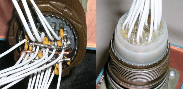

I got to spend a week in the delivery center just before
xmas 2005 trying to keep the generators on-line on three
airplanes otherwise slated for delivery (before end of
year).
Discovered that legacy generator controllers were never
qualified to work in this new interference environment that
had not existed before the antenna change.
Managed to craft "special connectors"
[img]cid:.1[/img]
From RadioShack capacitors and Walmart epoxy that kept
huge levels of hell-hole RF from getting into the generator
controllers.
Didn't fix the original problem (which was never going to
be fixed) but it did get those airplanes flown away before
Dec 31.
I mention this to illustrate what appears to be an arcane
sifting of cause/effect to deduce the effective band-aid.
You won't know what the problems are until you test and
a really elegant solution may be unattainable.
