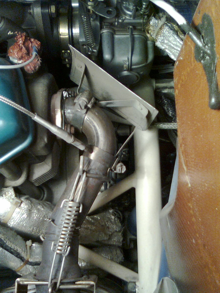

I also have the GRT EIS 4000 (I am very pleased with its performance), 912ULS and XS firewall-forward kit from Europa. Please see the attached photo for where the aft EGT probes are mounted – no double side flange on the exhaust tubes, though, as far as I can see on the photo.

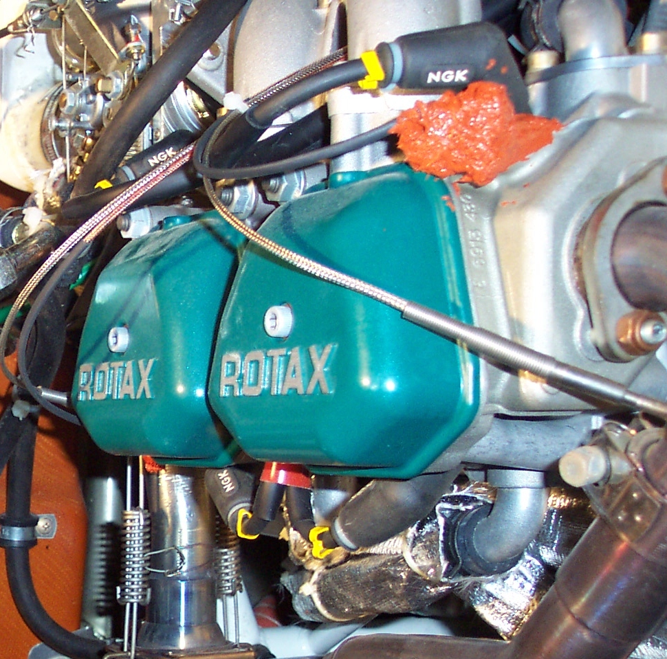

My EIS set came with 4 ring terminals, of equal size. They are thermocouples to be pressed against the cylinder head metal, under a bolt to be screwed into the threaded holes provided for the standard Rotax CHT probes. The standard probes measures the temperatures inside the CH cavity, while the ring thermocouple will be exposed to cylinder cooling air. Therefore, you must cover the thermocouples and the adjacent CH metal well with a suitable compound (I used the red high-temp silicone from Loctite). There is a noticeable difference in measured temperature with and without this insulation against air cooling (I did not have it at first). See attached photo.
I have not fitted any probes between cooling fins.
