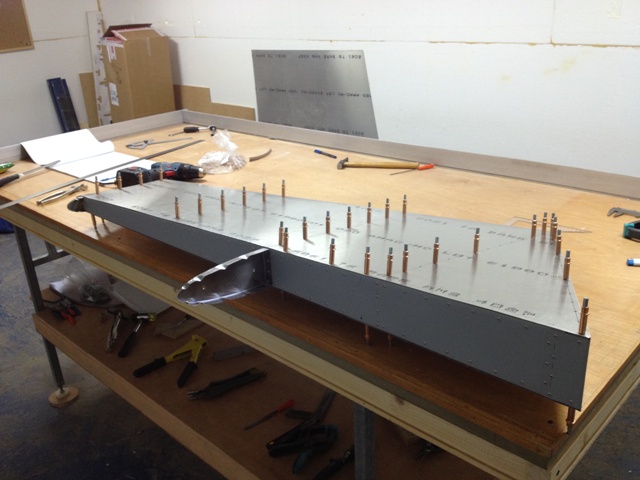

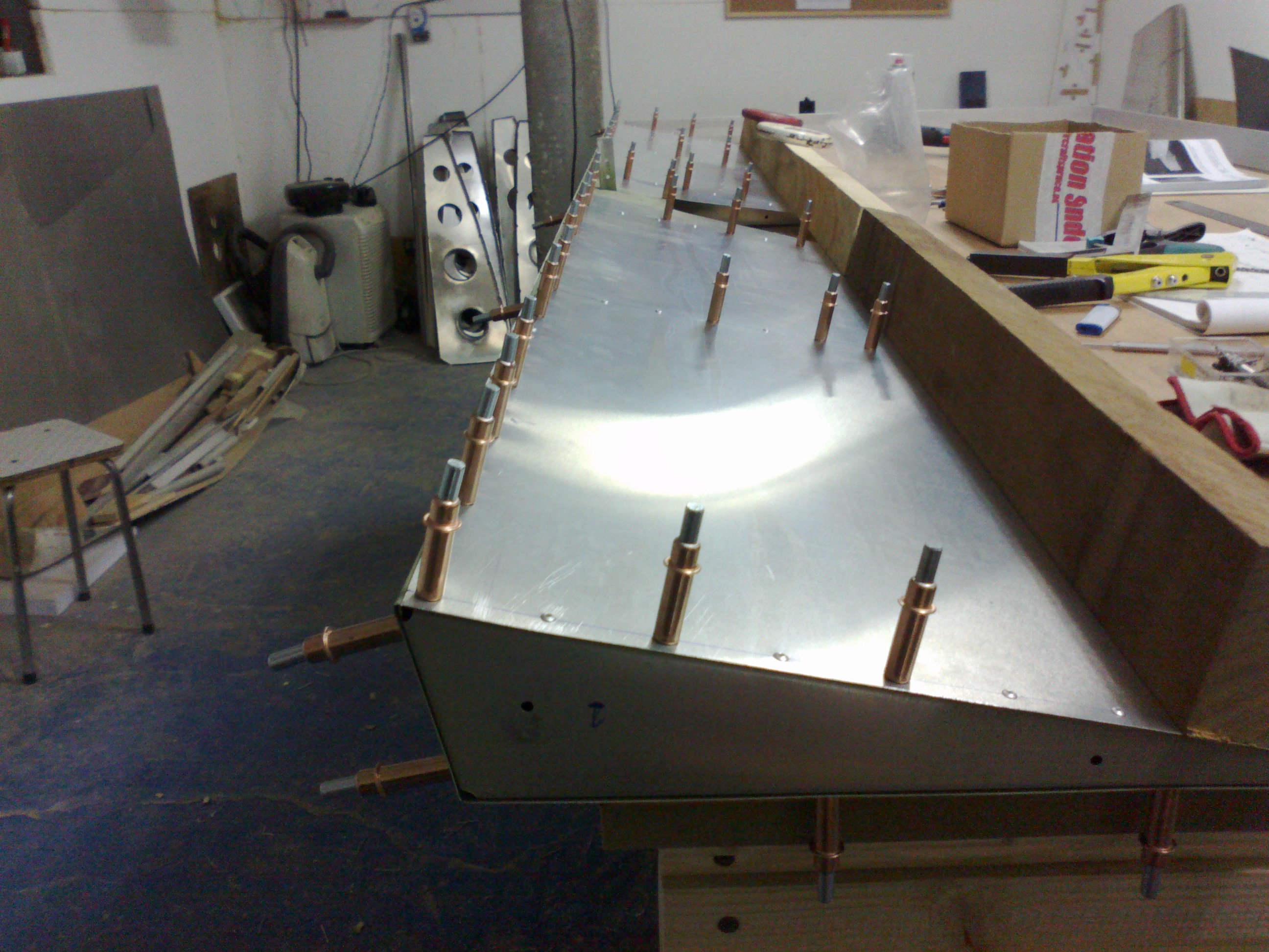

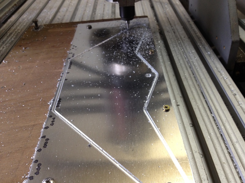

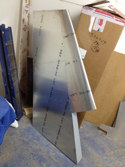

PostPosted: Fri Nov 16, 2012 12:22 pm    Post subject: CH601HD flaps Reply with quote
Many thanks to all of you for your help.
I´m clear now, NO FLAPS..... Right now I fisnished the vertical tail and elevator, all the ribs done and planning to begin with the spars.
It sounds great the speeds you mentioned and enought for me and what I use to fly.
