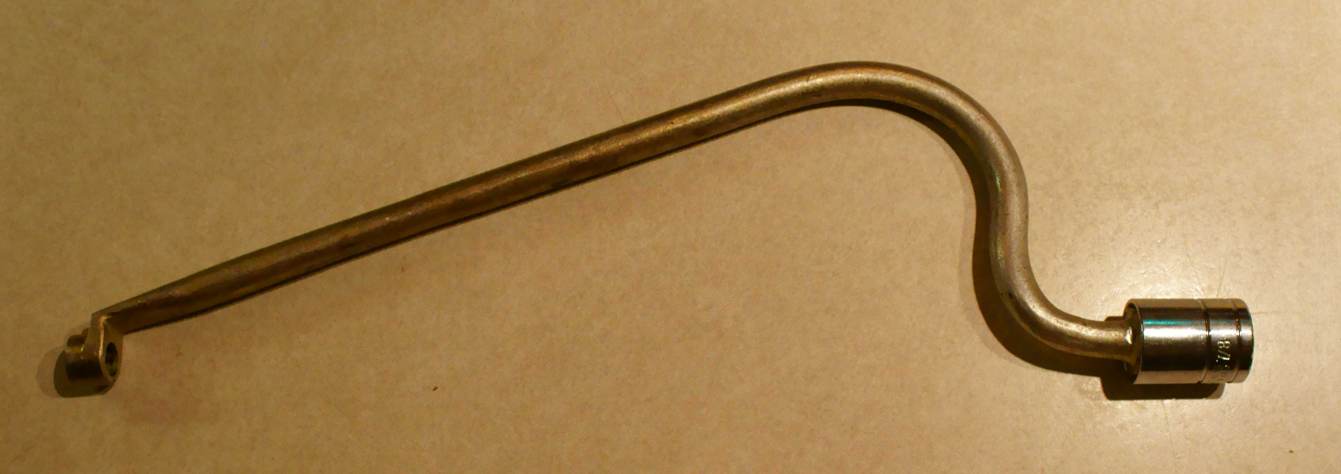

PostPosted: Sun Nov 25, 2012 7:09 am    Post subject: Cylinder base wrench Reply with quote
Hi Steve,
if you have a bench grinder you could do the job
in a few minutes. Just grind the top end of the
cyl. base wrench into the shape of a 7/8" hex nut
and slide the matching 6-point socket on, please see
attached picture. Now you can use your torque
wrench, extension, ratchet, etc. Smile
You can use this technique also to modify some of
the other engine tools as well.
Hope that helps.
cheers
Elmar

Mozam
Joined: 24 Nov 2006
Posts: 85
PostPosted: Mon Nov 26, 2012 5:47 am    Post subject: Re: Cylinder base wrench Reply with quote
Elmar, great idea!
Doug, are the Chinese wrenches you carry the same as the Russian ones with a T-handle at the end to "hand-tighten" the nuts?
Steve
