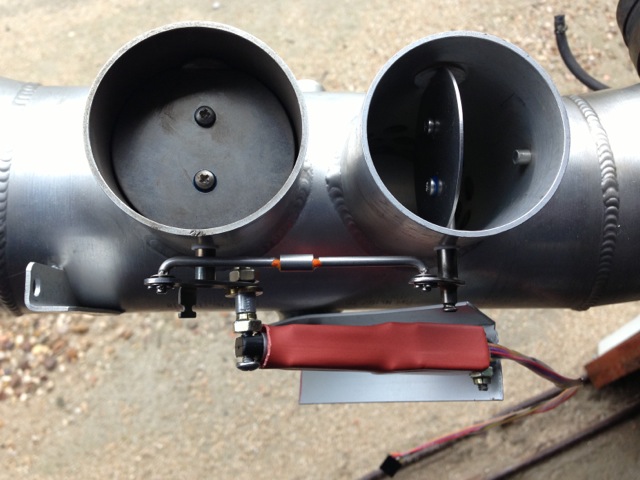

Looks very nice. Can you share more details/how the servo is programmed? No air box on my Kitfox but thinking of installing one.

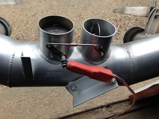

I am new to the list. Would like to share with you my implementation of TWC's servo on a Rotax Airbox for my 912. Please find attached a couple of pics, and a link for a small video.
http://youtu.be/KwuVpV9ycjo
The servo has been programmed not to fully open, as in my experience, only a little hot air is enough to rise the intake temp. a good few degrees.
Comments and feedback welcome!

PostPosted: Tue Nov 13, 2012 12:15 am    Post subject: Airbox with servo Reply with quote
All details here.
http://www.tcwtech.com/control_valve_servo_kit.htm
Sorry for the typo, I meant TCW, not TWC.
Best regards, LP.

PostPosted: Tue Nov 13, 2012 4:27 am    Post subject: Airbox with servo Reply with quote
Luis:
That is some SWEET welding.
