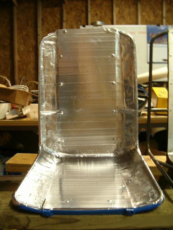

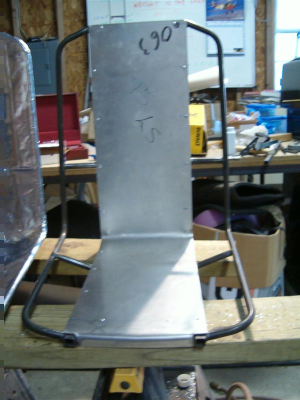

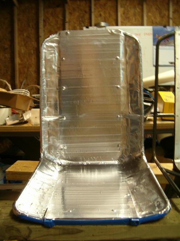

Here are a few pictures of some seats that I am working on. Again it this is the result of a few other peoples ideas.
Wanted to make some new seats that are:
1) Crashworthy - if I had sling seats back in 04, may not be walking yet!
2) lighter than old ones that were crashworthy.
3) they have to fit.
4) a little more comfortable.
Could not find anything that fit the criteria, so decided to make my own.
The pictures are a little out of focus. Sorry, I'm not Big Lar ( That is a compliment, Larry). But you get the idea if your interested. I did resize them!
Seats are made of 4130 Chrome tubing with .063" aluminum pan. The second picure is taped up with one layer of blue painters tape and then a layer of aluminum duct tape. This gives it the form for fiberglassing.
Next step is to fiberglass them with a freinds help (Bruce W.).
This will lift for access and will be removeable (ala John/Jim Hauck)

John B:
I like your seats, especially the sheet aluminum pan. May save your
butt some day.
