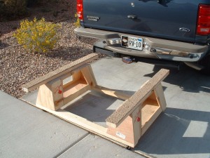

PostPosted: Mon Jun 05, 2006 11:56 am    Post subject: Re: QB fuselage stand Reply with quote
Here is a pic of the stand I believe Deems was referring to.
Kevin

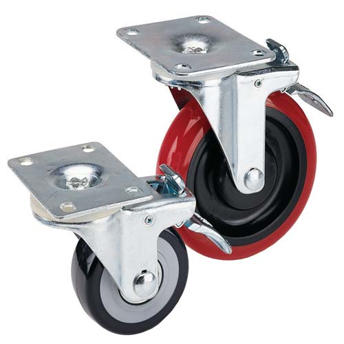

Try these wheels for your fuse cart. Get them at wood working stores, such
as Rockler.
John J

PostPosted: Mon Jun 05, 2006 1:00 pm    Post subject: QB fuselage stand Reply with quote
 Oooo, Rockler.  Love the place even though it is waaaay overpriced on most things.  Save yourself some $$ and get your wheels from Harbor Freight or Northern Tool.  Worse case Lowe's-Depot.

PostPosted: Mon Jun 05, 2006 1:24 pm    Post subject: QB fuselage stand Reply with quote
Actually, you're right.  I saw the same wheels at HD, but forgot.  Didn't know HF had them.  Nice catch.
