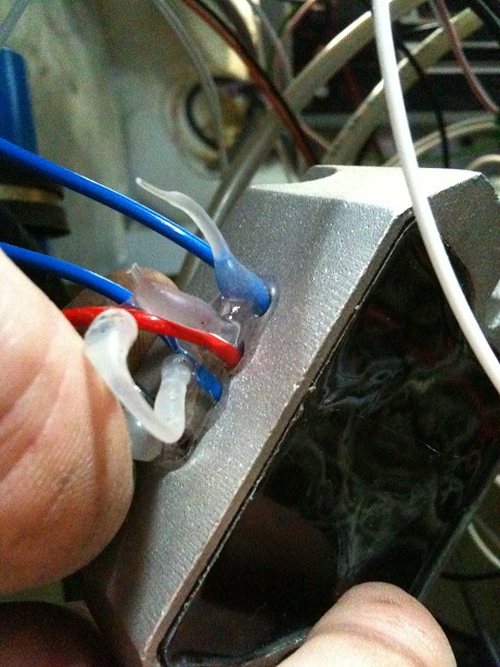

A family member has recently installed an SD-8 alternator with the 14V regulator and OV protection module as per instructions. The total runtime of the engine with the alternator is about 15 hours.

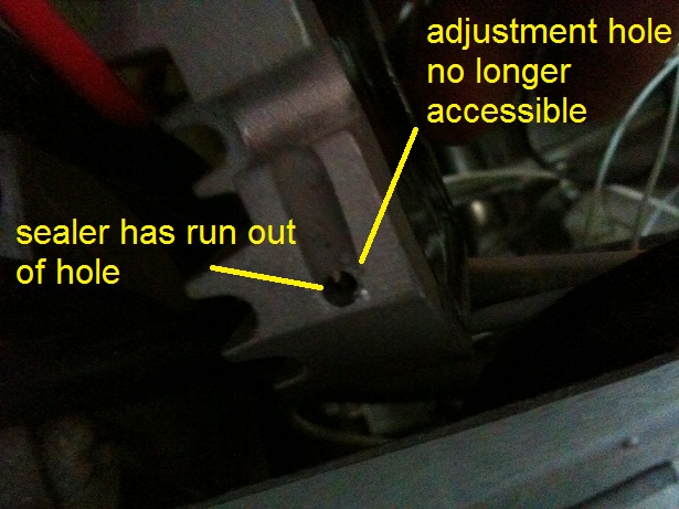

It has started spewing potting compound out of the gaps around the wires and keeps tripping the CB OV circuit. The potting compound has also blocked the voltage set point adjustment hole.
Any ideas for fault tracing the wiring (so that the same doesn't happen to a replacement), or does this look like an internal manufacturing fault?
Etienne

PostPosted: Fri Nov 09, 2012 9:30 am    Post subject: PMR1-14V problem Reply with quote
Something is wrong inside. Get with B&C and see if
they'd like to exchange it for a new one. They may
be interested and willing to do a failure analysis.
In any instance they need to be aware of the event.
