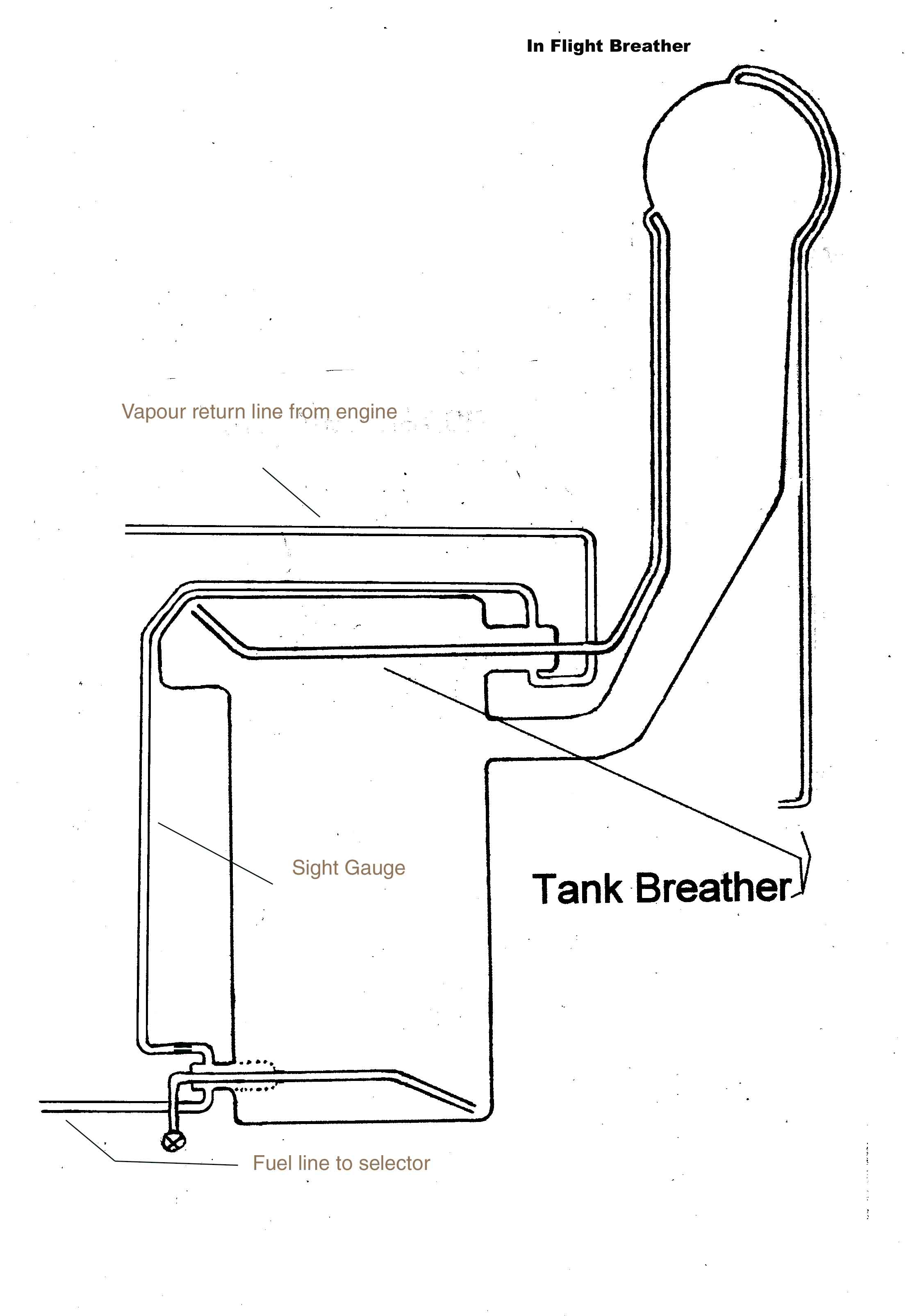

All,
We have a fuel selector valve in fuel line. We try to remember to close it before a possible emergency landing. Some pilots close it always when not flying and some people close it only during a long storage time.
There is also a fuel return line. That is connected to the tank bottom (starboard side /reserve side) if built as per a BM (issue 6, page 6-3).
I have two guestions:
1) would it be wise to have a 2nd fuel valve in a fuel return line also to get an ability to close it or one-way-valve in the case of emergency?
2) why this line is connected to the fuel outlet which locates in the bottom of the tank? Why not to the upper corner of the (reserve side) tank?

PostPosted: Thu Apr 26, 2012 10:46 am    Post subject: Fuel Return Line Reply with quote
Raimo
the top of the tank is the right place for the return line, as you suggested. That way hot fuel gets mixed with the whole tank content instead of being drawn straight back to the tank.

PostPosted: Thu Apr 26, 2012 3:26 pm    Post subject: Fuel Return Line Reply with quote
I have a one-way valve in the return line for exactly this reason.
This fuel might be quite warm. Imagine when your tank is half empty. The
hot fuel will have to make a free fall before it reaches the pool of
fuel, and it will probably evaporate before it even gets there. No big
deal as the tank will vent it away, but you might find that your fuel
consumption is a tad high. It is better that the return fuel immediately
enters the cold fuel in the tank, so even when some fuel has already
evaporated and produced bubbles, it will condensate back into useful
fuel when it contacts the cold fuel. So the bottom of the tank is the
correct position, and so it is depicted in the build manual anyway.
So, I have noticed no problems to use my engine with return line which
is off-line. There are also many Rotax aplications with no plans for
return lines in use. What is a main reason we should have a fuel return
line? To get more fresh cool fuel or what?
I can't say this for the 912, but for the 914 it is to avoid vapor lock,
so yes, to get cold fuel all the time and to avoid keeping it longer
than necessarily in the hot engine compartment.
Frans

PostPosted: Fri Apr 27, 2012 1:21 am    Post subject: Fuel Return Line Reply with quote
On 04/27/2012 04:53 AM, klinefelter.kevin(at)gmail.com wrote:
If the return fuel enters the top of the tank (under a little pressure) and expands while falling to the level of fuel in the tank,
Fuel is not compressible.
However boiling temperature decreases with lower pressure. So if the
fuel is hot, the free fall will promote evaporation of the fuel due to
the sudden drop of pressure.
So, the only way to release hot fuel properly is to release it below the
fuel level.
This also does away with any need for a second fuel valve and it's weight and complexity in an emergency.
Well, a one-way-valve is a low weight and low complexity solution. Fuel
can only flow into the tank but never out of it.
Even when you have the fuel return in the top of the tank, I would still
advise a one-way valve. Fuel fumes also burn excepionally well, and of
course it is always possible that you end up inverted.
I recall the story of one Europa-flyer (I believe it was PH-ZZZ ) who
had an emergency and ended up unharmed but inverted. The doors where of
course blocked, and fuel started dripping on the trapped pilot. Luckily
a fire was not started and he was rescued in time.
So for this reason I don't want any port in the tank where fuel can
escape. This includes the sight gauge. I have consequently scrapped the
sight gauge.
Frans

The LAA was averse to the idea of discharging the fuel return to the bottom of the tank on the basis that, if fuel lines firewall-forward were ruptured in an accident or engine fire, then there would be the possibility of fuel siphoning from the tank via the fuel return line, This makes sense, although mitigation of that possibility could be to place the vent line restrictor behind the firewall. Or arrange for the addition of a non-return valve at the same location.
Duncan McF.

PostPosted: Thu Nov 01, 2012 11:45 am    Post subject: Re: Fuel Return Line Reply with quote
While trying to understand our recent 914 power problems, we talked to Rob Seaton at Rotech.
He suggested we measure how much pressure is required to return the fuel to the tank (from regulator). Remove return hose from top of regulator, plug one side of banjo fitting and blow into other (don’t ingest fuel!). it should be very easy (max is 1.5 PSI pressure loss with both pumps on: 914 installation manual sec 14.3)
We found with the fuel tank full the pressure required was more than we could easily blow. With the tank half empty not much pressure was required. Our system is per Europa with the return at the bottom of the tank. Calculations show the pressure of the column of fuel in a full tank (15 inches of fuel) is about .4 psi which is certainly less than 1.5 psi.
The Europa setup has worked OK for over 400 hours, but perhaps it would be better to return the fuel to the top of the tank. Opinions?

PostPosted: Thu Nov 01, 2012 5:33 pm    Post subject: Fuel Return Line Reply with quote
Jim
I have always put the fuel return into the top of the tank, (I used a redesigned tank fitting that incorporated the breather connection (3/8 aluminum)
fuel return and sight gauge return connection. Much less back pressure at the top of the tank and the (maybe hot from the engine driven pump)
then mixes with the main bulk of the tank contents before going baCK TO THE ENGINE. sorry kaps lok again!
Jim & Heather

PostPosted: Fri Nov 02, 2012 2:30 am    Post subject: Fuel Return Line Reply with quote
Jim,
I have my 914 fuel return set up as Graham describes, and no problems. I have never checked the return line pressure.
What problem are you experiencing?
Kevin
On Nov 1, 2012, at 8:32 PM, GRAHAM SINGLETON <grahamsingleton(at)btinternet.com (grahamsingleton(at)btinternet.com)> wrote:
Jim

PostPosted: Sun Nov 04, 2012 8:32 am    Post subject: Fuel Return Line Reply with quote
<?xml:namespace prefix="v" /><?xml:namespace prefix="o" /><![endif]--> Jim,
Never had a problem with return pressure as rigged. The Rotax manual says it is supposed to be a minimum of back pressure as you indicated. If you restrict the return pressure, you actually overpressurize the fuel system. Those with gauges that read raw fuel pressure can test this easily, by just clamping the return line just slightly with the engine off and not the rapid rise in pressure.
You are very wise to note that the column pressure is only about 1/2 psi. in the full tank. I cannot blow more than 1.5 PSI when checking against my fuel direct reading manual gauge. Check for kinks and plugged vents also.
Off until Friday.
Hope you find out what the matter is. It must be something simple, as it is hard to find.
Bud Yerly
