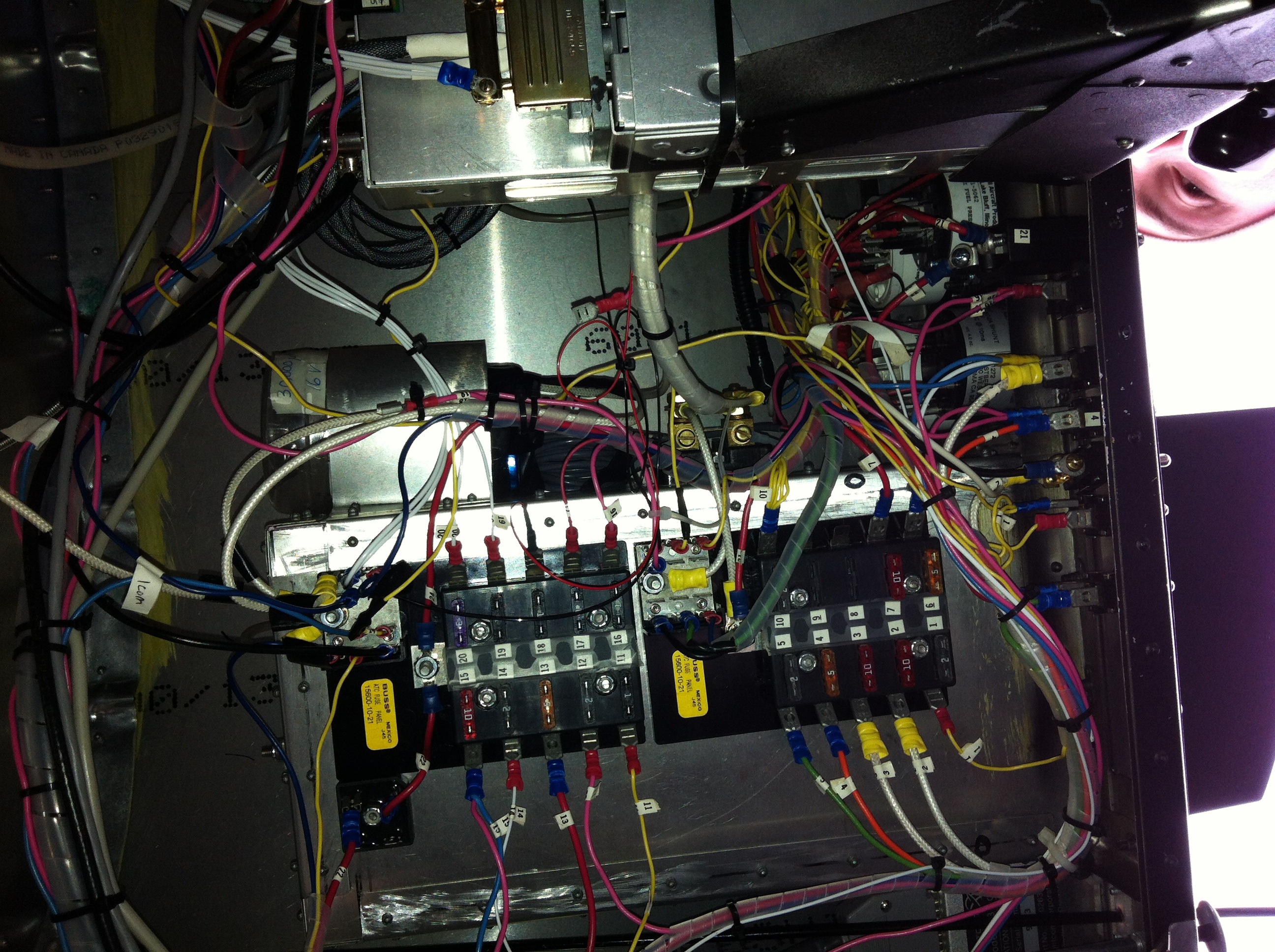

Here are a few "birds nest" photos.
Chad

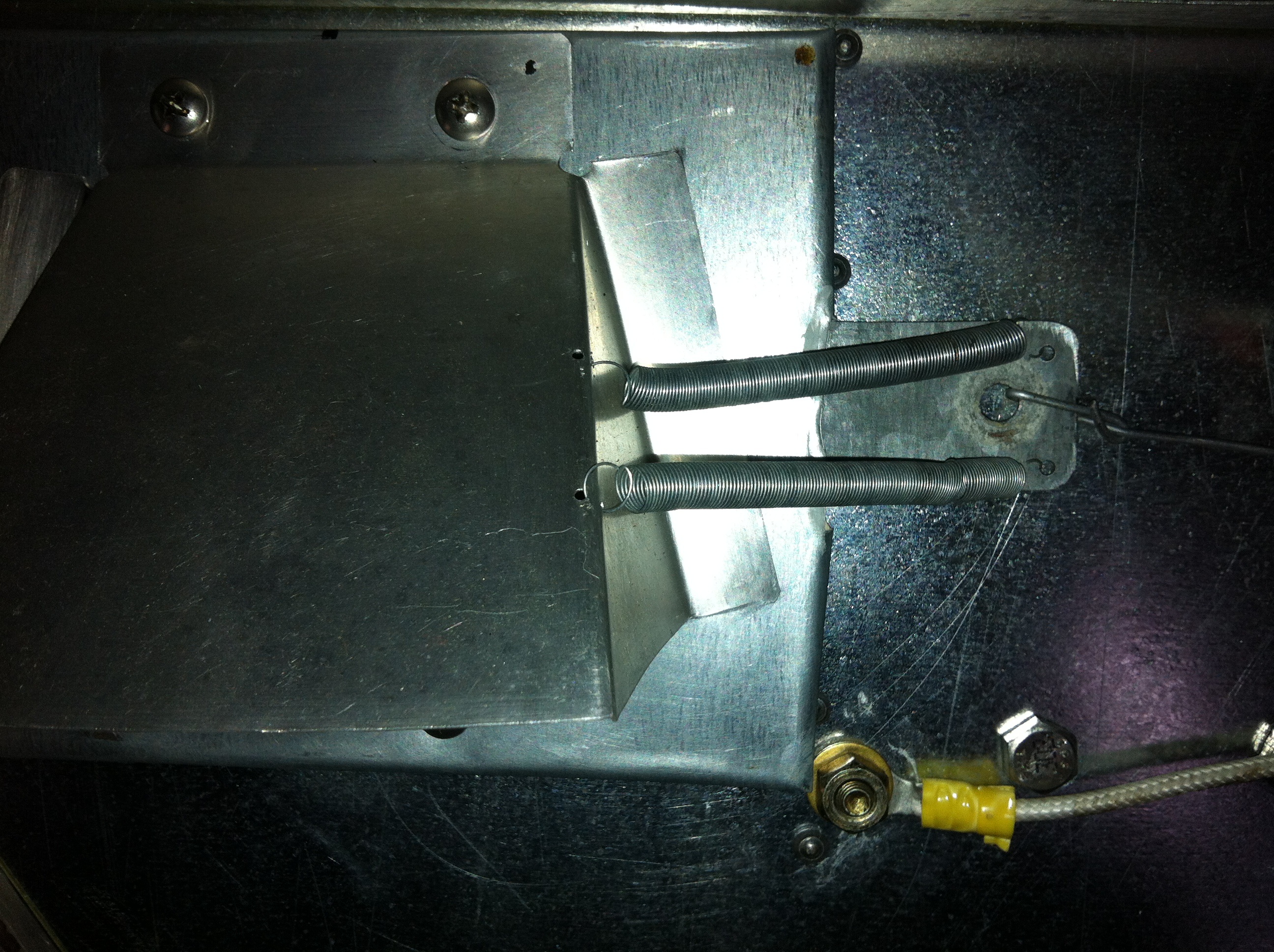

PostPosted: Thu Nov 08, 2012 7:13 am    Post subject: Re: Radio/Comm issue! Grounding airplane from flying... HELP Reply with quote
So, after studying the images I've got, it appears not overly complex. My assumptions are that the braided wires are shielded and the grouping of wires onto those metal blocks are the grounds compiled together. ??
In the image below, it shows a ground of some sort directly to the firewall. Not sure where it goes. Almost impossible to see under dash.
Chad
