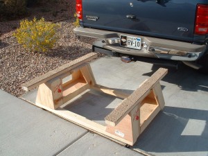

Here is a pic of the stand I believe Deems was referring to.
Kevin

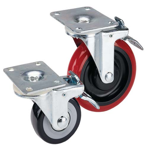

Try these wheels for your fuse cart. Get them at wood working stores, such
as Rockler.
John J

Oooo, Rockler. Love the place even though it is waaaay overpriced on most things. Save yourself some $$ and get your wheels from Harbor Freight or Northern Tool. Worse case Lowe's-Depot.

Actually, you're right. I saw the same wheels at HD, but forgot. Didn't know HF had them. Nice catch.
