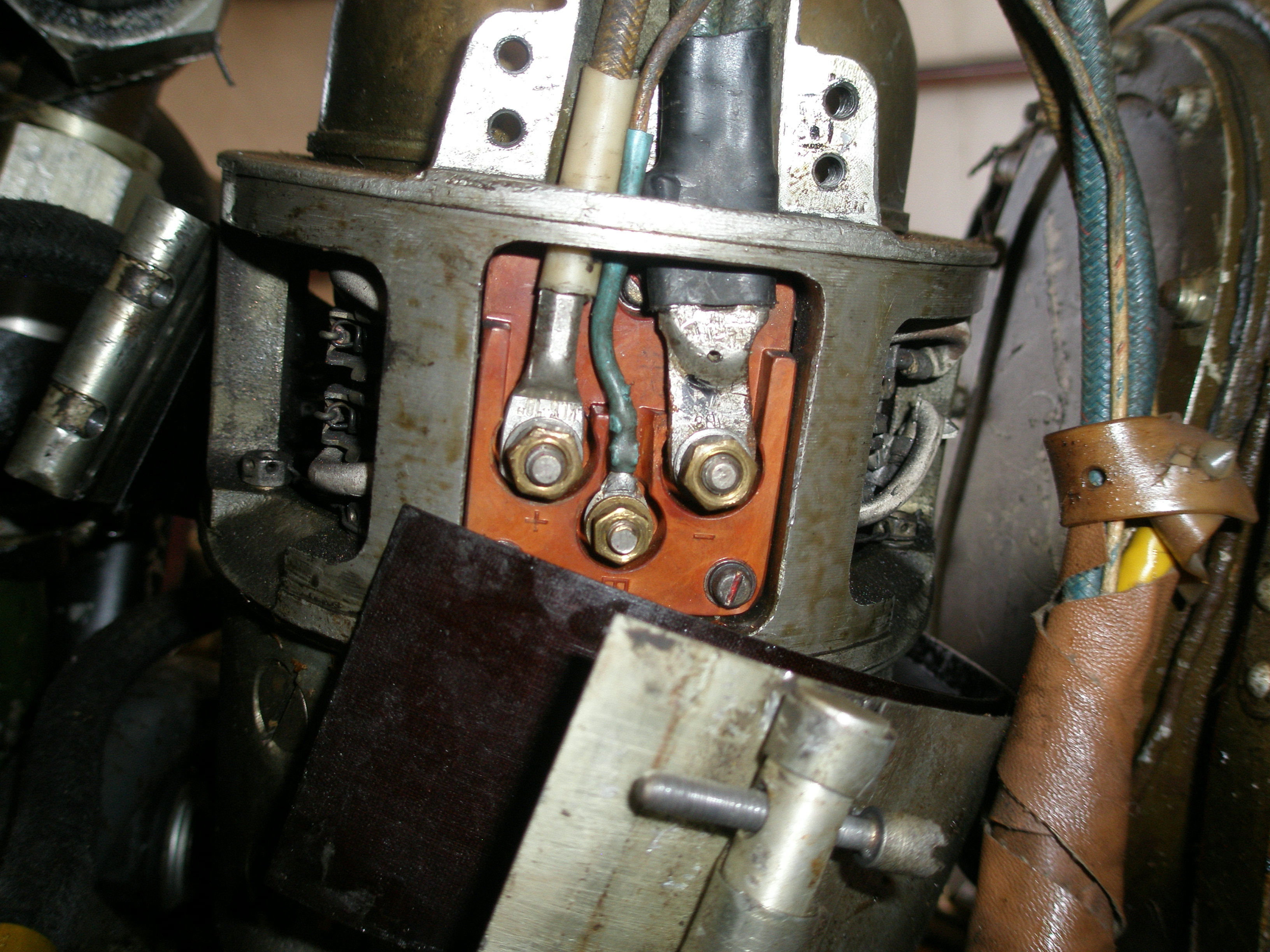

I need info on the correct hookup of the generator on a CJ6. There are 3 wires on the left side of the generator. One large labeled +, one large labeled - and one smaller wire. I believe that the smaller wire is the field wire which I believe goes in the middle. Which of the remaining connections is the armature (positive) and common (negative). The drawings are confusing. Physically It appears that the + wire goes forward and the - wire goes aft with the remaining smaller field wire going in the middle. What is the correct order foreward to aft of these 3 wires. The wiring diagrams are confusing.

The field wire is in the center. From memory, I believe you are correct on the other two. I will try to remember to confirm that for you tomorrow.

To Walter Lannon, Does that mean the +(positive) wire goes forward and the -(negative) wire goes aft. Please don't confuse me any more than I am Ha!!

Sorry, did not intend to confuse you. You wrote “Physically it appears that the + wire goes forward and the – wire goes aft ---------- “. The “lay” of old wiring is usually a good indication of the correct position – but not a guarantee. Best to confirm.
I did that today. Pos. is fwd. (LH), Neg. is Aft (RH) and the field is center. Actually the generator is marked for pos. & neg. but may be a little confusing since both LH & RH terminals are marked +. The neg. is marked on a removable plate which can be reversed if the generator is driven in the opposite direction.

Walt, Thanks a lot I saw the - marking on the aft plate but thought it was maybe a number 1 but wasn't sure. Think I finally got it through my thick head. Ha!!

Okay for some reason the YAK list server keeps scrubbing the message I sent with picture of the YAK generator wiring hook up. So here goes again??? If Mat lets it through this time with out scrubbing it!
